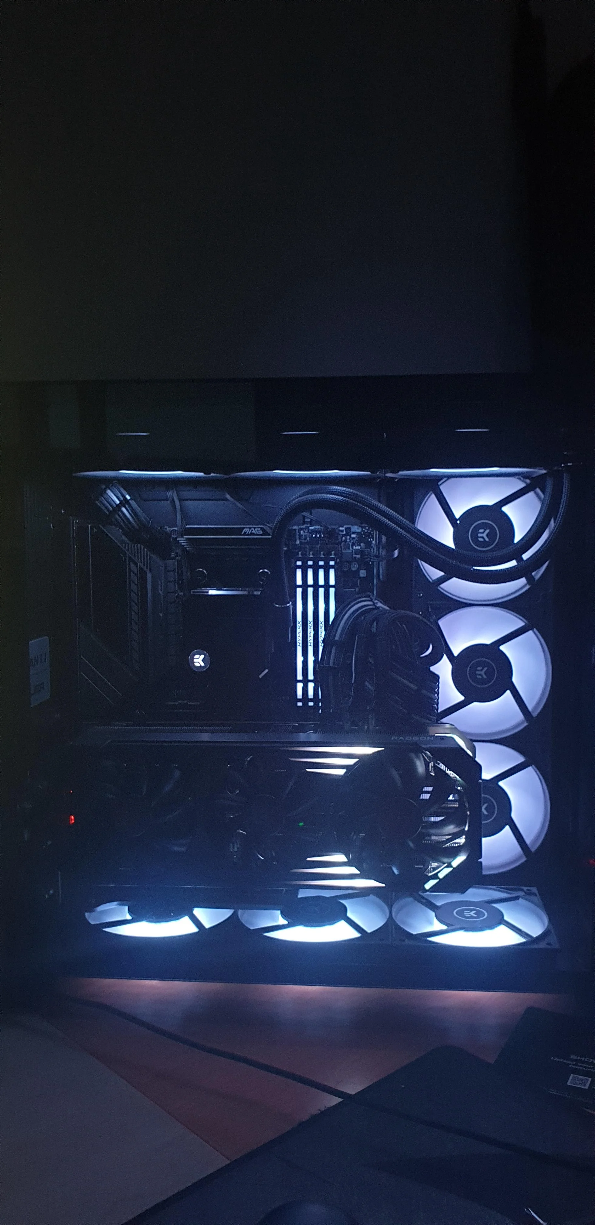

Congrats, pic for the OP please.
Curious to know if you have the XTX or XTXH version and what your default core clock is in Radeon Software > GPU Tuning?
Here is a pic, its a bit messy but it works:
Had to use some old 8pin pcie extensions as the rm1000 cables are so stiff i could not get the side on:(
