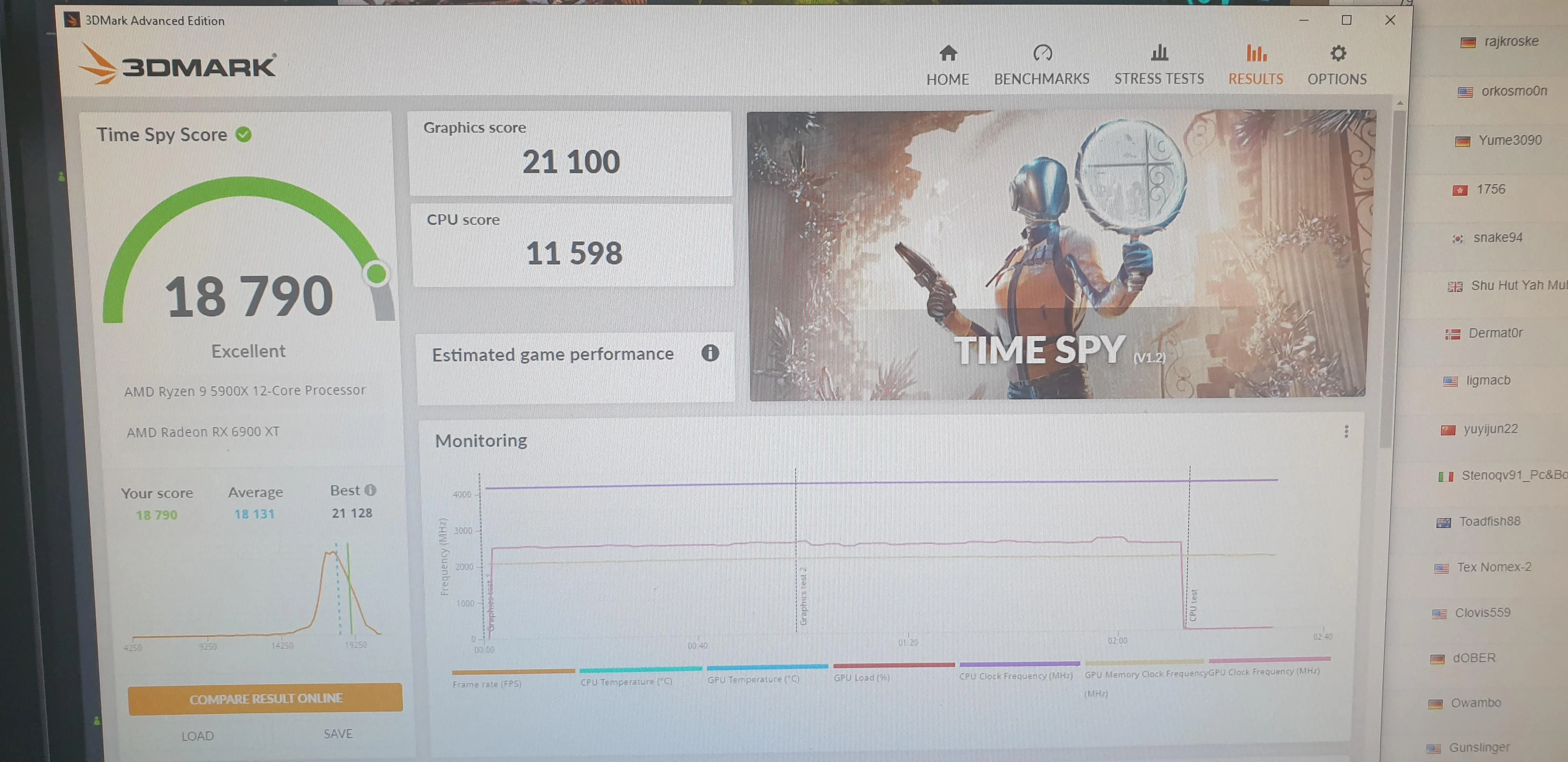

Just got myself a new high score in time spy
jCrWTdF
jCrWTdF

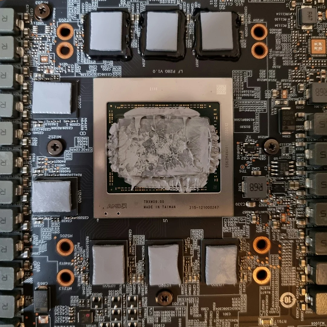

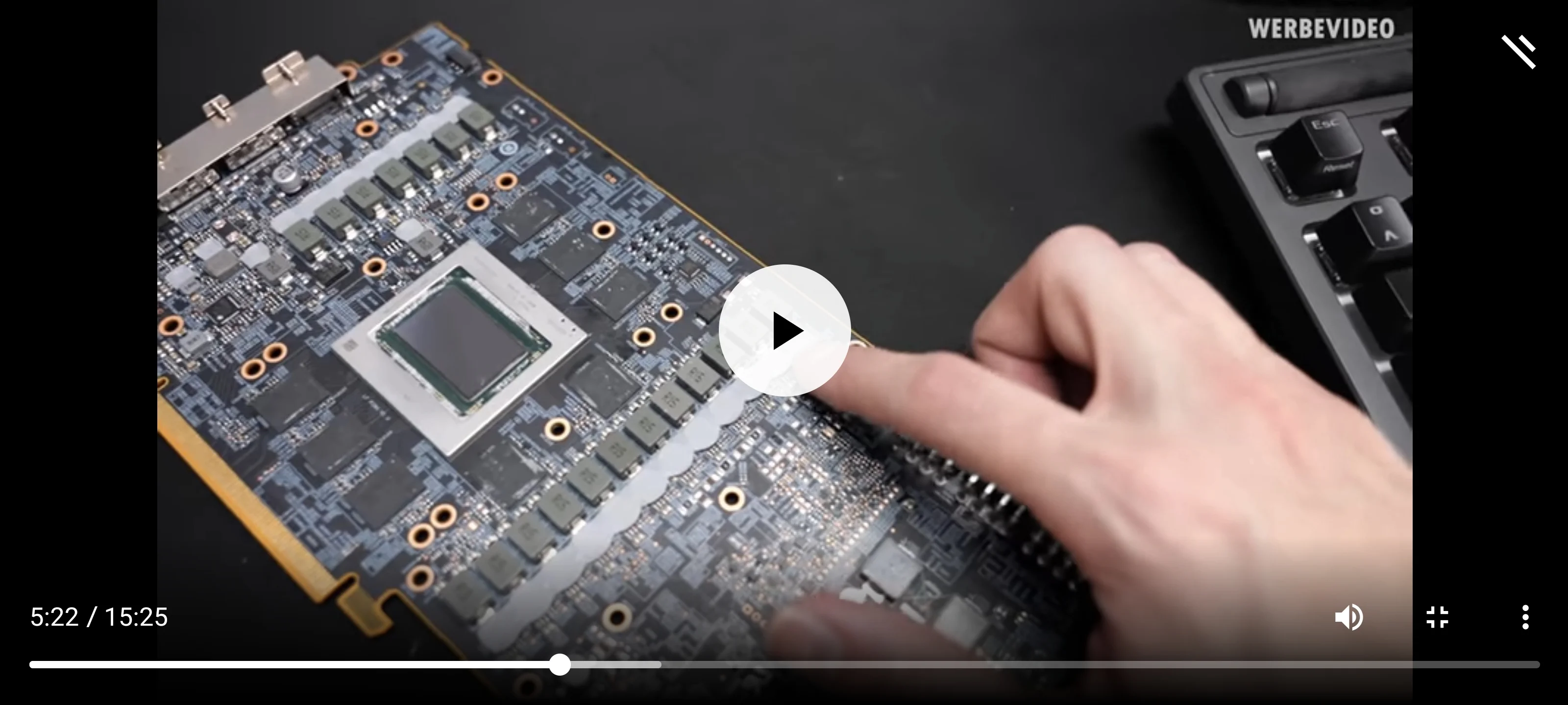

No can't say I have. Have you managed to find any other pics of the same XTXH model PCB?
It does look like glue or something.
Is it working okay? If so I'd not worry about it.
The closest I can find is the following.
Doesn't appear to be any adhesive around any the the chips.
It has been running fine, will just see how I get on.
Just thought it was unusual.
I've seen some boards have silicone on various components to combat coil whine (not just coils but caps and fets as well) but not on mem chips and it's odd it's just on the three.

Recently got a PowerColor rx 6900 xt red devil Ultimate (XTXH). Pretty pleased with it and more importantly the OC I got out of it!
Max stable OC for games of ~2750, 2690 being stable for time spy benches. Running at 1160mv core and 2150 memory. Seeing sustained speeds over 2600 at all times which is nice.
