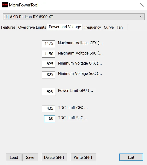

For undervolt just click Delete SPPT in MPT and restart, then undervolt in Radeon Software.
Start out at 2479 max frequency and 2379 min frequency. Set voltage to 1100mv, and reduce in 10mv increments until you hit stability in extended testing. I got my sample down to 1040mv before i started getting stability issues.
Seen others get around 1075mv+, so your mileage will vary.
