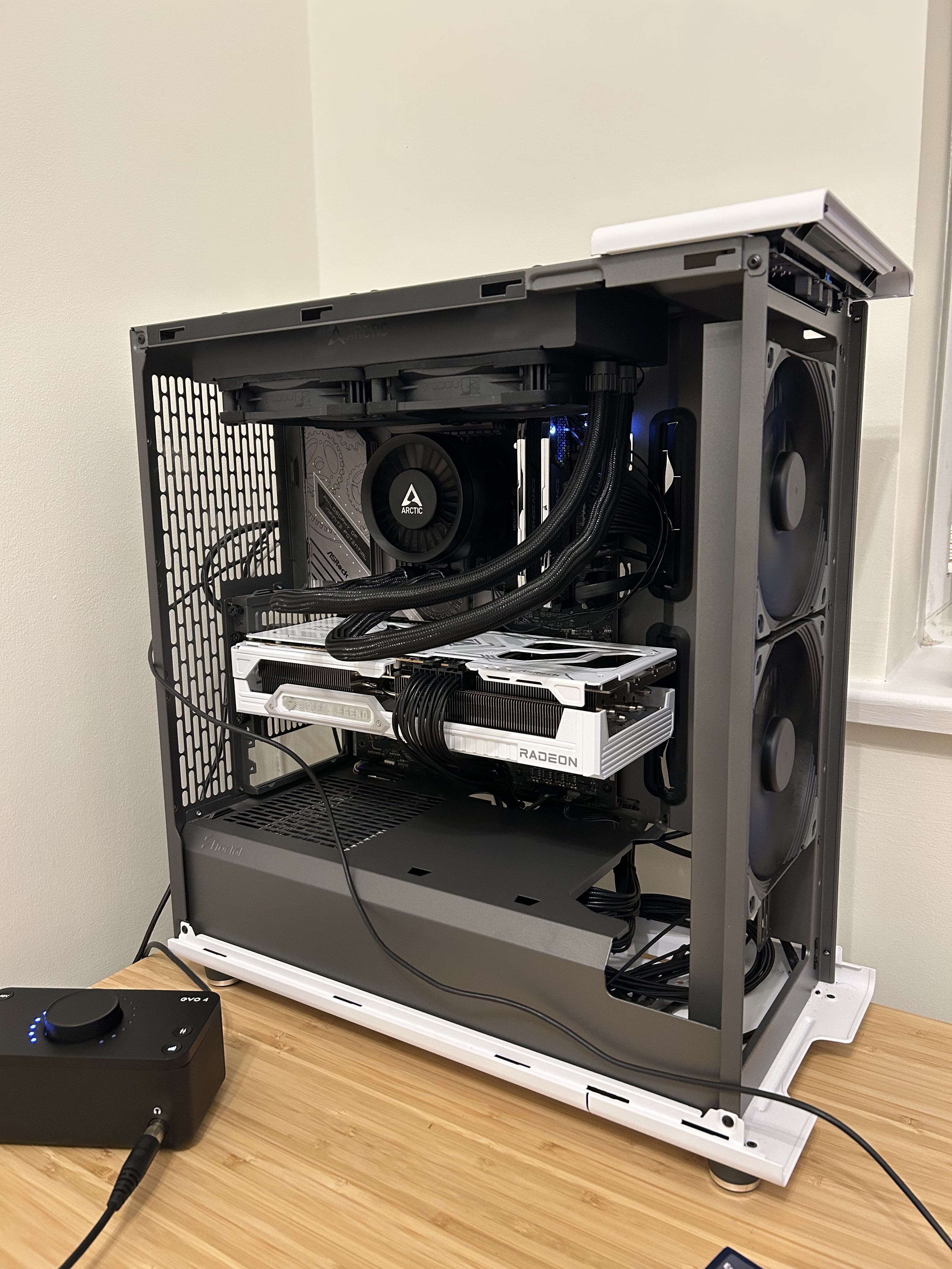

Put it in the regular RDNA4 rumour thread but have just installed the 9070XT Steel Legend into my current build I'm putting together.
Wonder how many other people are going to be rocking a 265k and 9070XT... A few final touches to put to the build, tidying up cables and installing the rear exhaust then sorting fan curves with FanControl!
ohhhhh shiinny I just wish there were a couple more flakes of white inside like the pump or fans?
