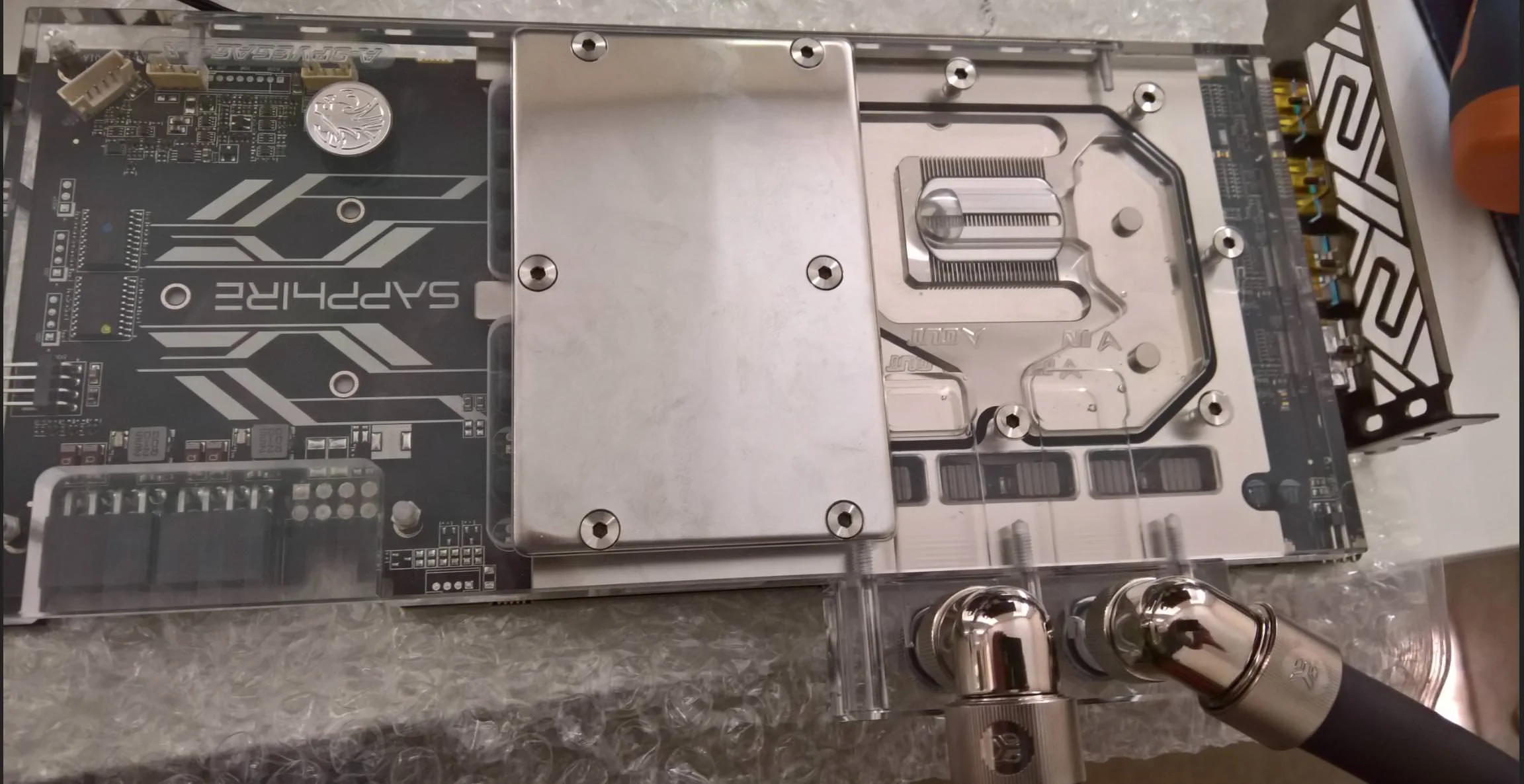

Installed properly the waterblock today.
While benching the temps does not exceed 45C even heavily overclocked at 50% fan speed the Predator 360. Same applies to HBM ram sitting 45C max also.
My only temp that cannot get is the hotspot sensor. It escalates to 106C, however the is nothing around the card that is warm. Neither the backplate. Some help welcome
FYI on Air the temps were hitting 70C for GPU and 80s for HBM.
Side effects. Because of low temps the card is hitting power limits before temps. It tries to push the GPU to 1800 where before at same settings was operating at 1727. Consequently it hits power limit somewhere and stops.
My low voltage settings went out of the window also. At previous 900mv the power consumption now is 100W higher, as is the speed.
I will drop all way down to 800mv later this week and experiment.
Using the default "power save" mode, the performance is higher than before (~15%) as same power envelop (176W).
As i will continue experimenting will update.

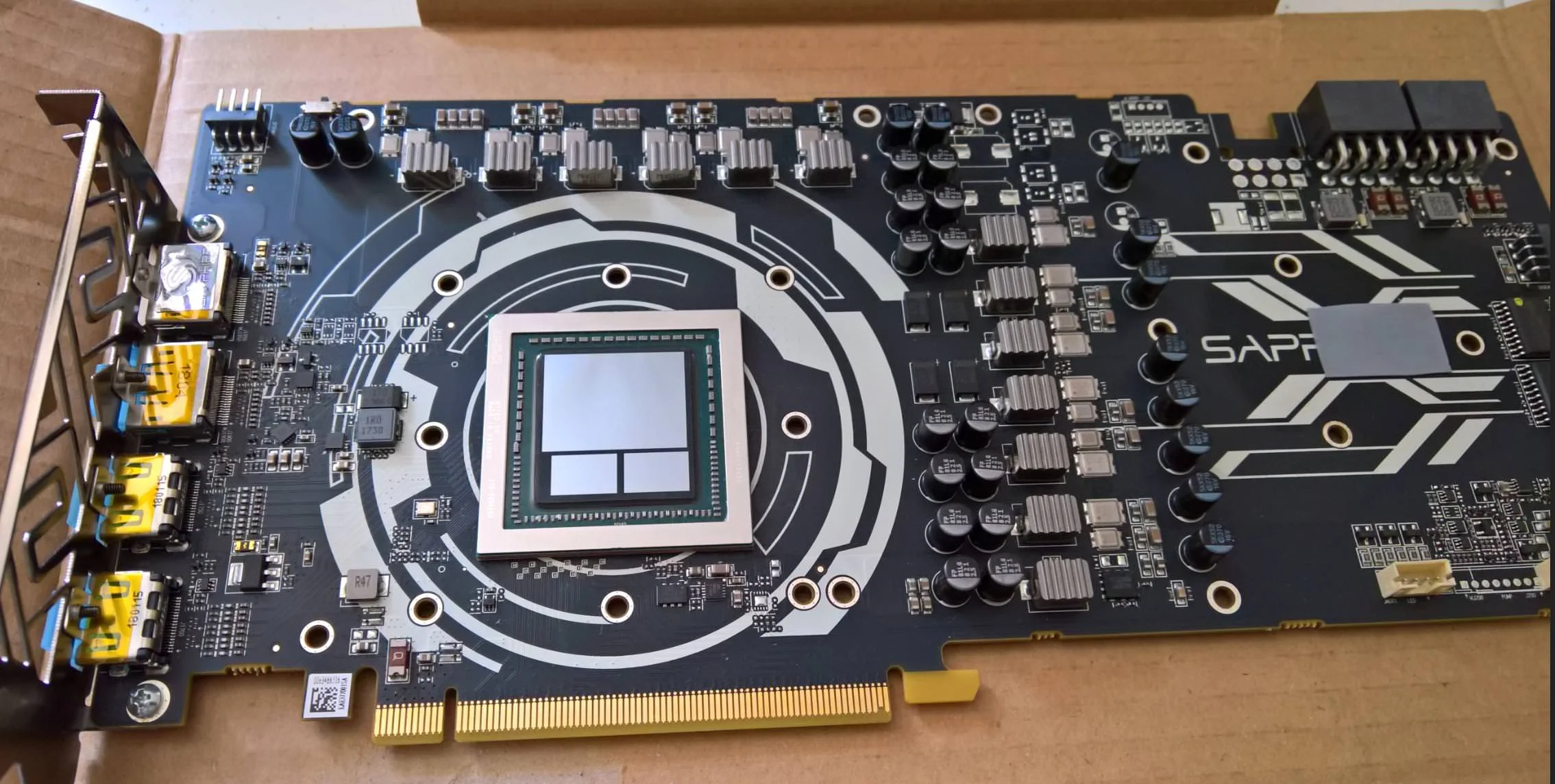

Some pictures from the Nitro+ when installed the Bykski waterblock. Used Thermal Grizzly Pad 8 (1.5mm) 1 strip of 100mm is enough and Thermal Grizzly Conductonaut.
You got lucky. Molded die. :)

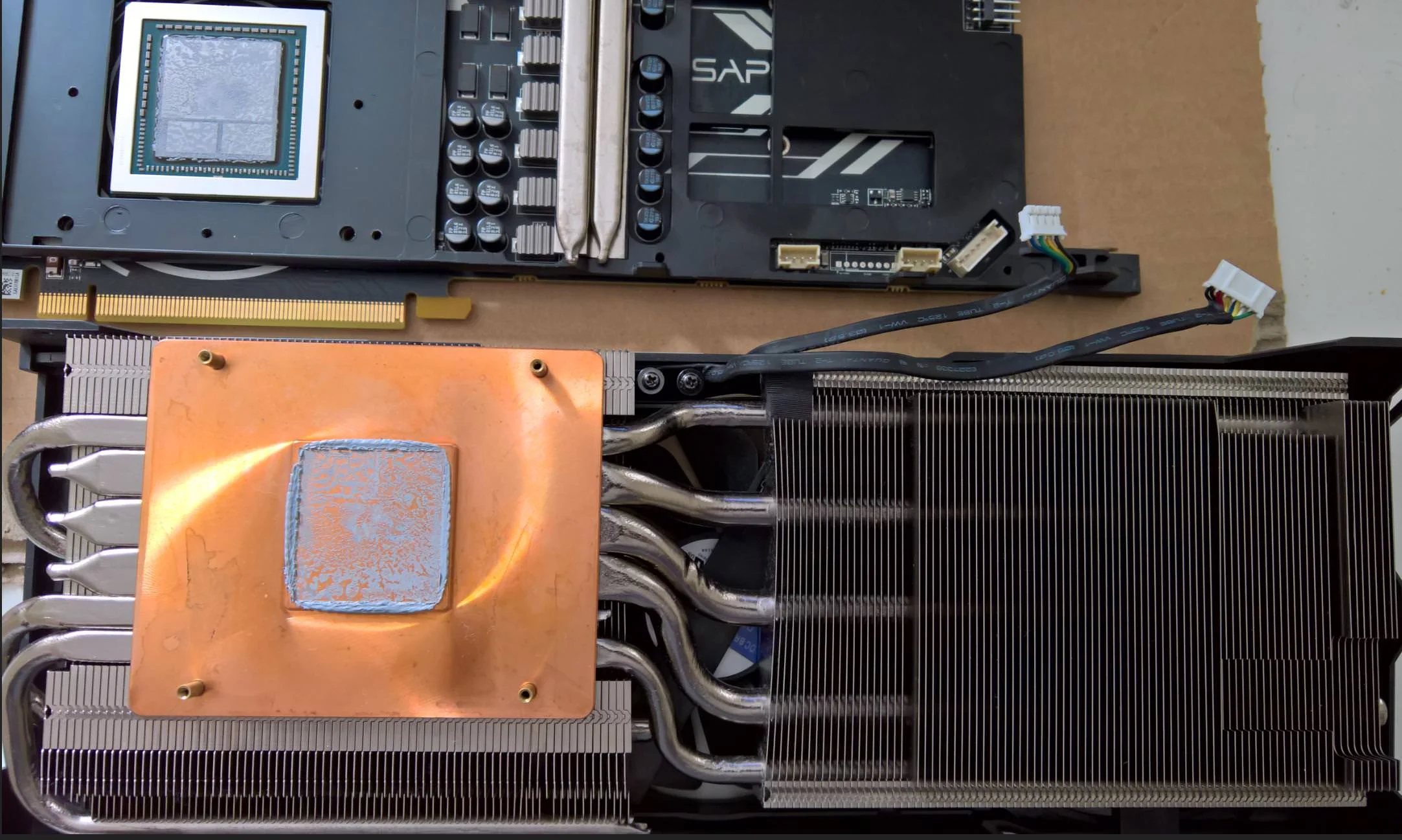

Initially I was afraid that this was the case, because my HBM temps were +15/+20 of what the core with the stock cooler.
However that's not the case by re-applying liquid metal. Both stock cooler and watercooler, the temps are +1/+3C higher than the core only.
Also today tamed the hotspot temps. Which normally should be +20 over the GPU temp, but it was +50/+60 over the GPU with the block.
I used the X wrench (or what ever is called) Nitro provides, and used the long screws the waterblock supplied, with the springs removed from the short screws.
That really put a lot of pressure to the cooler to sit better and had to re-arrange the limited long screws also to around VRM area leaving half the holes empty.
Temps are even better now, with the hotspot not going over +10 over the GPU, and somehow coil whine gone completely.
Which I always knew is one of the screws that is too tight over the some electric chip.
Since the method of loosening the screws near the 8-pin connectors area, always was the way I resolved the coil whine on all my previous cards.
Btw I am jealous of your X399, but I will have to wait until later in the year for CPU upgrade.
Btw does anyone knows what kind of screws are the long ones in the picture bellow? Because I had to use 4 at the X crosspiece, I am 9 short :P
