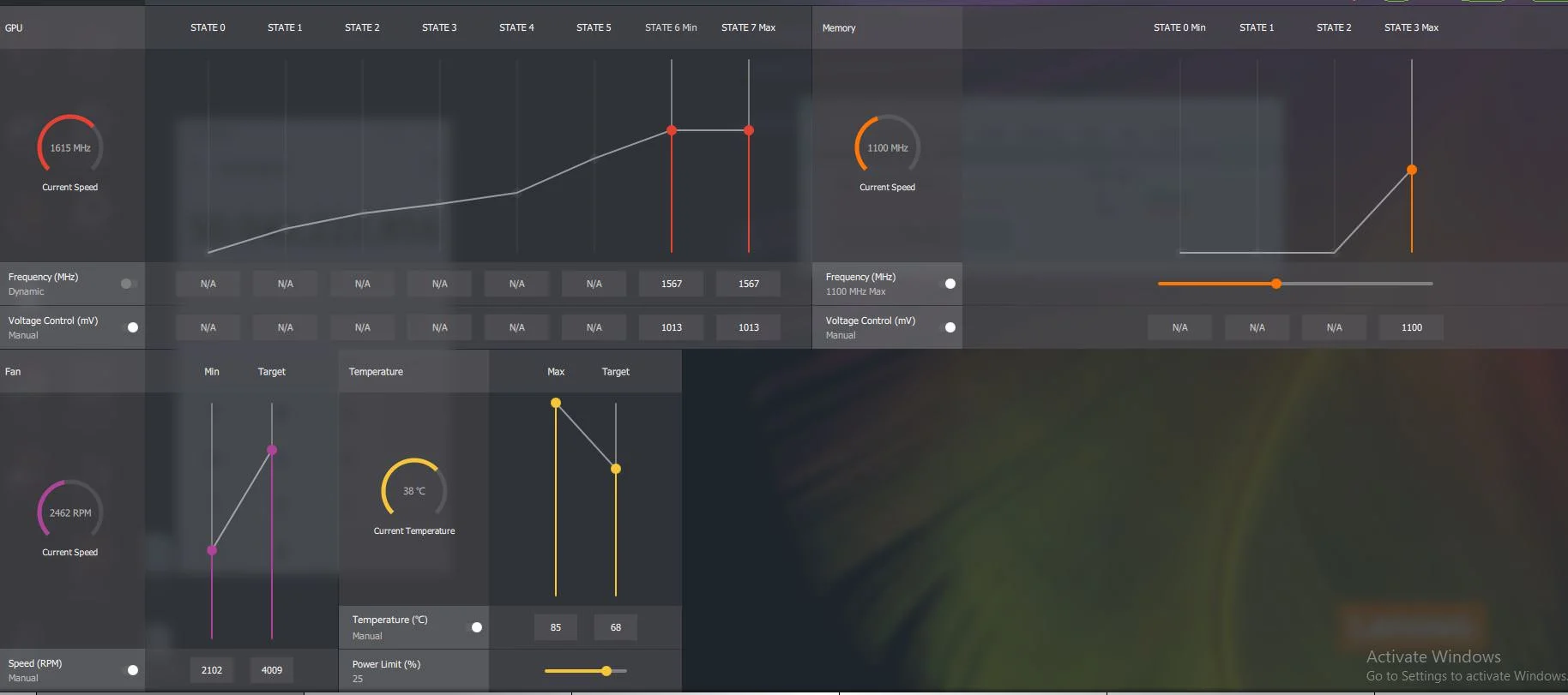

That's basically what I do to get 1550 stable but I have to also do the voltage reduction and decrease from 1632 down to 1580. Without the under volt my clock speeds fluctuate all over the place but at 1000mv it's solid as hell and overall performs much better at the same clocks and no undervolt.
Why you do not try -20% Power limit and 1650 speed? Leave 1200mv and clock the HBM to 1100.
I haven't tried that. Would -20 be enough to get it to 1650? During my tests I seemed to start needing even more juice way before 1600.
Also remember the standard card only has 2*8 pins not 3 could be my issue.
My Nitro+ is 2 8-pin also.
Imho with Vega 64 you can overclock on so many different ways. Is not like NVidia cards raise power and crank up speed until it crashes :P
Can you show me a screenshot of your 1550mhz profile please? (the full wattman page)
Imho with Vega 64 you can overclock on so many different ways. Is not like NVidia cards raise power and crank up speed until it crashes :p
Sure
Raise power limit to 50+
It also used to crash with default settings and +50% so I knew there was no change at overclocking past default but after I upgraded motherboard bios it works at +50% standard clocks. Might give 1600+ another try but it definitely will need more voltage.
You have a great setting there. You just need to tweak it. Also it would be crashing if you keep P6 state at same voltage with P7.
It has to be lower.
Later tonight I will try to play with my Nitro+ and see at what point I can get 1600 at the lowest power available at 30% fan speed (watercooled) to give you an indication where to look at :)
