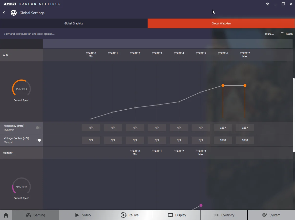

run unigine heaven or some other 3d load, adjust voltage until something breaks; when it breaks go back a step.
heres me searching for the voltage for state 6: aso42s0.png
I just had a quick play with the new drivers on my vega 64 blower. Colour me impressed with the under volting!
so far ive set state 6 to 1000, state 7 to 1050, power limit to 30%, mem frequency to 1050. Nothing else changed.
It's gone from throttling at 85c and dropping down to 1536mhz to................... rock stable lines through heaven, time spy extreme... Heaven only got it upto 76c max. Timespy 70c, zero throttling as its well under the 85c temp limit.

so far ive set state 6 to 1000, state 7 to 1050, power limit to 30%, mem frequency to 1050. Nothing else changed..
would be interested if that is stable my card isnt happy undervolting state 7 so far...!
edit yep i'm getting nowhere on stock clocks at 50% power limit which is strange....
certainly seems like it needs every last mv of the 1.2v to get the 1600+ clocks!

my card seems fine at 1537Mhz/1000mv at 1100HBM (stock voltage not sure if thats just mem controller like polaris or what)
pretty close to full power 1630Mhz on firestrike: http://www.3dmark.com/fs/13423936
the core voltage required for higher clocks seems to be ridiculous...
