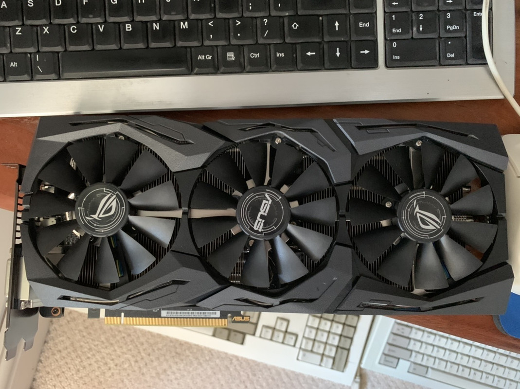

Late to the party, but have just done my first pc upgrade for about 15 years :D
My bro gave me a hand-me-down i5-3570k at 4.3ghz, 16gb 1600 ram, and I’ve managed to get an Asus Strix Vega64 for a bargain price!

Just be aware of the VRMs on that card, asus did a botched job on the cooler job with that model from reading around. Otherwise if everything is fine and dandy, big congrats :) I hope it will serve you well.
My vega 64 strix even with the replacement vrm pad barely hits 1400mhz, and seems to like crashing the entire system as well.
I've got 1725MHz fully stable @ 1200mv - 1150VRAM Memory @ 1100mv on a Sapphire Nitro64 with a +50 Limit. Pulls around 310Watts :D Will try a little under-volting to get the Watts under control.
I think I picked a good card in the Sapphire, I saw a lot of vids and the Strix wouldn't even boost past a the reference card.
Seems like i figured out why my Vega was crashing, when i put on the new VRM pad i accidentally left the plastic on the side contacting the vrm's :o
Taken off now and seems to be running much better, can't believe i done that. :o:o
