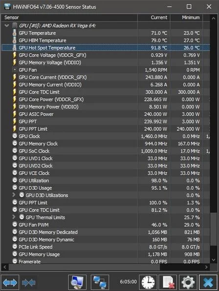

Check the temps in hwinfo64 for GPU, hotspot and VRM1 and VRM2.
If they are all in check (VRM 1/2 < 70C, Hotspot < 90C, GPU <80C), then the card is probably dying (HBM most likely).

Well, I installed HWINFO64 and set the logging on.
I ran furmark gpu stress test with ran several times yesterday for quite a long time without issues and it black screened a few seconds later.
I have partial results from logging and these is a lot.
