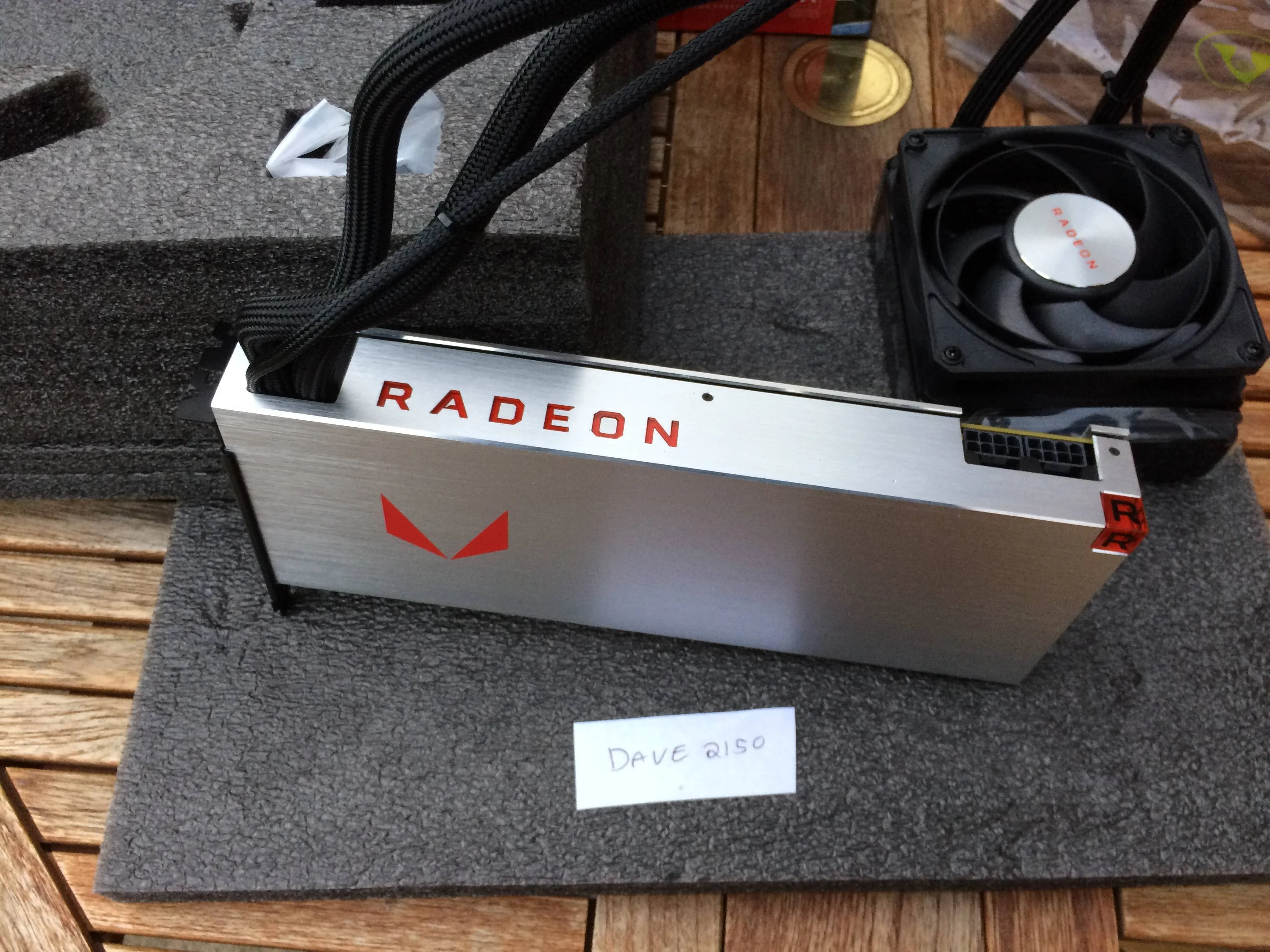

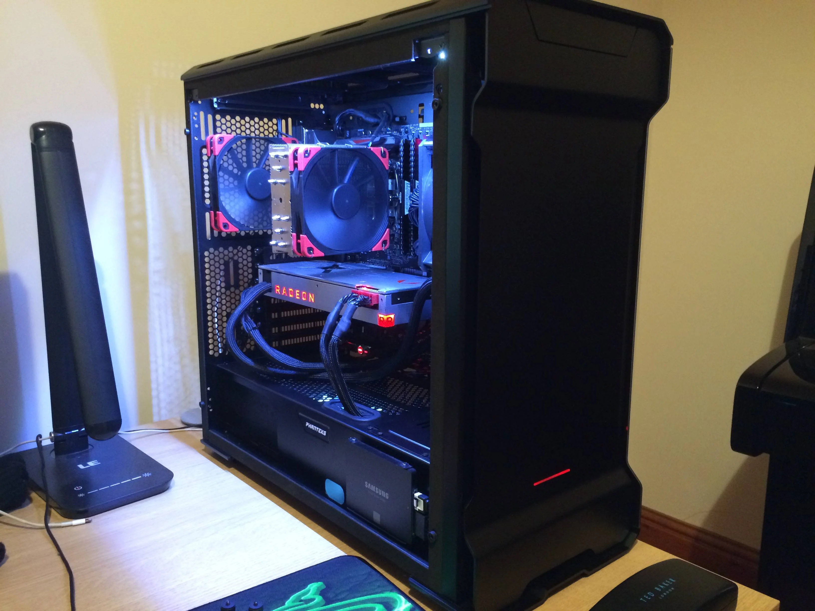

So, my Sapphire Vega64 Liquid Edition arrived today, ordered on launch day for £638. Missed out on initial stock, though more arrived yesterday and one of them had my name on it:)
Picture for the roll of honour:
Installed and running:
Firestrike: https://www.3dmark.com/3dm/21739425?
Played a few hours of prey, looped 3dmark a few times, blasted through some GTA5, all running smoothly with no crashes, on Turbo settings in wattman. Very impressed with the performance, is a major step up from my RX580, all silky smooth at 1440P 144Hz freesync :cool:
Noise wise, very happy. The pump is very quiet, can hardly hear it if I stop the radiator fan. Much quieter than the usual pumps in corsair AIO's etc. I may end up replacing the radiator fan with a Noctua though, to match the rest of my case. It's not loud, though is noticeable over the rest of my (very) quiet case fans. Luckily no warranty void stickers on the aluminium shroud, so I can simply disconnect the current fan and install a new one if needed.
The only negative so far is that I feel pressured to replace my Noctua UH12S heatsink with an AIO, so have a better view of the gorgeous backplate :)
The AIO version does look really good and well built.
Welcome and on TROH.:)
