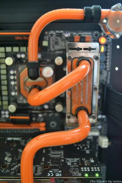

Cables are here :) Gonna drill the cable holes, buy the heatgun on thursday and start bendning.

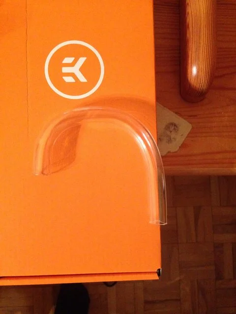

Test bend. Not as bad as I expected it to be

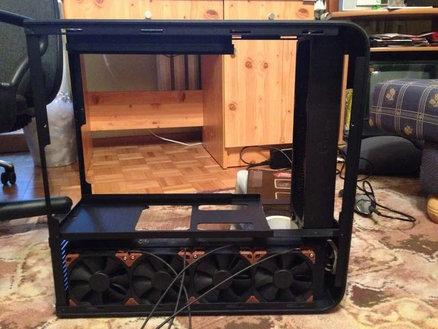

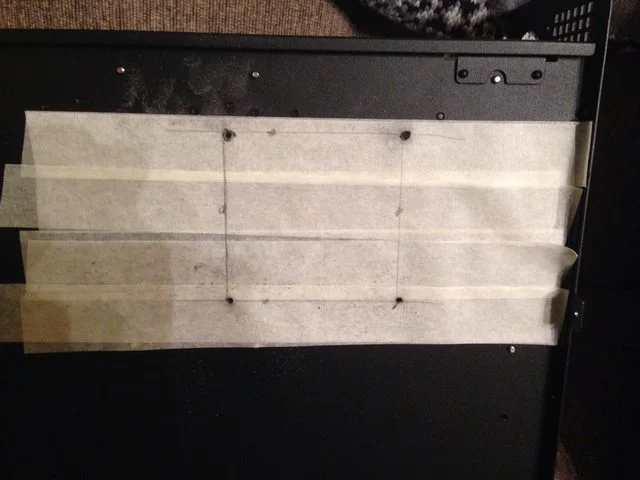

Drilled holes for MB cut out

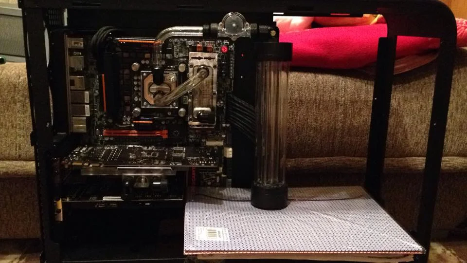

Small but still progress. 2 parts of the loop done. GPU-RAM is different to the picture and gives me a headache

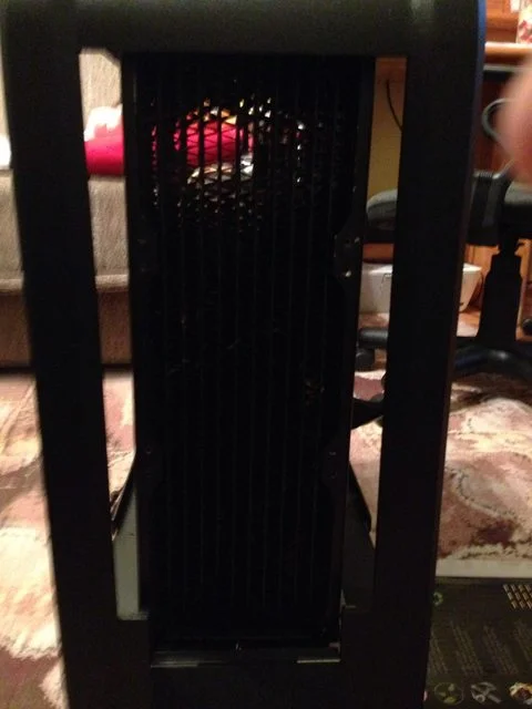

Cutting for 360 is done. Fits like a glove :)
Had to re-route the tubing and I found that I need a bigger drill. 12mm is not big enough and need to buy 14 and maybe 20-23mm for pass through.
The loop is gonna look something like pump-480-360-gpu-ram-cpu-res-pump
Need to find out the easiest way to fill it. With EK d5 top there is only 1 inlet and this makes things tricky. With 2 inlets I would just use other inlet to fill it but now it's more complicated
maybe run it with a T line sticking up and open with say 3ft vertical hose at the high point of the loop to act as a bubble eliminator?
then remove once all the bubbles are out.
I'll find out what happens to the bubbles once I fill it with DI water to do a leak test. I know (more or less) how to fill it but with PSU inside there so little space to work with
The most difficult bend is done. Now everything is easy and I should have enough acrylic to play some more with bending

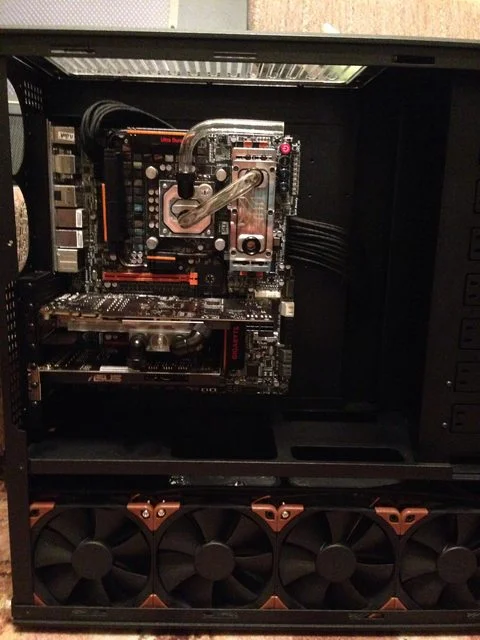

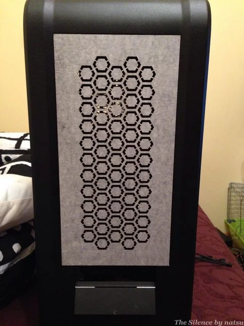

The covers are here smile.gif Bad news is that the shop I bought 3 fans from sent it to my default adress, not the one I asked them to use... So I'm not getting fans this week, mostlikely next week will install them
As for the front
Found nice place for AQ5

Good news is that my pc is up and running but still need 1 more pcie extension because 1 of them is faulty.
