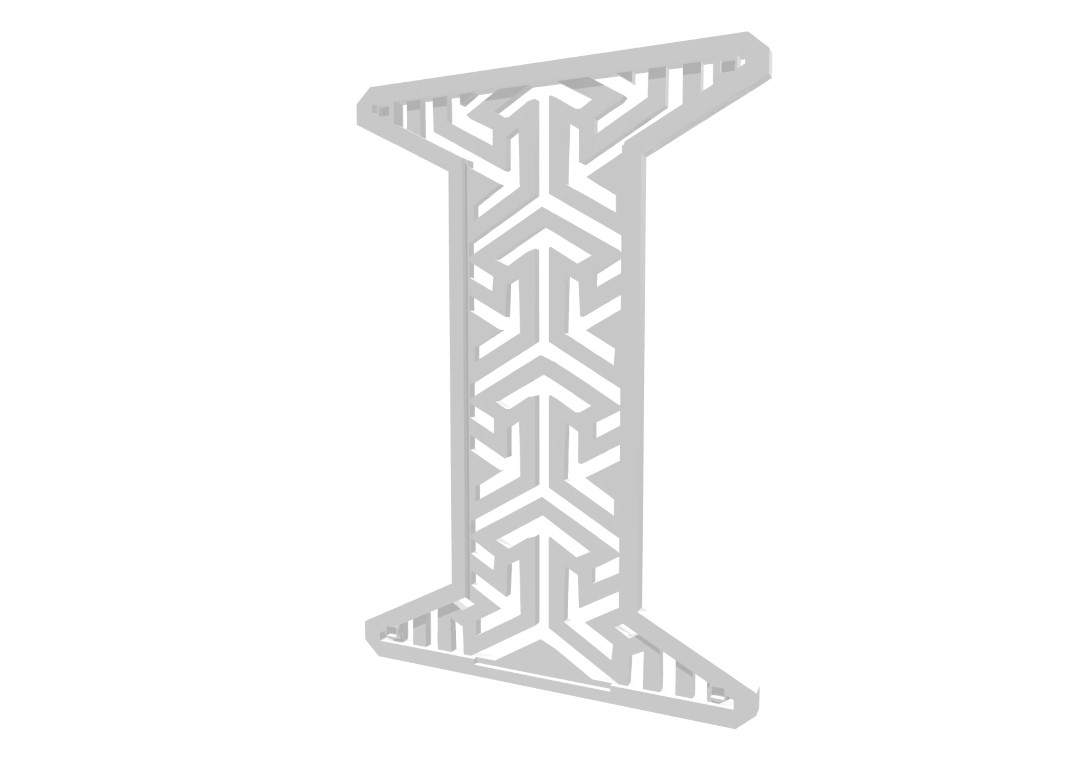

Here is early pictures of the design:
Front panel is made from two pieces
I have to take little more from the height because i wanted to print this case as a whole. I am using miniFactory Innovator so my limit is 310mm
So new height is 305mm
I added cut out for the MB so i can route all of the cables there
And cut out / grill on the gpu side for psu intake and rad exhaust
i made holes for the front and back panel.
Radiator will be mounted on the inner front panel and inner front panel is be mounted on the case with 6 screws
Outer front panel is mounted on the case with 4 screw and this will sandwich the panels so i think this will be enough to hold it together.
Back panel is mounted to the case by 6 screws.
Also i made holes for the passthrough fittings and pump bracket
I made changes to the back panel.
Psu goes to bottom of the case and grill pattern is bigger. Also i made one 80mm fan mount.
There is room for two 80mm fans but i fear it would cause an issue with cable management
I decided to print this first prototype in two parts so i added some lining tabs to help with the assembly.
Also i am going to use bolts and 3d printed sleeves as standoffs so i made holes for the MB
Two pieces ready.
And starting 36 hours print for the front part of the case
Front piece of the case is "ready". Filament broke and i did not finish so this piece is 12mm too short. I can test fit the watercooling and make some changes to the design.

After test fitting parts i made some adjustments to the model.
I added six magnet holes because four isn't enough to hold front panel.
Also added nut inserts for the mid panel and a hole for the pump cable that i forgot :grin:
