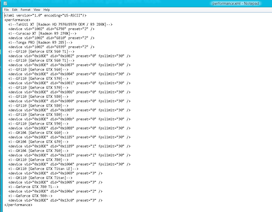

When you look at the cards with the 30fps limit it's no surprise really, and the limit only seems to be in place at certain presets.
