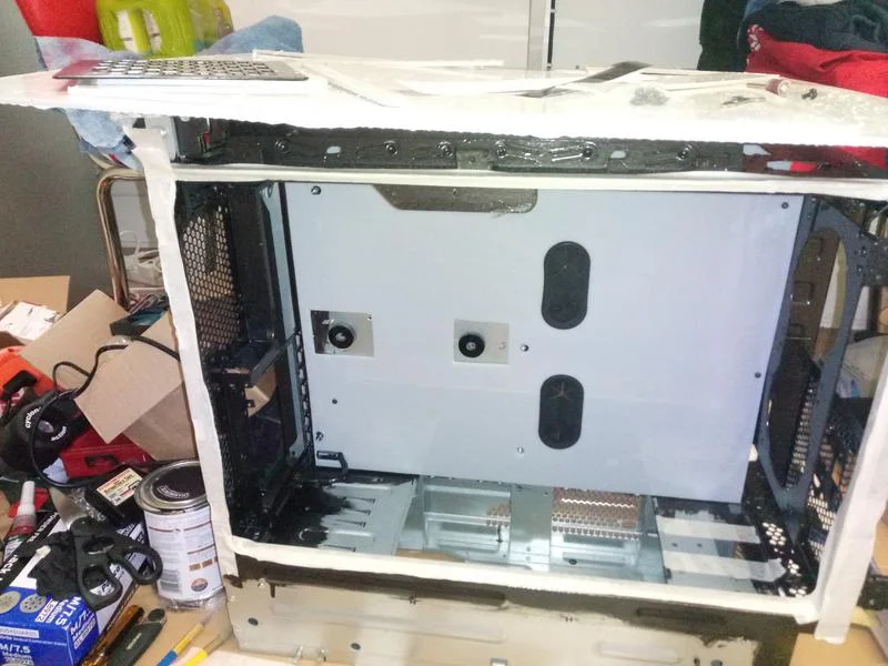

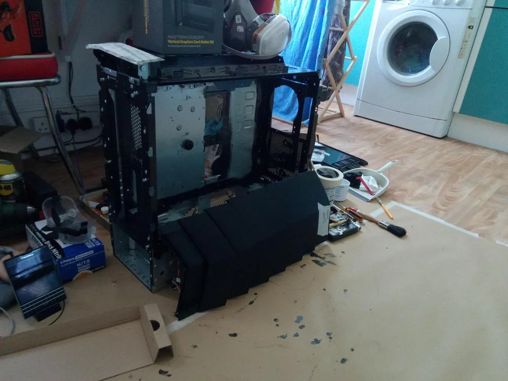

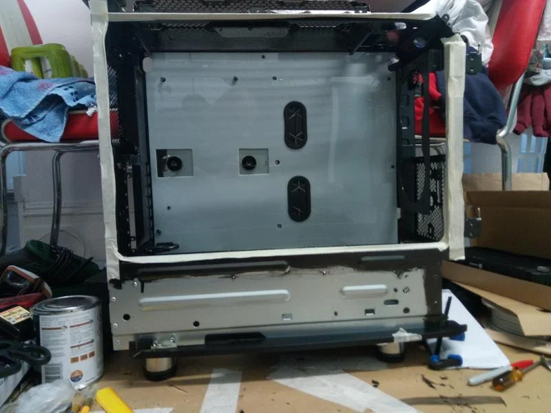

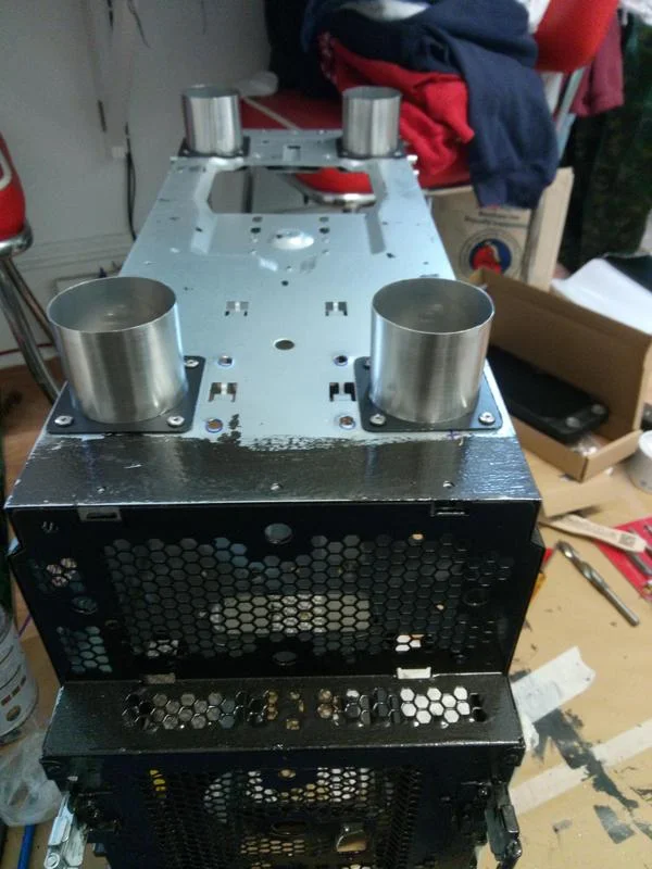

The painting is now finished. I will now let it sit for about a week to fully harden up. As you can see I've had the roof out because I needed to make 100% sure that the roof motor would not foul the front rad once it was bolted in. Thankfully (I've had the roof on and rad in) it clears OK.
I contacted the company who I ordered the acrylic from today and apparently they are shipping it today. So it should arrive soon hopefully. Will do some soldering later and rewire the FP connectors.

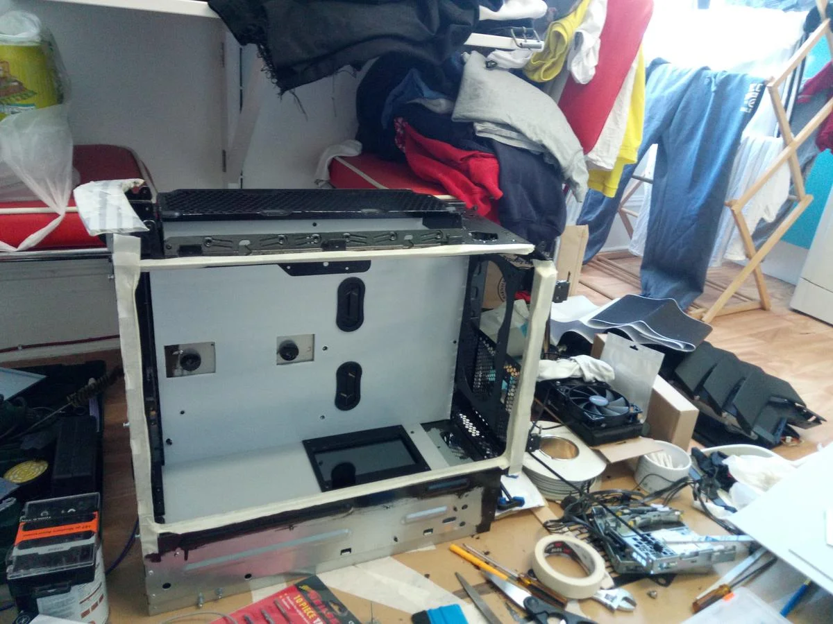

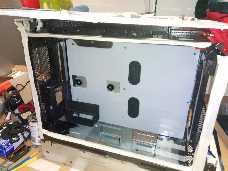

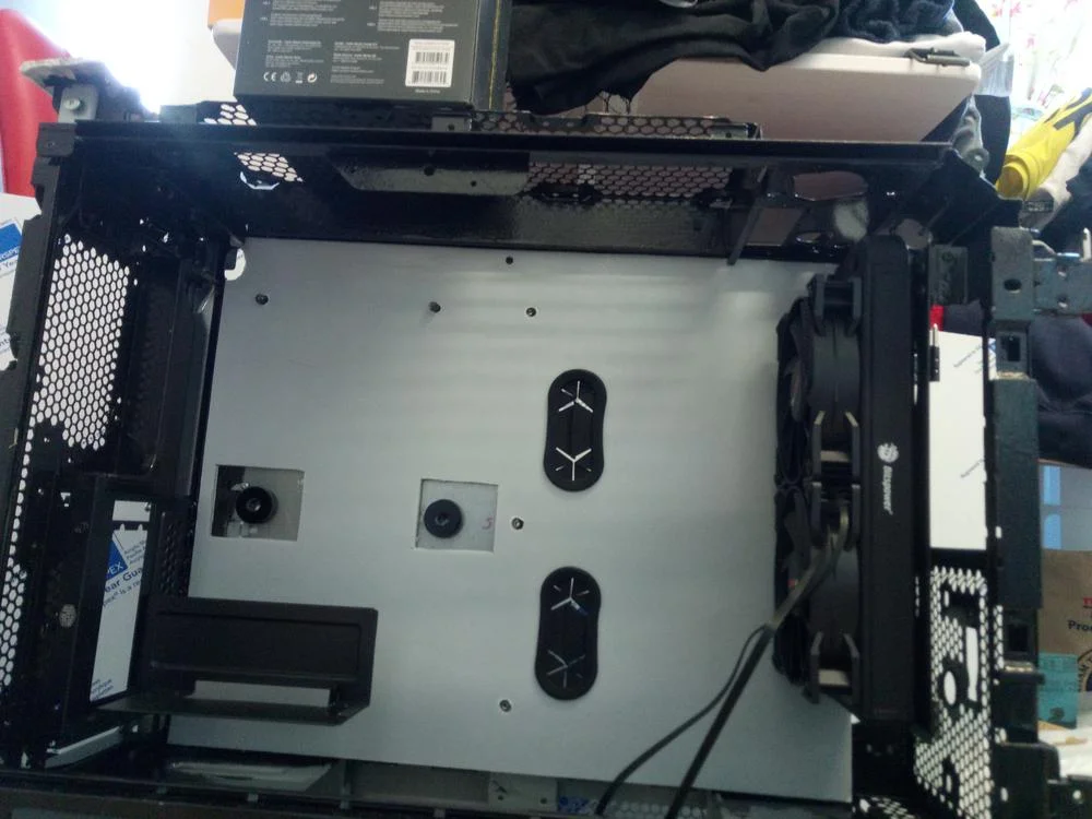

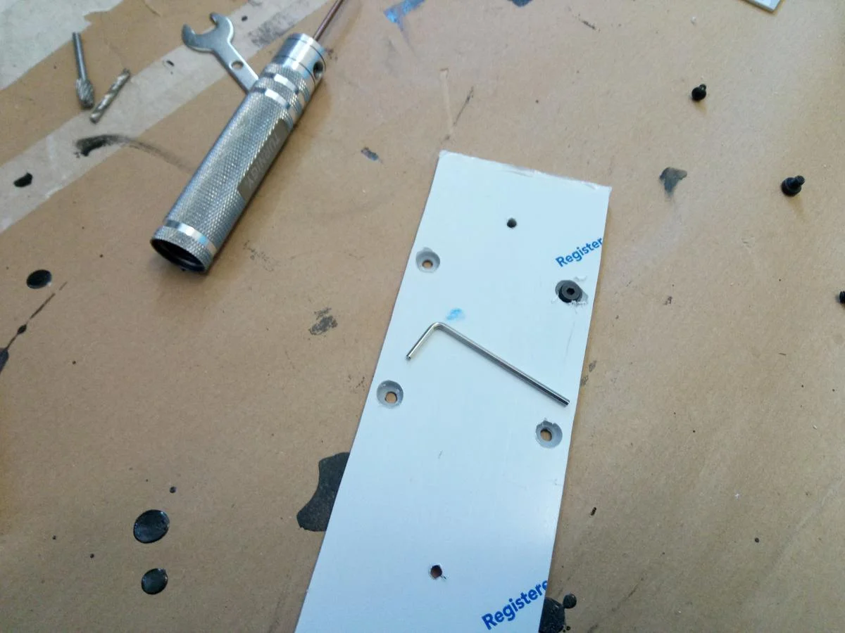

First panel is done and fitted. Note, I haven't taken off the protective layer and the rad is only there so I know it fits..

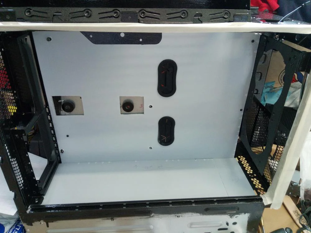

Goes right up to the top.

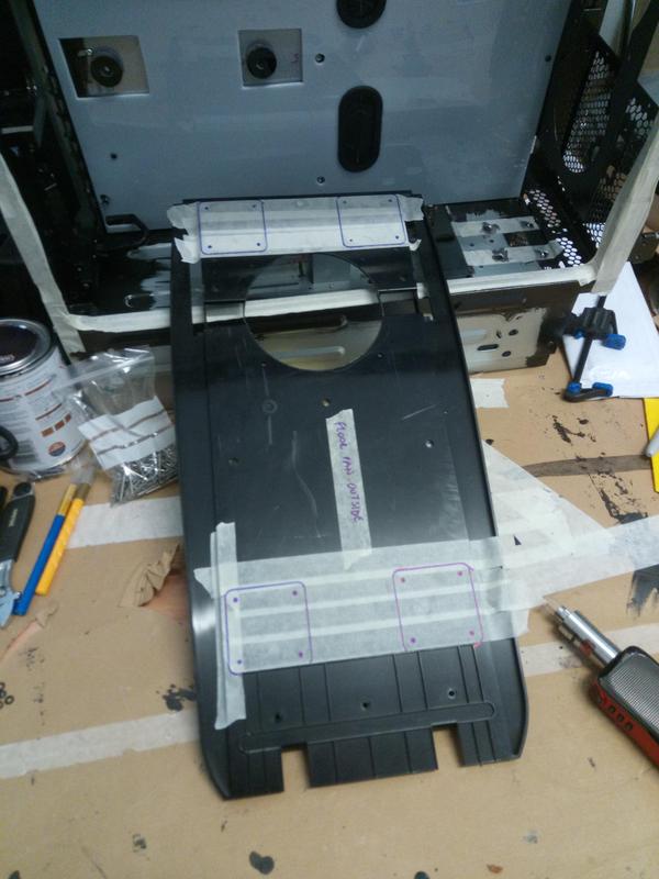

Floor made (two parts).
I now need to go back to the drawing board to design the next part. I have a few ideas in mind, but need a donor board to make sure they will fit/clear etc.

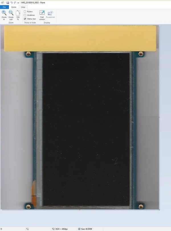

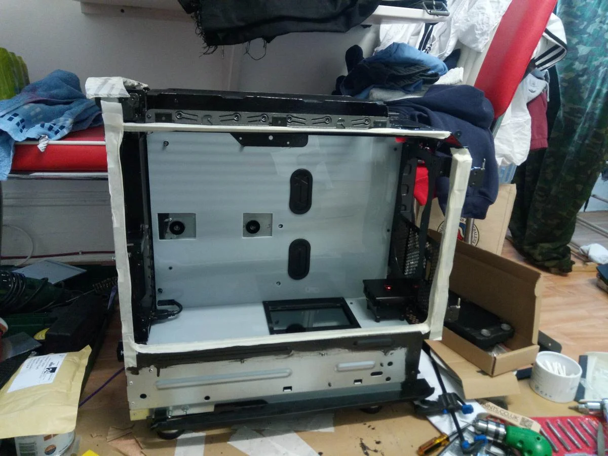

OK, so the last update for a few days (got a wedding at the weekend and need to leave tomorrow). For the past two days I've been working on how to get a 7" HDMI monitor into the floor. First I scanned it.

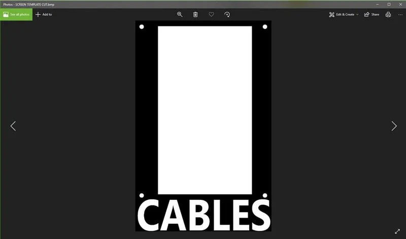

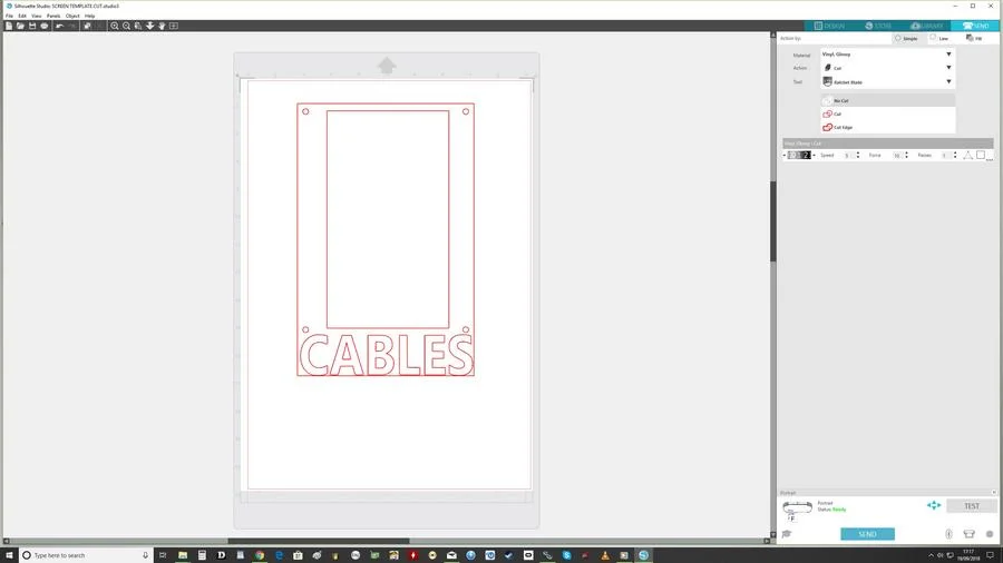

Then I had to translate that into a stencil.

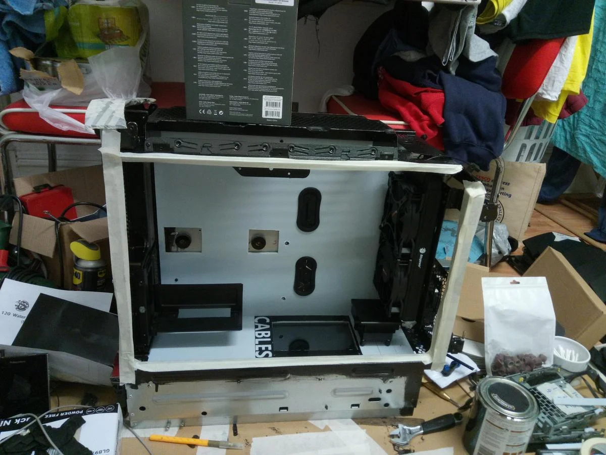

Ignore the "Cables" part, that is only there for now to remind me which way to orientate the screen. I literally had 3mm to play with here. I then sent that to the plotter.
Then set to work with the Dremel. Do note *this is not finished*. It is far from it, I am waiting on an order of acrylic to finish it with. I will go through what I need to do when I update next :)
Perfect for displaying temps, the weather etc lol.
Pic sans template. The screen is kinda weird, because the way it mounts there is a 3mm gap between the glass on the screen and the hole you cut. So, I need to get some clear acrylic (ordered) and cut a panel that makes it flush with the hole, then cut a bezel out of black that I can get perfectly straight edges on. It is not possible to cut perfect edges when the cut out is "into" the material. You have to tilt the Dremel to get access. This will be resolved with a small bezel.
Adding the clear layer will also strengthen the part and stop it sagging.

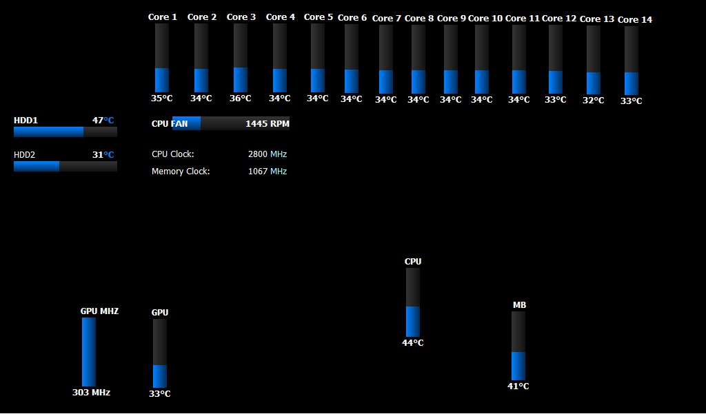

When I bought my PA3 (a small computer that controls pumps, fans etc) I got a license for the software. I never did finish it (it would probably be a day's work to build my front end) but I will now. So as frivolous as it seems it will be incredibly handy.

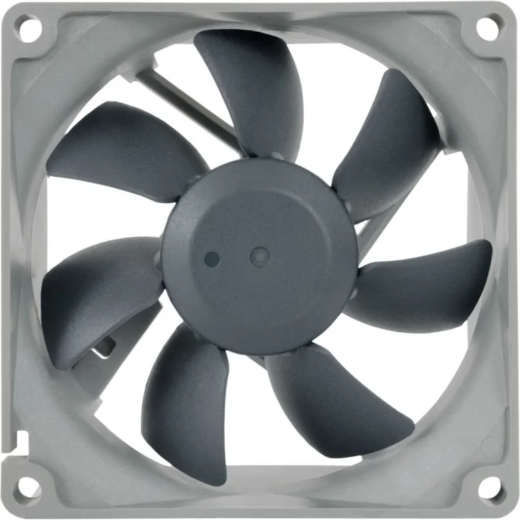

And an intake fan for the bottom chamber. I am going to have to move the Alienware daughter board because the nuts from the wheels will get in the way. I am putting the fan in there (it's 80mm) just to draw some air over the boards that will be in there.

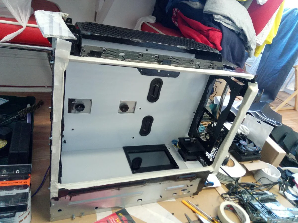

The floor LCD is now finished, with a bezel.
It also has 3mm of clear plexi over it.

Today I made the holes for the pump and countersunk them.
And then fitted the pump to where it will live.
Do note - I am going to fit the IO to the side of it, and put a plug in the top (maybe that pressure release valve, if it fits there.

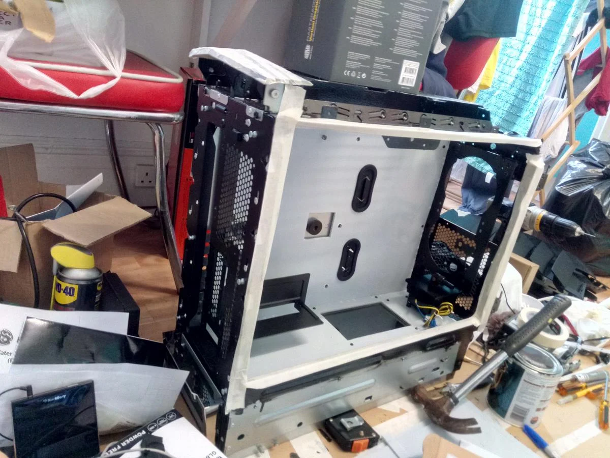

OK so I now have a rear mounted HDMI port for the screen.
I was a little concerned about it breaking the clean look, but once the GPU goes in you can't see it.

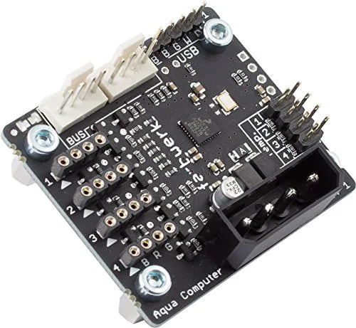

Also ordered a Farbwerk.

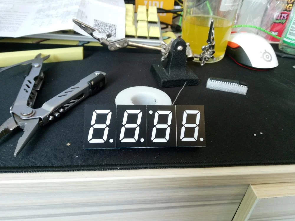

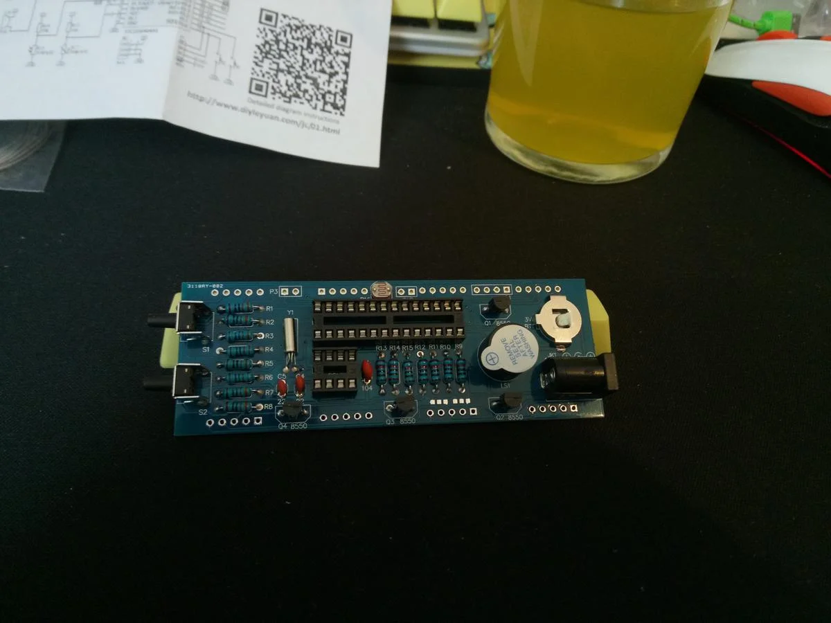

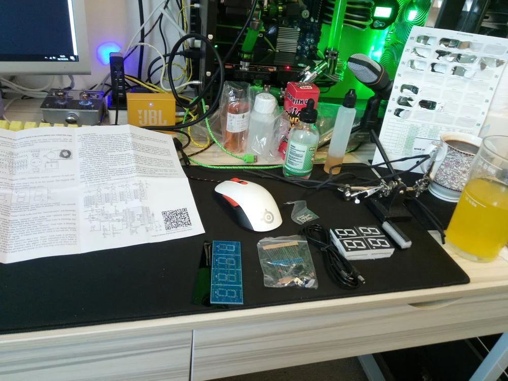

Time (lol) to build the clock. It arrived (what I thought was -) in one piece.

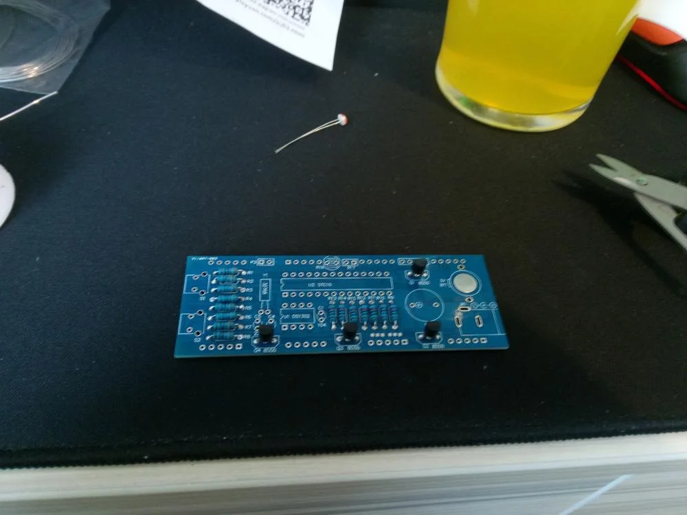

Started soldering, went well..
And back side finished.
Now this thing is a sandwich, so basically if you miss a component and solder the digits on you are *****. Totally *****. I didn't miss anything, apart from putting one component where I thought it would go but didn't. No biggy, desoldered it and moved it..
Then came time to fit the segs. Only, one of the segs had 4 legs missing :( I ended up having to take the seg itself apart (seriously) and god must have been on my side, 'cause the legs were inside the housing. I soldered them in (properly) and....

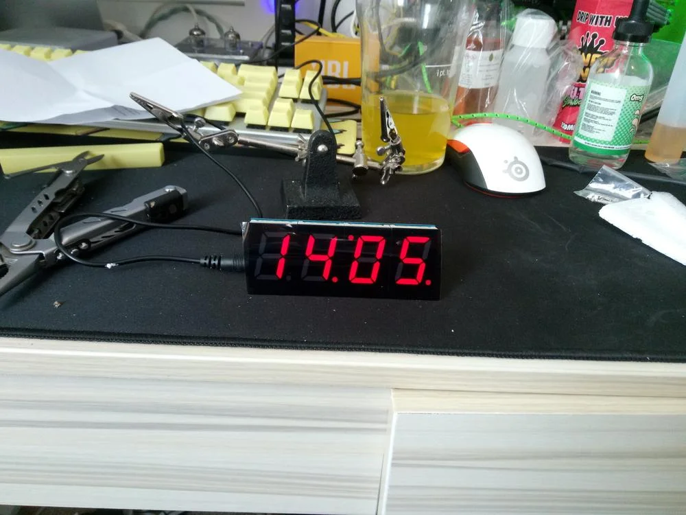

And the acid test, time for power..
Wait, let's just put a filter over that..
OK do note there is a dot lit on the seg that I needed to repair. It is on the same circuit as the dot on the left digits. This is because when I put the PCB back into the housing I did it wrong. It's perfectly safe (it just does exactly what the other one does) so I am going to cut a small black dot of vinyl and put that over it, so you can't see it.
Other than that? yeah, I am pretty happy. Will go about making the shell in a bit.

Doh, what a wally. Both of those dots are supposed to do exactly what they are doing. Time is displayed like this - 13:45 or whatever.
