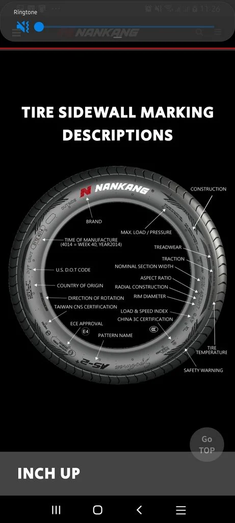

i got some 195/50/15 nankang ns-2r for 59 each delivered for my mx5 but am worried i got sent old ones, not sure if this info means it was made on 17th week of 2019 or 2015? any one care to help
for added information am putting them on my Enkei ES tarmac wheels which are around 5.5kg and usually found on rally cars

Looking at the diagram, the manufacture date is week 17 2019. The 002181/2015 isn't part of the DOT code. If you look at the diagram, the letters DOT come, followed by U8**, then a four digit number, then the manufacture date
10 May 2006
2,334
thanks for the help, it was unclear from the two sets of numbers which was the correct code to use. also the tyres look filthy from being loose in a van which made me apprehensive about the date.
i got them for 59 each and i use a decent tyre place that charge 12 each for fitting and balancing with decent valves so not a bad price.
