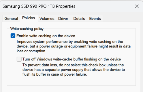

Ensure Write Cache is enabled on the drive from Device Manager?
I forgot I had this disabled on mine and had slowness and freezing.
