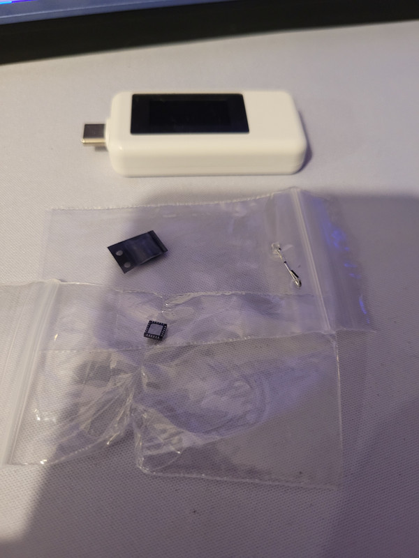

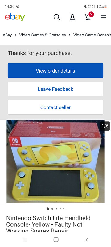

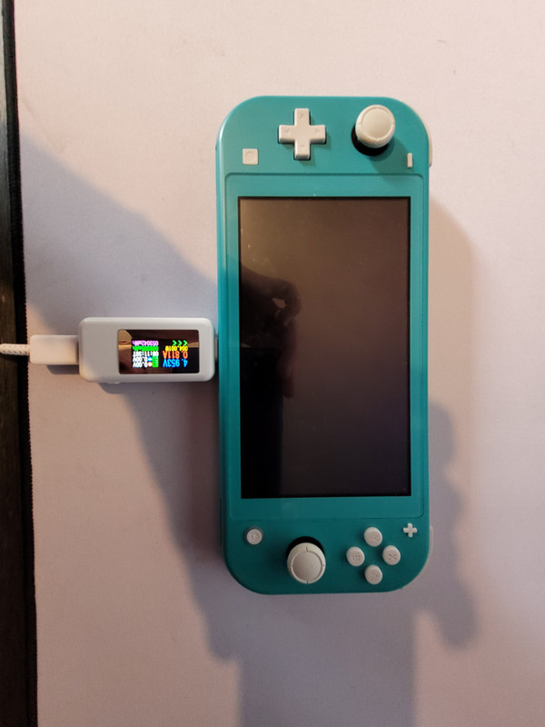

Still waiting on the switch but have got a few of the most likely parts in ready for the repair. I'm thinking no life/no power it's going to be one of three things. Either the charge port itself has been brutalised or one/both of the BQ24193 (Battery charging IC) or M92T36 (USB-C charge control IC) has gone. All these parts are really cheap and it's pretty easy to diagnose which one has gone so hopefully we should be ready to rock when it gets here.
This is of course assuming the seller is genuine and the switch hasn't actually taken a bath or something.
I do have my original switch to test against and from a quick look around it appears the switch lite has all the same power circuitry as the standard switch bar a couple of little nuances. Looking forward to this and noticed I'm gradually getting more modern... need to go back retro after, thinking a neo geo pocket or a dmg gameboy.

As promised it doesn't power up.

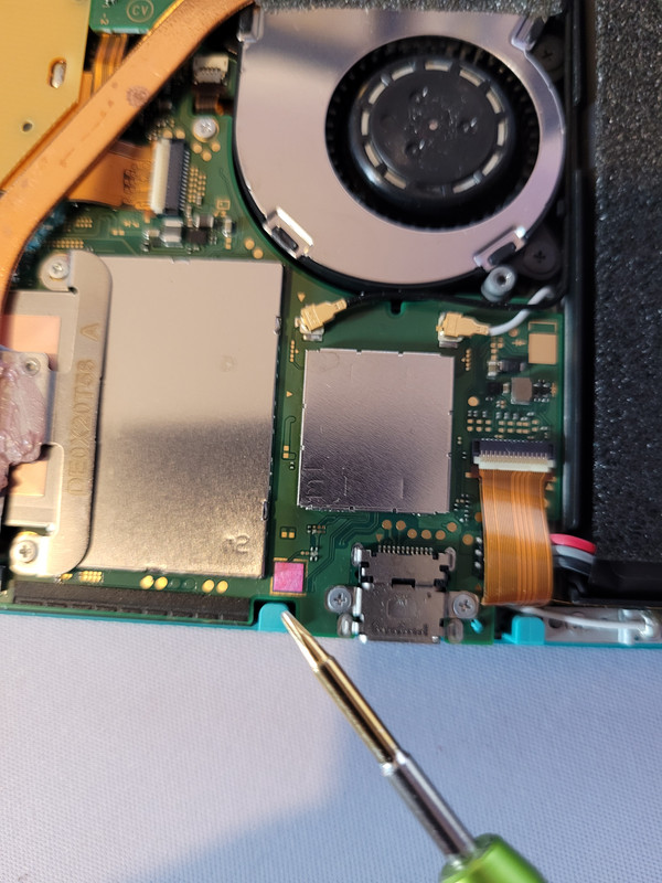

As I start taking it apart is fairly obvious it's taken a bath... Corrosion..
Water damage indicator
That looks a bit grim...
More corrosion
And more

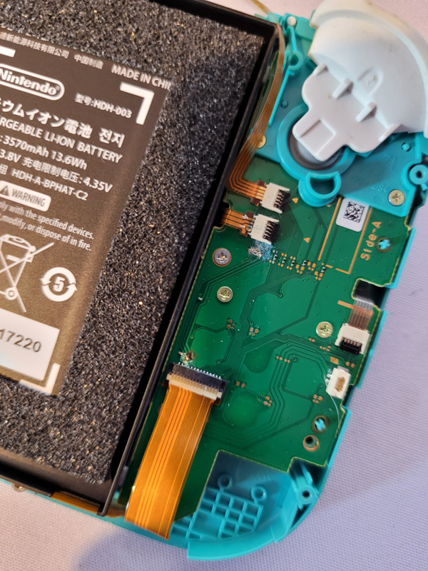

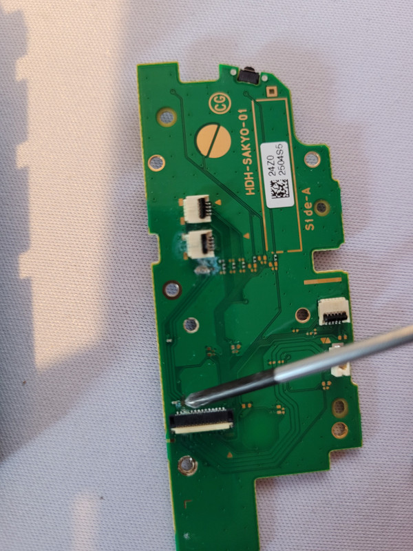

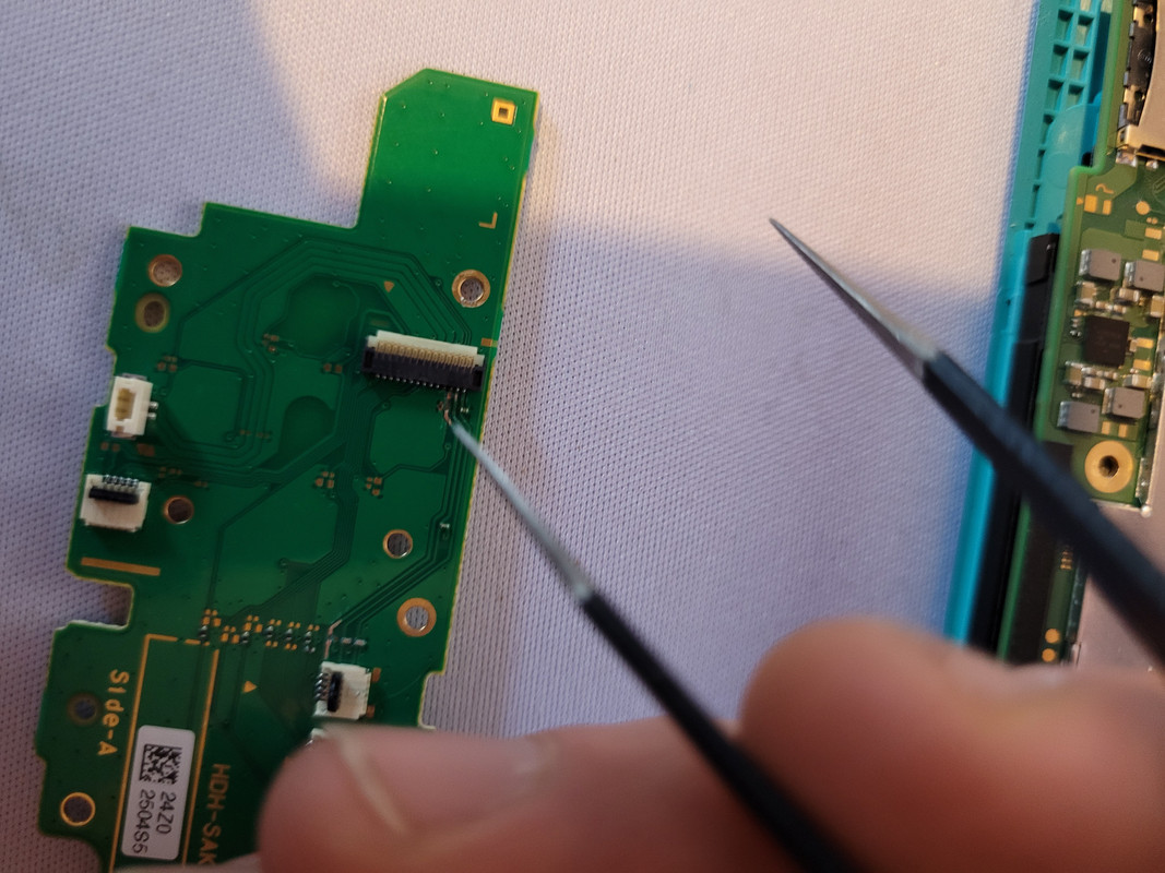

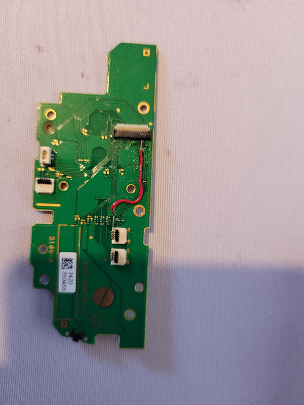

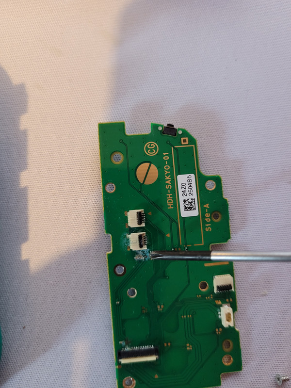

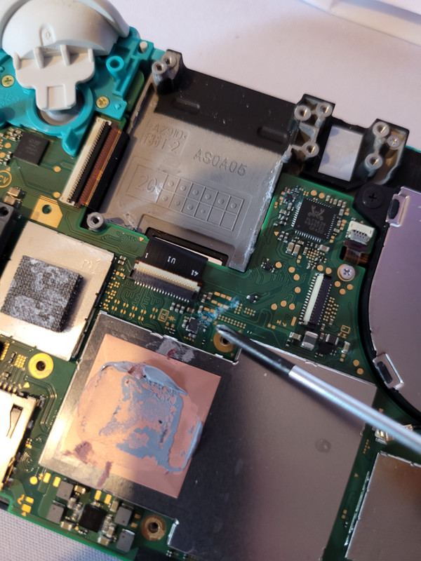

Whipped out the daughter board and this rail should have a couple of caps on here
One here, instead of the caps we have burnt broken tracks both at the top and the bottom.
There used to be a pad here, rip pad...
Cleaned it up and scraped it back so you can see the breaks...
Little patch wire and the rest is in the video as I didn't take photos :mad::rolleyes:

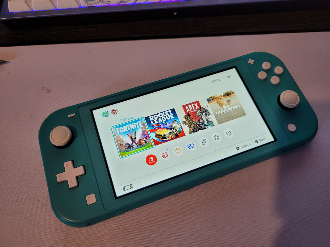

But we did fix it :cool:

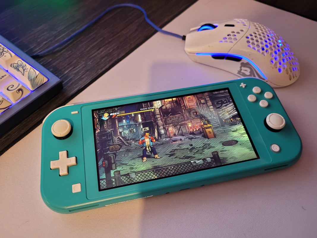

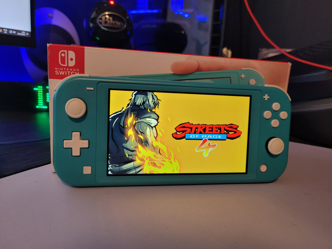

Final little pics of the switch, played an hour or so of sor4. Calling this one done:

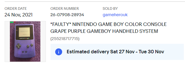

I also bought something a bit more retro in the same colour I had when I was younger. This one is for some modding I think:
