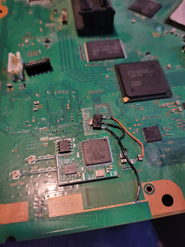

Vince, do you have an experience of repairing/replacing the WiFi/Bluetooth module on the PS3 Slim, specifically the CECH-2503B? I turned mine on the other night and the controller will no longer connect (only works when connected via cable), the console won't find nor connect to any other Bluetooth devices and it can't find any WiFi networks either. A brief bit of research online on the issue and searching for the error codes suggests the wireless modules in these can fail and can be a faff to repair or replace depending on model.
It's still usable with the controller attached via the cable (I've got an extra long one arriving today to tide me over!) but I'd like to get it working properly again.

Well now you mention it... Way too much stuff I dont share on here!! Super common that the buck also fails along with the wifi on these so you can bodge it like so... This is a special edition that came in a few weeks back.. no wifi, no bluetooth.... Now has both wifi and BT :D All the buck does is take a 5v input and spit out 1.8v so you can bodge it fairly easily.
Replacement chip was about £10 from China... replacement transistor to replace the blown buck was like £0.50p. Oh and I did clean up the messy soldering job and stuck some new wires on it once it was done... :D
One of two things has happened... 1) the buck has failed, sent 5v to wifi and destroyed it... 2) the buck has failed no voltage to wifi and that's why its not working... wifi failure alone without that buck having failed is pretty rare.

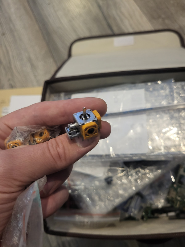

Vince, do you have any experience fixing stick drift on an Xbox controller? Is it simple enough to replace the analogue stick?
So depends on what xbox but generally the pots on most modern pads look like this:
They have about 10 or so pins that are soldered into the board on the controller. It's a case of removing the old pot and soldering a new one in.

You can try cleaning the wipers on the pot (a case of bending the amber coloured covers back in vinces picture), and it *may* help for a little while, but the proper fix is a replacement.
There are videos on YouTube if you want to try (worst case you snap the legs on the pot and need to replace it anyway)

I've never actually had any success cleaning out the pots.. I must be doing something wrong as every time I've tried they end up worse

I'm probably doing it wrong tbh that genuinely wouldn't surprise me... nowadays I just keep a few different types of pots around and swap em out. I've got some green alps pots here and some other common ones.

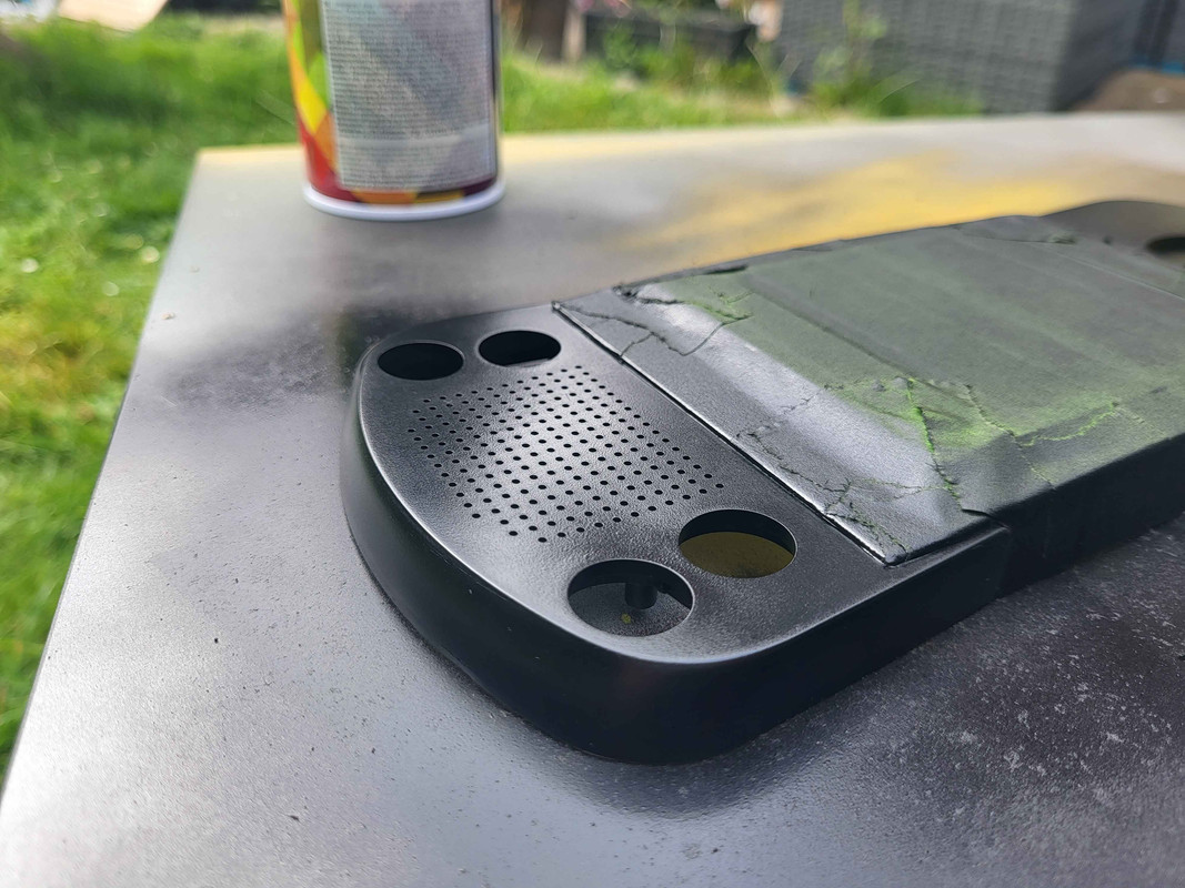

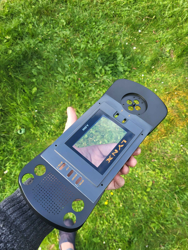

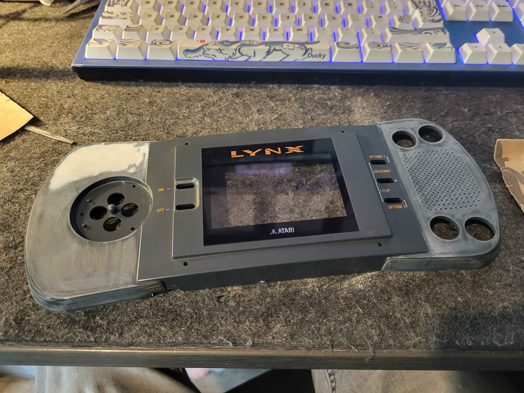

Looks great. Was that some Plasticote type paint or similar?
I filled it with plasto sanded it a bit and layed down a filler primer on that section and some plasticoat. Seems really decent and should hold up.. I took to it with my nails and a set of keys.. it's on there good... I did debate trying to match the grey but given it would look just bad if I got it wrong I thought black looked the obvious choice.
I actually own it now as i traded it for a fully working not damaged machine so and am only into it a relatively small amount it owes me about 60 quid.
Tbh it's a shame you can't buy lynx shells but I guess they are a bit niche
