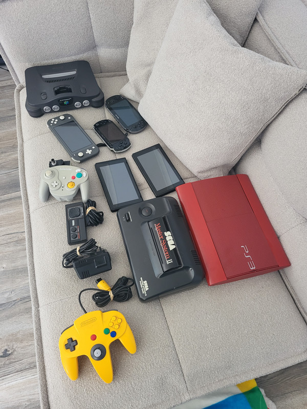

Thought I'd quickly show you some stuff that came and that I've slowly been looking at. I know I've got some ocuk stuff which is still here so I'll reach out to everybody this week with updates... but yea what we thinking of this lot;

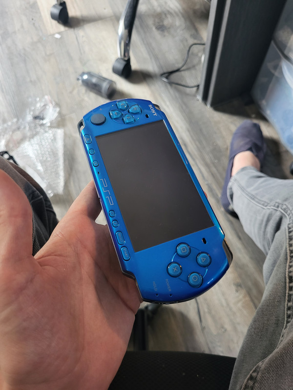

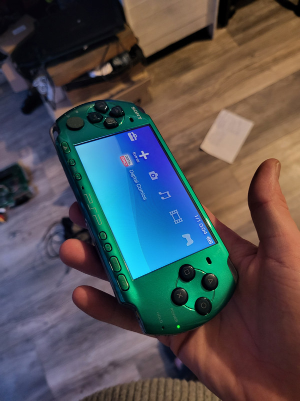

Got loads of psp's and vitas at the moment I just love giving them re-shells and making them like new... mindless and relaxing just popping screws out and fitting stuff up... love it.
Currently have 4 Vitas here and am thinking I'll also refresh one and make it blue... even got a 3g 1000 oled one and I've not seen one of thos in the wild before.
