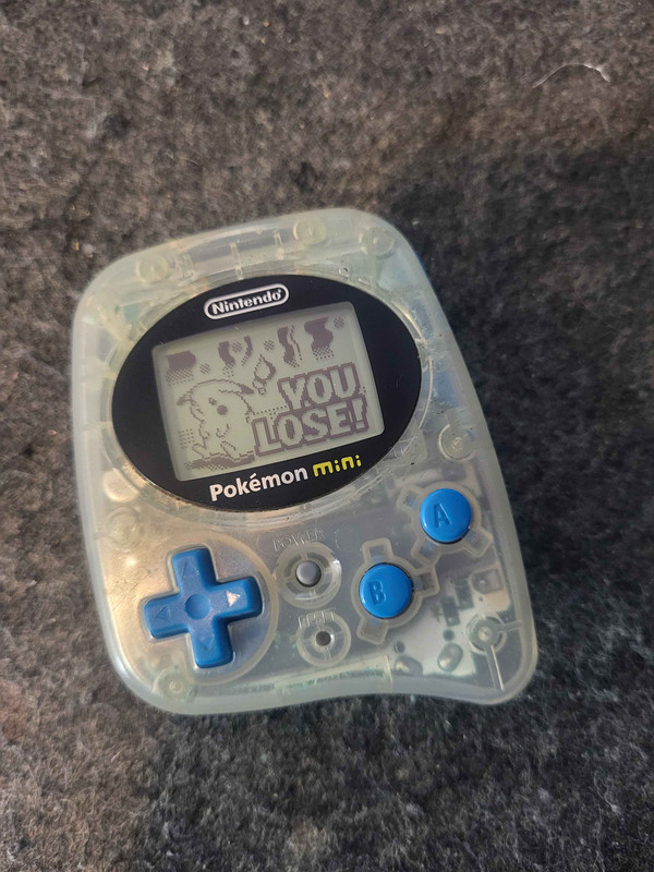

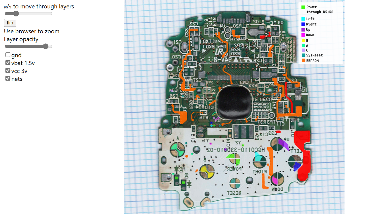

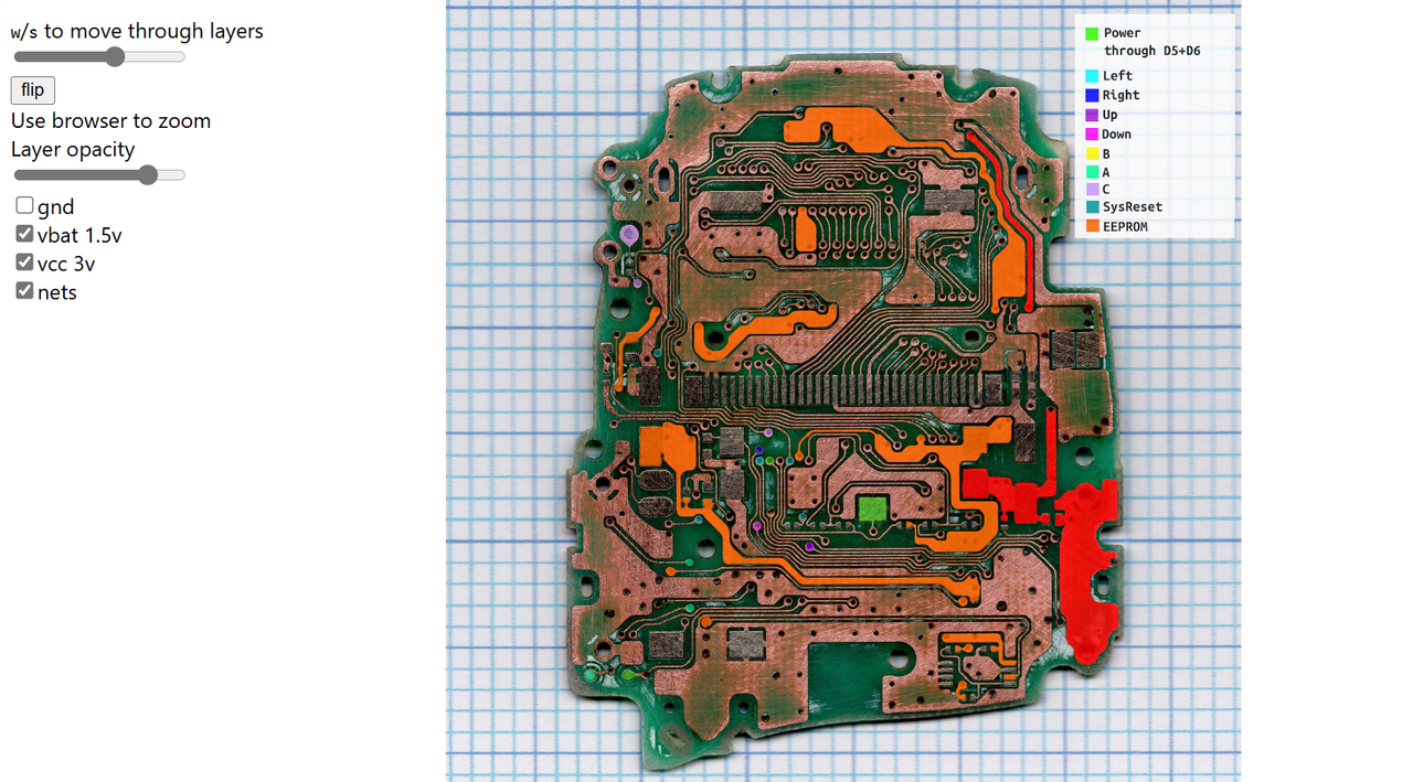

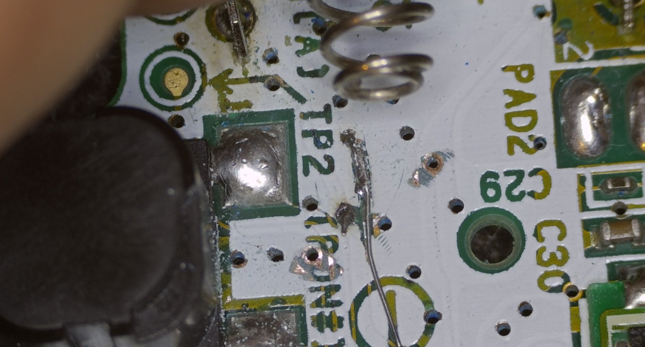

today we are on a mission to correct massive amounts of damaged VIA's on a pokemon mini where battery acid has clearly leaked on the board... It wouldnt boot but we have sorted that... now im searching for issues with the eeprom...
Lots of grinding and running jumpers but we are getting there
Edit: eeprom issues now fixed next up a and b buttons don't work so we need to fix those as well. Luckily a mate of mine made a superb little app for the pokemon mini...
Absolute life saver! basically everything in the affected area was broken, eeprom connections, sys reset, power lines to one of the diodes and the A and b buttons. Reality is I've spent nearly 2 hours on it so far so it probably wasn't worth fixing but im having fun and nothing more satisfying when that little screen springs into life.
Before I mask the board up and put it back together ill get some pics of the various jumper wires and via repairs.
