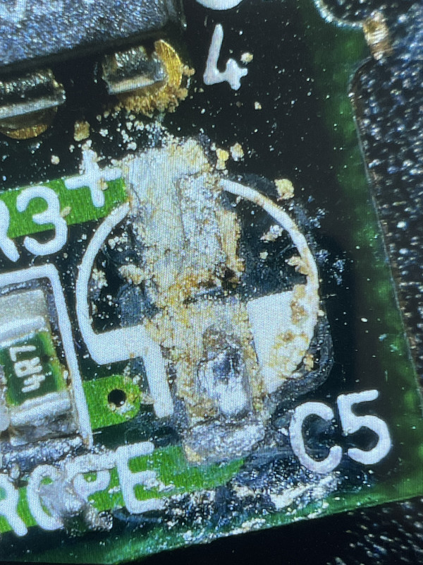

1uf 50v are 0805, 100uf 6.3v are 1206, and 10uf 50v are 1206.
And this my friends is why you change capacitors on gamegears! No wonder the sound was completely broken
Looks standard GG to me... Ive done a load of trace repair on the yellow one which I know you have seen - Ill do a full write up on that device when I get it singing along. Waiting on my China order as ever!

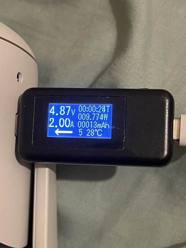

Just a thought you can't even think about working on a switch without a usb-c ammeter. Do you have one?
