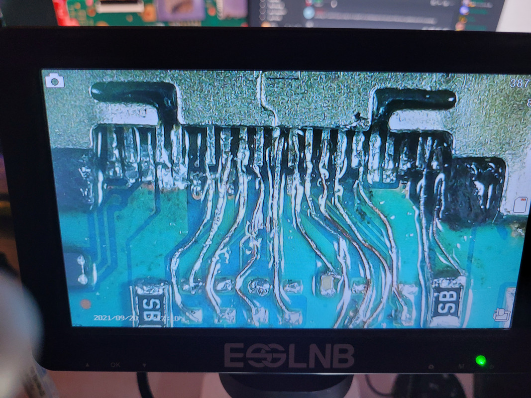

Here's what I did tonight, one vita charge port completely jumpered! Was fiddly because that port is tiny!!
Going to give it a test then mask up the whole area if anyone wants to change the port again then good luck I guess.
Deffo worth having a look at some of the Northridge Fix videos, he does a lot of these ****ed port repairs very nicely. Several are titled "Hiroshima", check them first :D
Awesome work mate , pin fixes look great. It amazes me how some people are allowed near a console to fix it. To cause so much damage is madness.

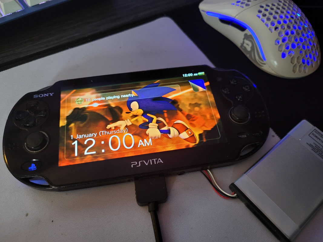

The Vita needs a battery I think, it flashed for an hour or so before just refusing to boot or flash now. When I plug it in the orange light comes on then goes straight off - I am told this is a sign the battery is totally shot so new one is on order.
Does it smell of fish when working on it.. if it does then you know!!

Vita battery was about 7 quid and we have waited a month for a port so can wait a few more days on a battery - plus there is an all new chassis for it on the way anyway so it won't be finished until that comes anyway. On top of that the board still needs to come out so we can apply mask and clean up.
That is clean, it's a late gen1 the early gen 1's had a red coating inside the case rather than silver. Really you should be good with just a re-cap. Does it red light boot and stay on? If so recap it and you should be pretty good.

Let there be Vita life!!
Opened it up again unplugged the battery and forced some charge into it with the bench supply... plugged it back into the console and eventually the console picked it up and let me boot!! Og battery now appears to be charging and the device is turning on.. I do only have one game called gravity rush so might give that a go and see what it is all about... now awaiting stuff to make it look like bran new.
Looks like my many jumpers on the charge port hit the spot perfectly... I'll take the board out this evening UV mask it and share some photos of the finished product... mashed charge port 0 Vince 1 :cry:
