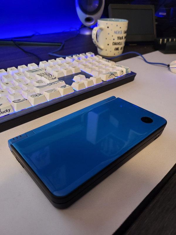

Nice looking keyboard too.
You got pics of the finished article?

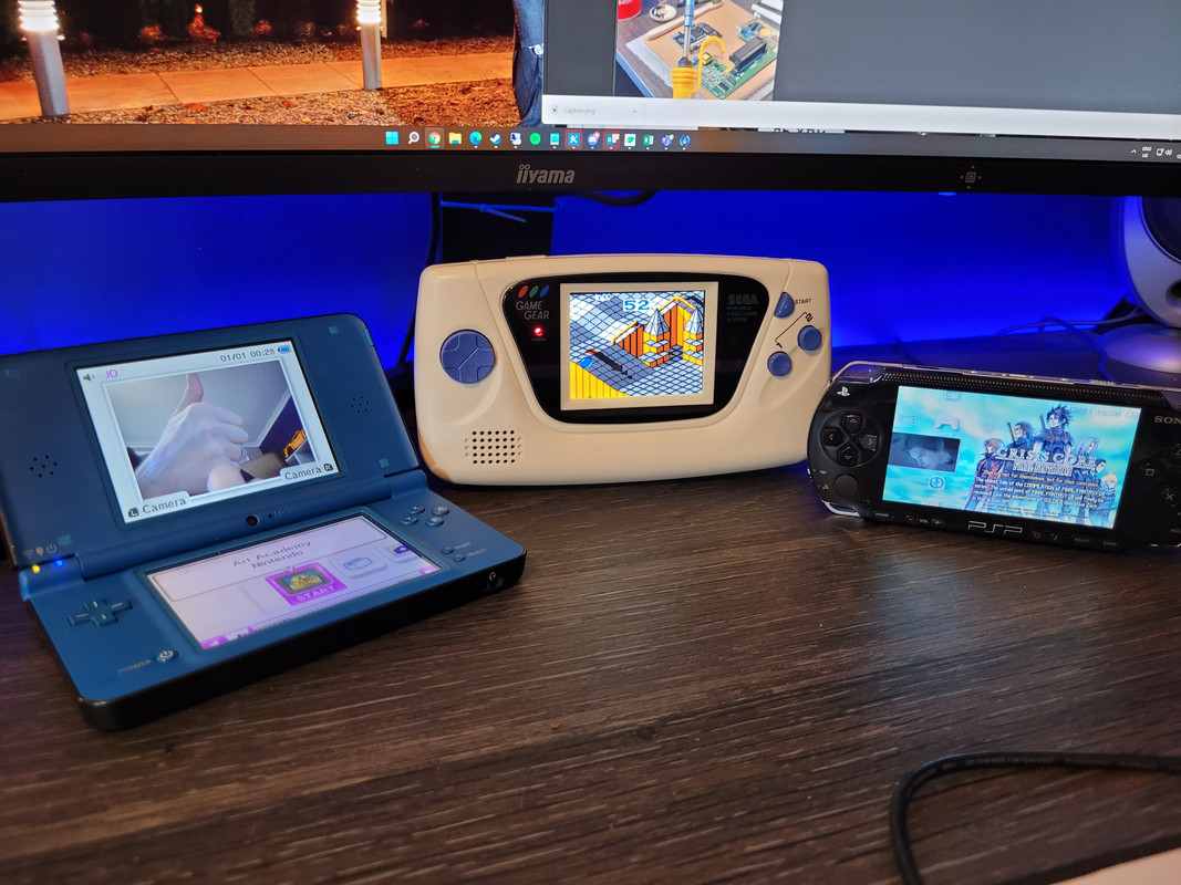

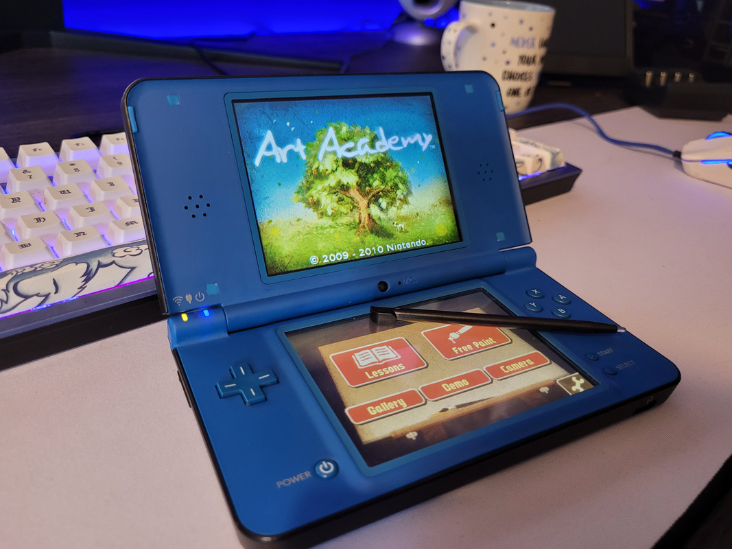

Not quite yet, its still in a state of many pieces, I did get it all back together then realised only one of the two camera modules I have works (the really water damaged one doesn't) and that I had fitted the wrong module. So I now have to tear it down again and getting the ribbon cable for the screen through the hinge is all kinds of nightmares so I put t to one side until I was more awake! I'll likely have it all back together today at some point so will do a before and after pic of the 3 consoles :D
Keyboard is a Ducky Year of the Dog, great keyboard :D

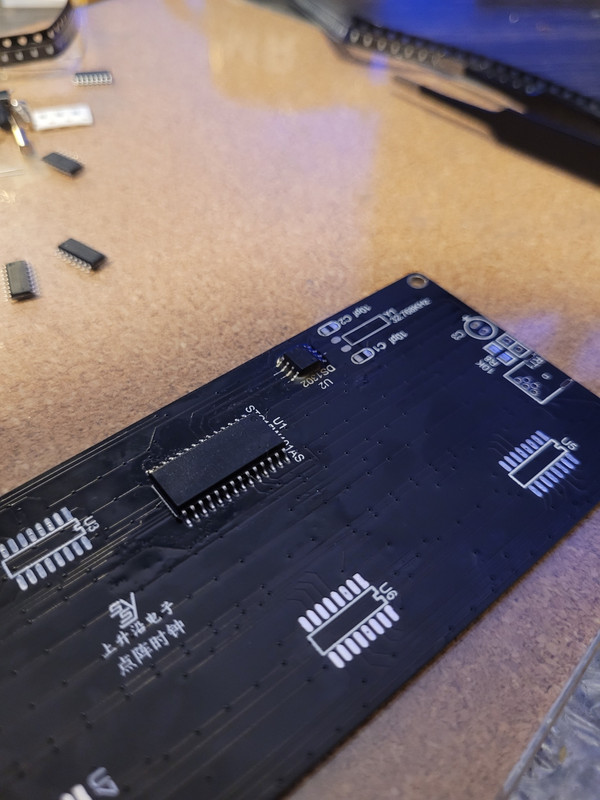

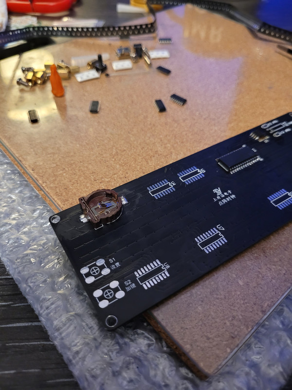

Weirdly I've been scouring ebay looking for more things to fix and on that list is a DMG gameboy and also a 3ds! Right now i'm building this Chinese led clock which has about 200 tiny little LED's to solder...
gif upload
I'm about 100 112 led's in and have a long way to go (I counted, 176 left) ... There are also no instructions and all you get are a bunch of parts. With no instructions and seemingly none online I've spent quite a lot of time probing about on the board trying to work it out. If I put my meter into diode and probe about im fairly sure ive got it right :)
Here is my work on it so far!
A few things of note, I bought a blue one but its clearly green. Next up there are a load of tiny resistors and caps that im not entirely sure whats what and what goes where so if it works when im finished it will be a minor miracle... ive also killed 2 led's in 100 as they got stuck to my iron or flew across the room when i was trying to pick it up with tweezers so i hope there are some spares :cry:
I've still got probably 160 of those tiny led's to solder.

So I finished the LED clock... looks like I got the polarity of every LED wrong so all of them need swapping around :cry: I swapped one column around and I recon it will be all good once done!
So with everything done, and you can't photograph the thing clock because of the LED poling rate of 32khz, so part of it always looks broken in a photo...
