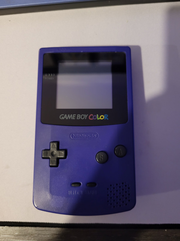

Got home from France to a few packages :) But only one would be interesting to the thread the Game Boy Colour turned up and it kinda works!! I dunno how but it does! Let's have a little look at what we have:
This is what it looked like straight out of the package:

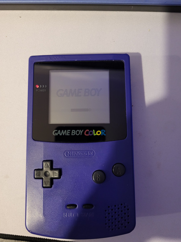

Turn it on and we get something so that is promising...

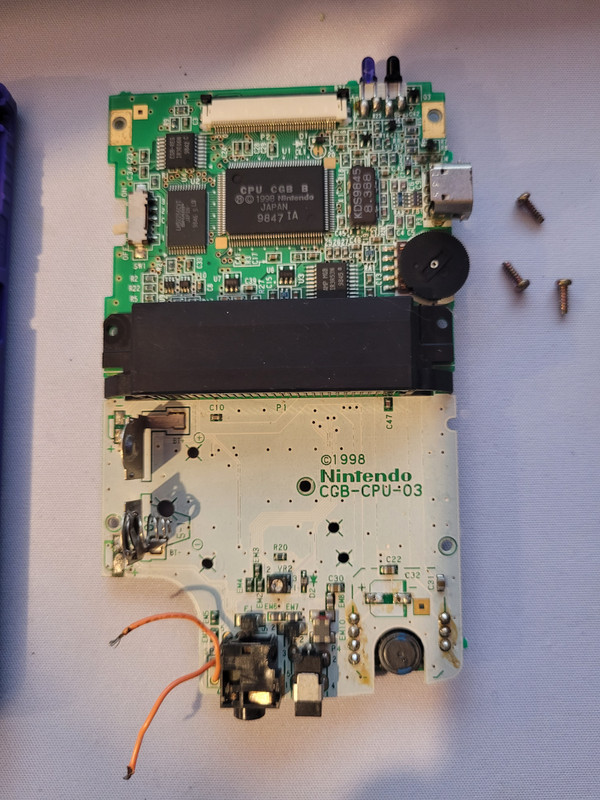

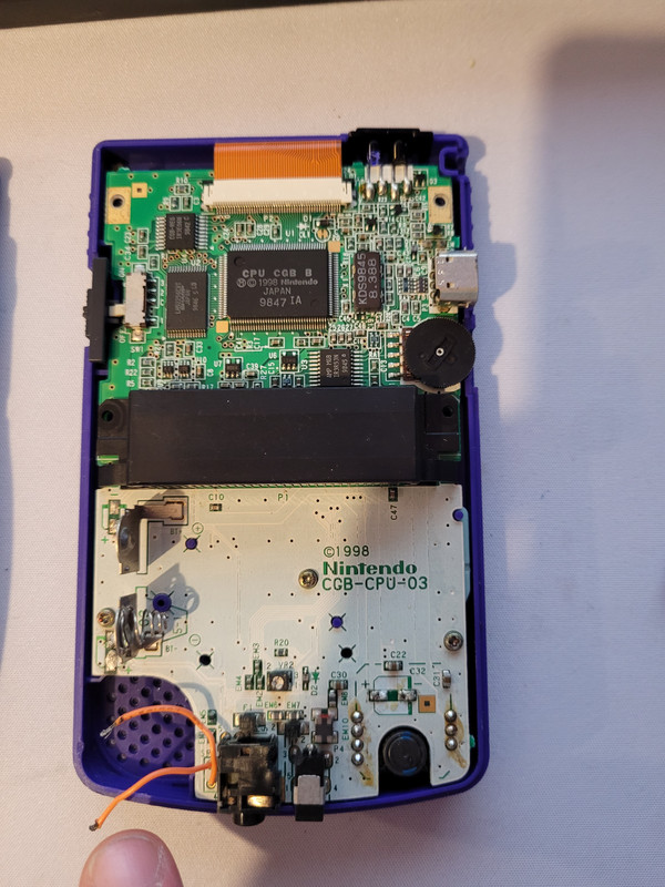

Lets have a little look inside, open it up and straight away the speaker is missing and those wires don't look factory to me...

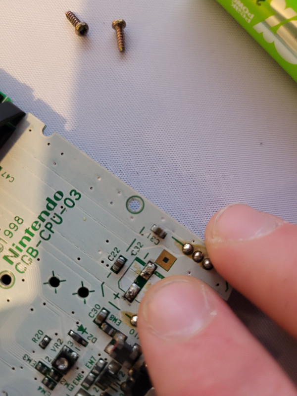

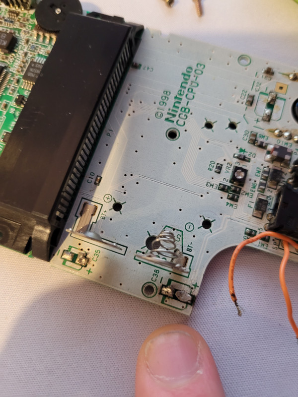

Didn't spot this but after I took the board out looking for any electrolytic caps, I started spotting where they should be :cry:
Oh and the main power cap is missing as well.

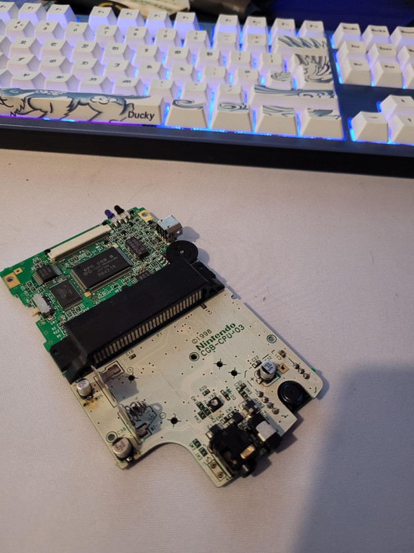

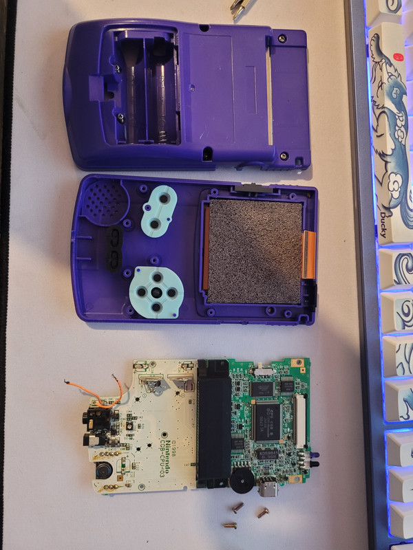

Apart in all its glory!

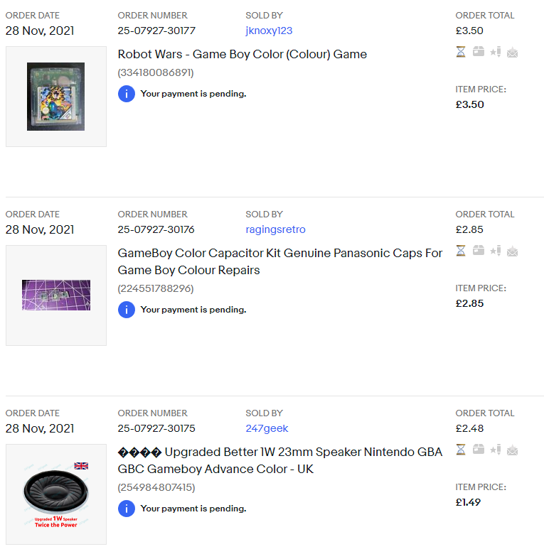

I don't have any games again so I guess ill just explore and find out what value caps etc it should have, find a speaker and go from there. I guess some of these repairs might cross over a bit as I have quite a lot of random stuff coming and ill need to order parts etc in so i'll just kinda update a bit at a time as we progress. Unless you guys would prefer me to update a single post per thing I am fixing. I really want to bring that Atari ST in from the garage as well so thats getting higher up the list!
So far on this one I have spent the following:
And in parts and the cheapest buy it now cart on ebay to test with:
So total so far is £42.28 to get it working how it should, if I want to reshell, power mod, and add an lcd you can add

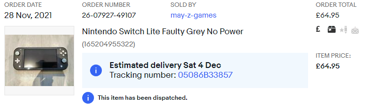

The grey switch lite is missing a whole bunch of components, so far I've worked out its missing M92T36 (power IC), and around it 4x 100k 0201 resistors as well as 3x 0204 1uf 6.3v and 1x 10nf 25v 0201, then it's also missing MAX17050 and a 10k 0402 below it. The device only really has one issue and that was a shorted charge port that will blow m92t36 but somebody went ham on it :D I do think I can fix it though and have all the parts on order. Luckily I had a switch board laying about so removed everything and measured it all.
