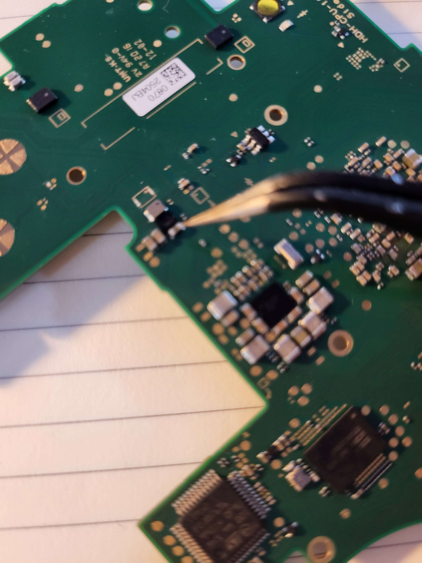

Got some soldering done today - removed a Dualsense thumb stick and replaced it. Bloody hell that was a lot of work getting the original one off! I thought the desoldering iron would make it easy, but not really, needed a lot of braid and flux with a normal iron to get enough solder off to remove the stick without damage.
Clearly I need to improve my desoldering skills. Must’ve taken at least 3 hours in total!

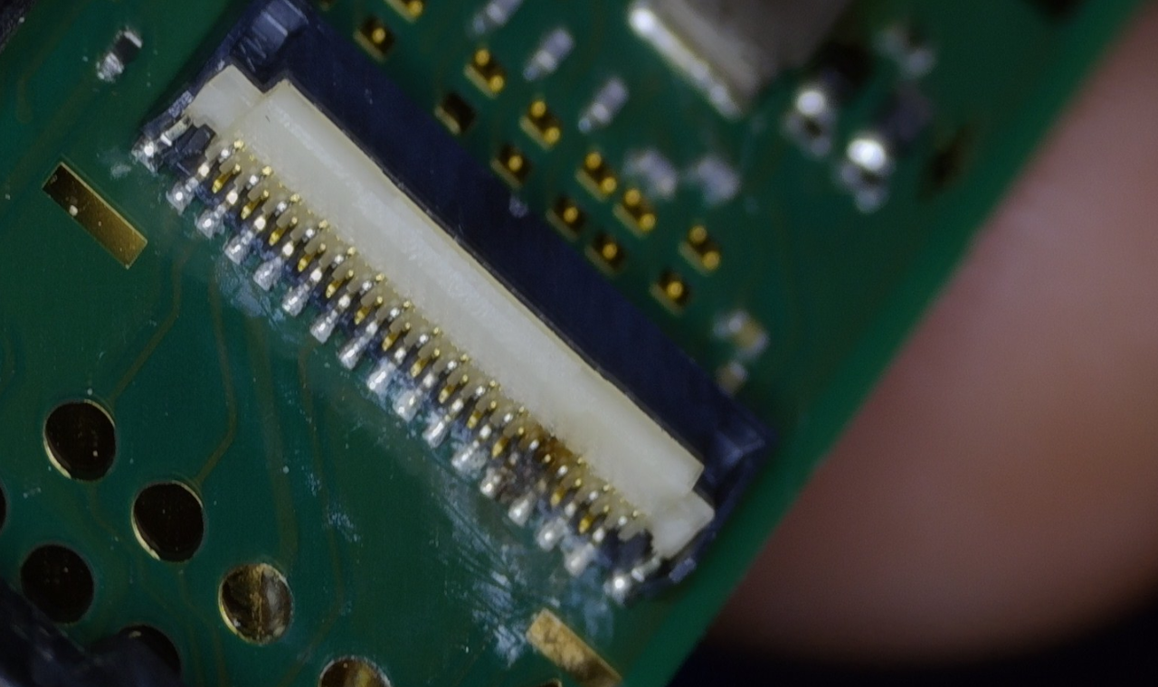

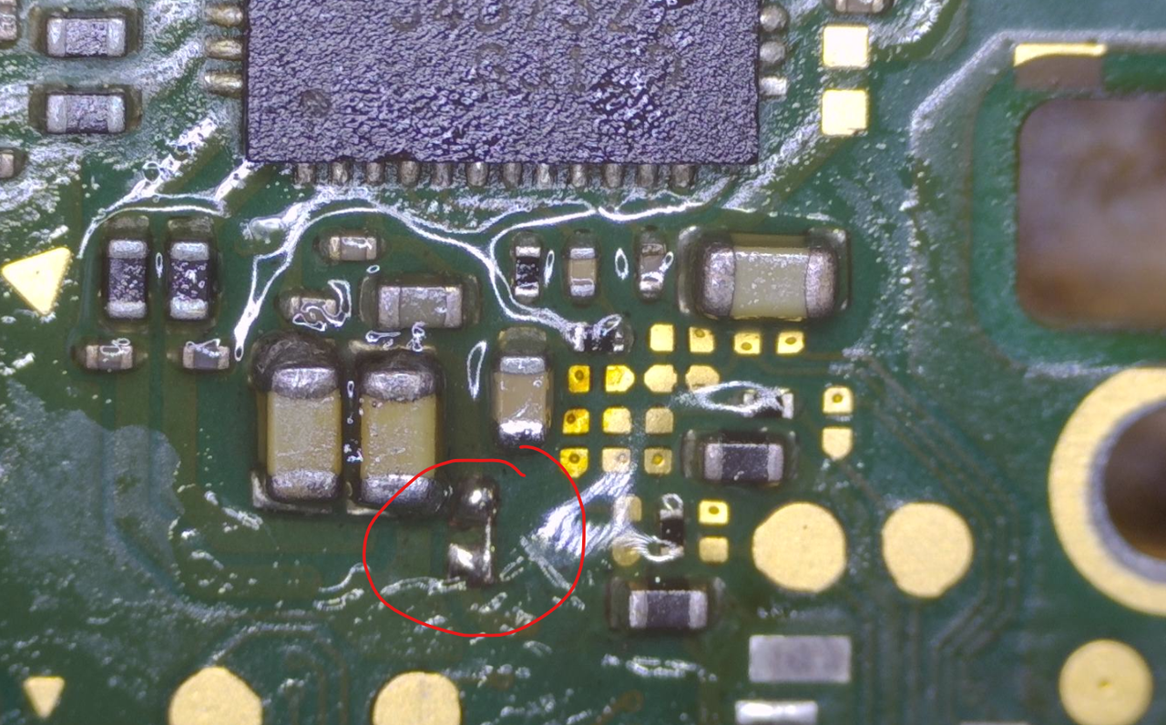

I had a fight with a water damaged switch lite. I opened it up and spotted this on the backlight circuit...
Replaced that and still no backlight so I replaced the backlight driver and then the diode and the coil on the circuit, that got me booting and a backlight so that was like half the job because... no sound.. argh... now the sound circuit is fed from here:

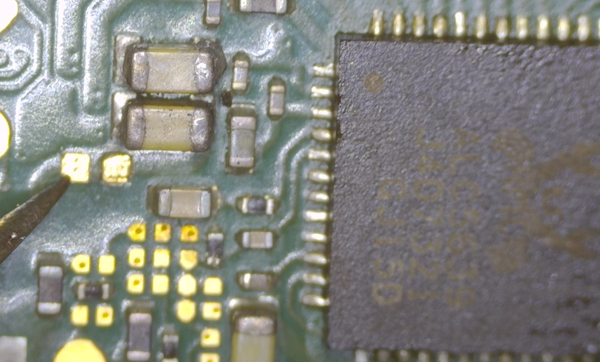

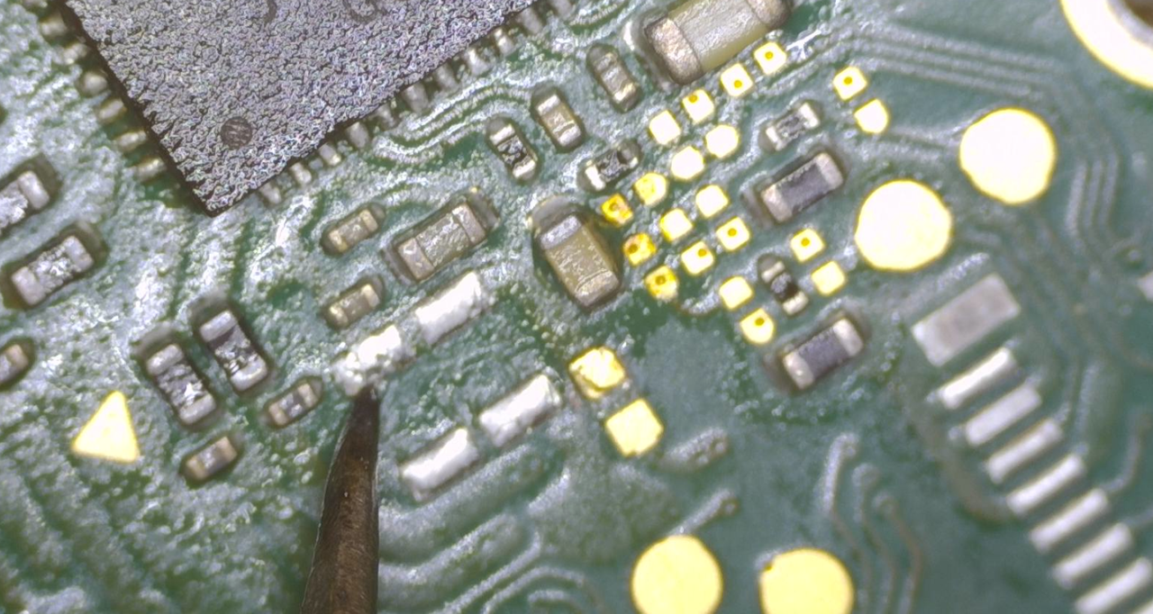

You put 4.25 in and get 3v3 out or the other way around I dont remember but 3v3 was missing so I replace the driver chip for the sound circuit which bought back 3v3 but you know what still no sound, so then I replaced the sound IC which didnt fix it so I had to go digging a bit more... You see these caps south of the sound ic, they should have 4.25 on them but i was getting about 0.5 and being pulled low so I removed them...
As I started measuring back i found a break almost instantly between these pads:
and there is was massive resistance and our issue located! Ran a quick jumper:
Bosh... It lives!!!
I still do a lot of switches and Game Gears I just dont share most as im sure you guys are fed up of looking at them :p I normally put an hour into a switch max but this one took about an hour and a half to diagnose and fix which although not bad felt like a lifetime. I feel your pain on the time it takes. All I can say is with experience things get much quicker.

The trick on these is not to desolder at all but to go from behind with the hot air and just let them fall out :D

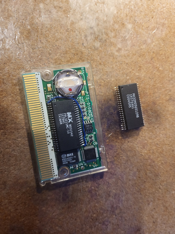

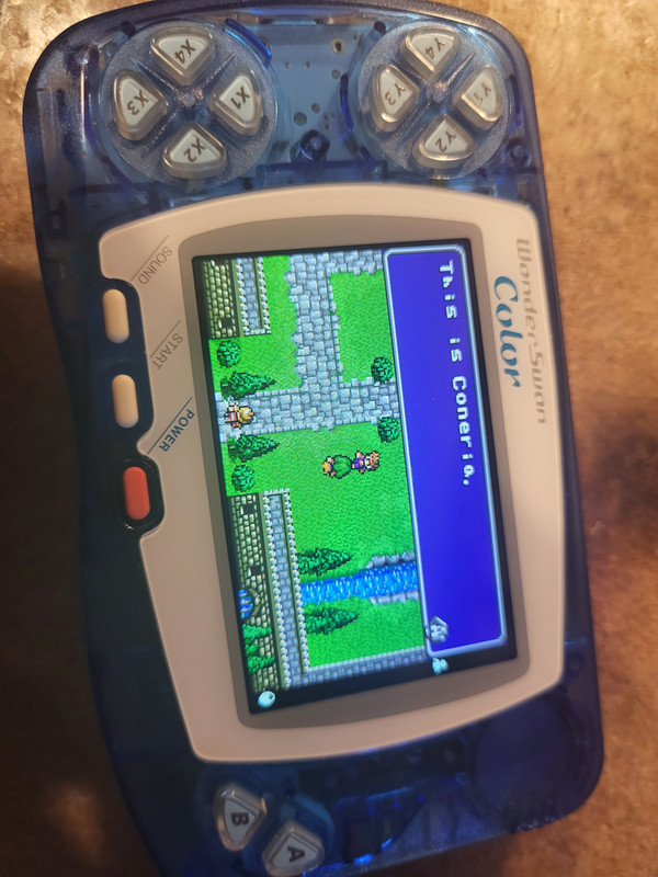

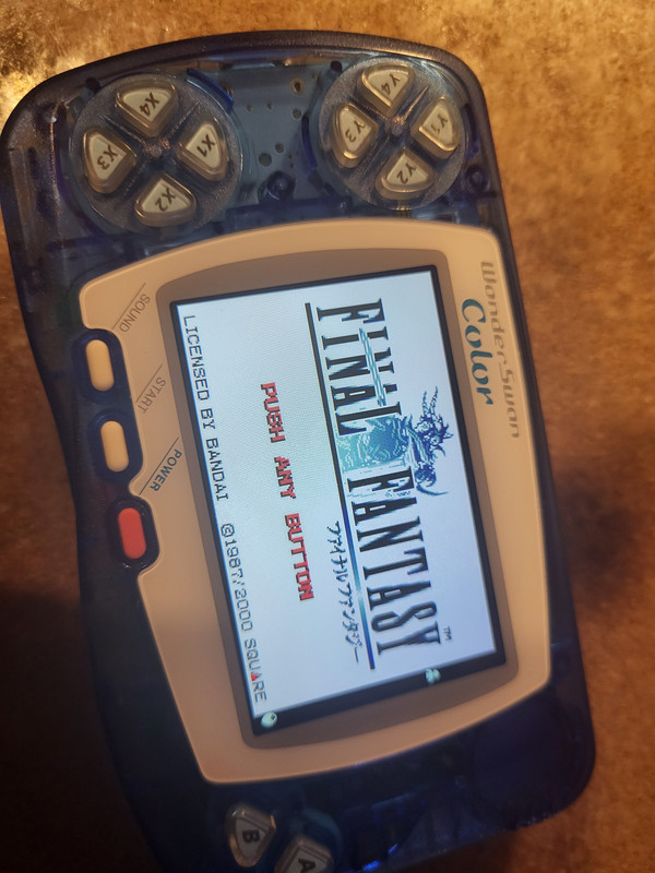

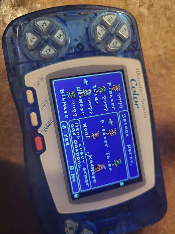

Decided to do a quick swan rom swap..
To the dude who is going through old games doing language translations we salute you!!
Guessing you need a hot air station for that…and it just works with those thumb sticks without anything fancy, just decent flux? If so I’m sold, has to be worth getting one rather than spending hours painstakingly removing all the solder with braid…would probably pay for itself quickly too, given the amount of braid I go through! :D
Yea ive been running the same £35 rework station for about 5 years :D Does brilliant tbh. It's an 858D
