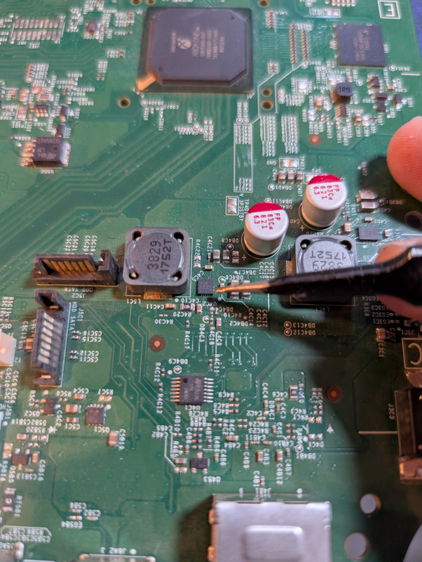

No power at all one was fun! Had to dig around loads but eventually found a little 5v regulator that had a short on an output. Swapped it out from a donor board and....
This was the little regulator that failed:

Excellent as usual! How on earth did you troubleshoot that one? Awesome
Well I measured all of the inductors (good place to start) and they all looked good checked 12v rail, all good. Standby voltages were all present... So it was a secondary voltage rail. So I then had a little measure around on rails that would be activated on boot weirdly that buck was one of the first things I measured
I measured a 10ohm reading on an output cap, compared that against a donor and it should have been 25k. Pulled the chip, wacked a new one on. As soon as I popped in power and the fan did a little dance, I knew, I knew we were golden :cry:
That’s awesome! Did you do all of that whilst connected to your bench power supply, or with no power at all? Still can’t really get my head around this troubleshooting, so please excuse the silly question!!
Just testing all the main power rails for shorts etc was all done without power then I put the bench supply to it to check standby power and probed all the standby rails. When they were all present I removed power and went hunting for shorts on the secondary rails. Seems to work quite well.

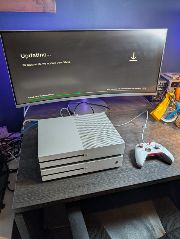

Fwiw that was the last one, all 8 machines are now up and running.

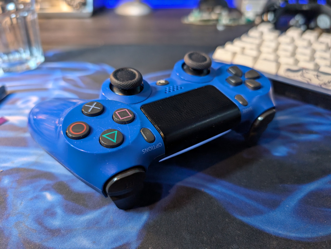

Ive got tons of them here, nice blue one ive just put some halls in :)
