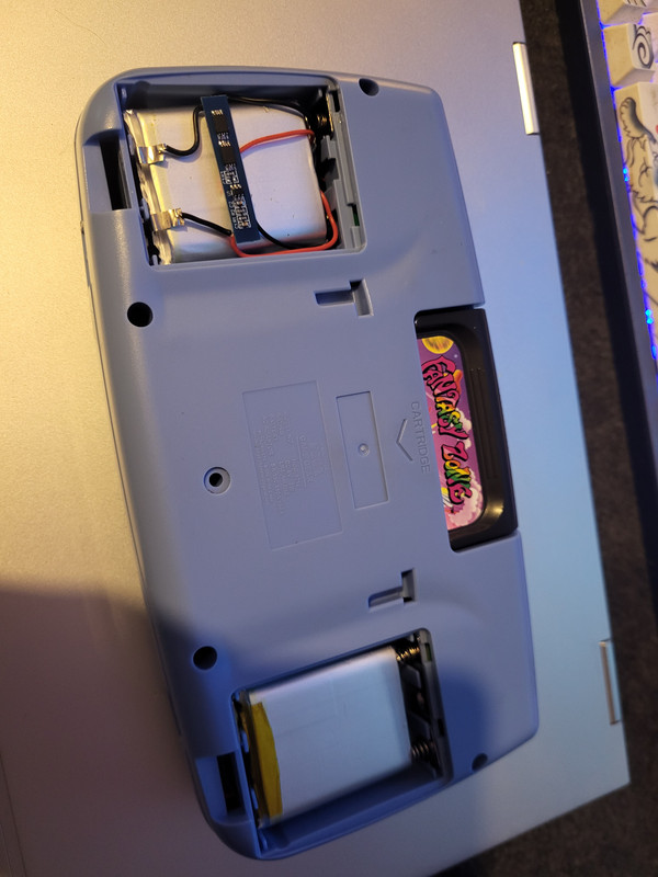

A stock Game Gear will melt a set of batteries in an hour, my modified GG (removed the 34v circuit and the whole GG runs off basically 5v) will last around 7 hours on a set of batteries while having a far superior screen.

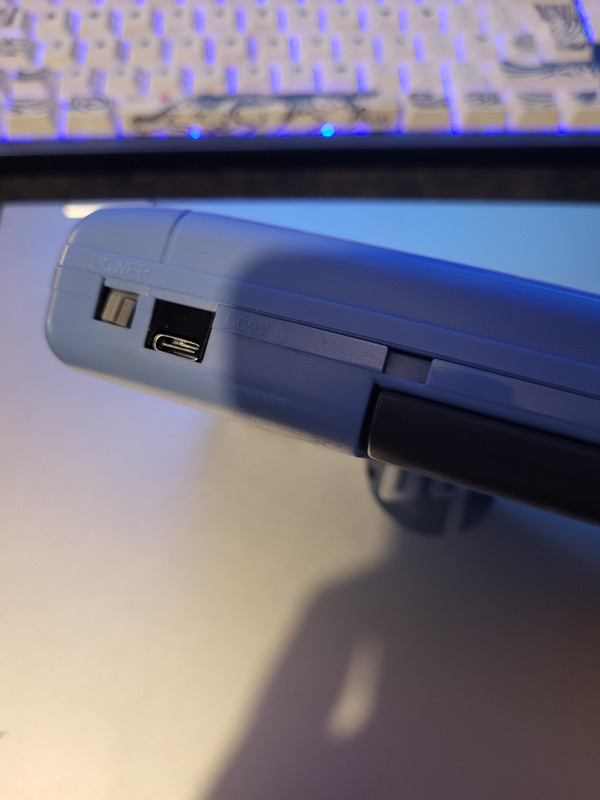

Mine has lipo's and a usb-c charge circuit.
Like this (104050's 2x 2000mah in series using a s2 board)...
I wouldnt give a customer one back like this.. Id normally do a load of work on the batteries making them not look ghetto. There is one in this thread somewhere with a "customer version" of this mod.

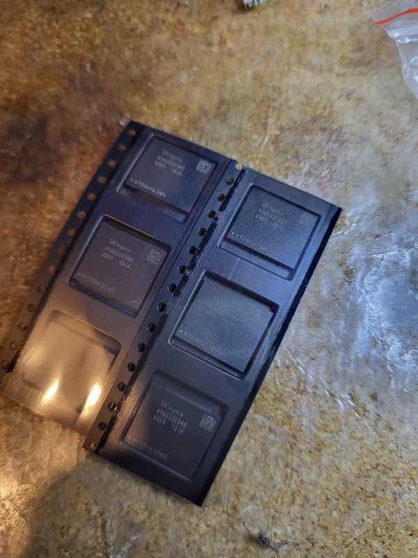

If you guessed 6 gddr chips from the fella in China for your 1660 or whatever it is you would be absolutely correct :)
Will slap em on it and give it a run in over the next few days. Dude even sent the correct ones first time...
No stencil yet for the other card but sure that will be here soon.

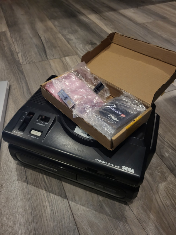

Loads of send in's appeared today including a Megadrive (for tripple bypass) & a mega CD that crashes on bios screen :) - Loads of mod kits sent with them... should be fun!
Not sure what that means, but sounds in-depth!
It basically removes all the audio and video signals off of the motherboard onto a separate board and provides a ton of upgrades. It basically provides the following:
  • Uses the latest THS7374 amp and uses bypass circuitry to improve RGB signal clarity.
  • Utilises the Mega Amp 2.0 audio amp which vastly improves the audio compared to stock.
  • Jumpers which allow you to choose between many audio configurations.
  • Audio optimised with the MDFourier project to match the best audio quality that comes from a new Model 1.
  • Low-pass filter toggle.
This is for the same guy I did the 32x, master system and Nintendo Switch for a few weeks back... looks like I am slowly working my way through his collection fixing it up and putting in all the mods he would like :) The 32x is already set up ready to accept any mods he decides to put into this and will auto swap regions based on whatever signal it receives. He has also provided a multi region bios chip with the mega CD :) :cool:
The flash cart is also here to be unbricked..
