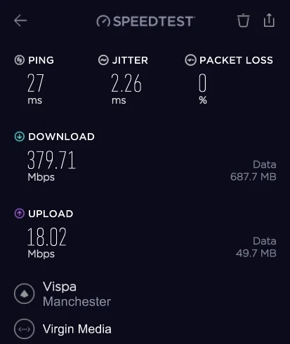

Using the bare naked VM350 connection (speedtest.net app to Vispa server):
Two clicks (Edit allow LAN rule, change output gateway from VM to VPN > Save):

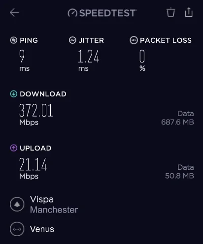

Using my preferred VPN gateway (speedtest.net app, to the same Vispa server a moment apart from the first test):
Yes, you read that correctly. Yes, it was 'peak time' when the tests were undertaken. No, I haven't made a mistake with the labels (check the source network in the images for proof).
With the VPN enabled (AES-128-GCM) my pings to the same server from the same LAN machine (desktop PC, specs in sig) have gone down by 66%. :eek: Jitter is improved by 50%. Speed is barely impacted outside of margin of error. No leaks, DNS working properly, policy based routing pushing everything to the right place both LAN and WAN side. Job's a good un... Until I decide to tweak something else. :D
