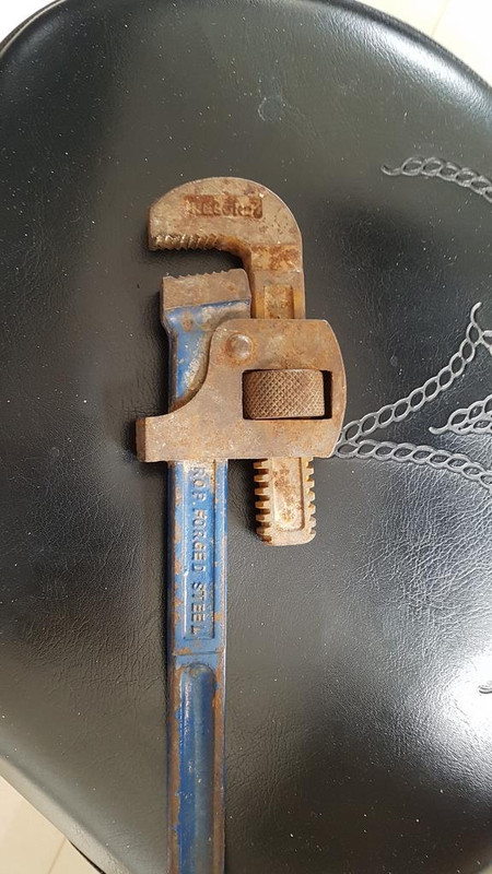

You just need a pair of grips to get it started.
https://www.toolstation.com/stanley-fatmax-groove-joint-waterpump-pliers/p65978

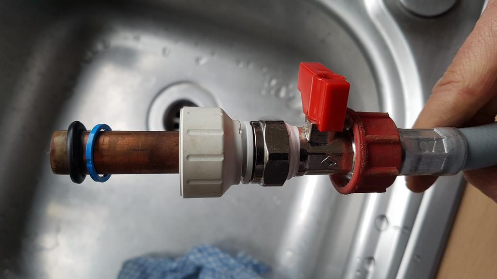

you need to also grip the body of the valve, even if you buy waterpump pliers .... which should be in everyones toolkit mine are bachoBut I can't turn the red wheel to disconnect the hot water pipe.

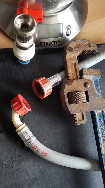

I've now removed the whole valve and am using my large heavy pliers but can't make it budge. I can make the valve attachment turn but not the red wheel.

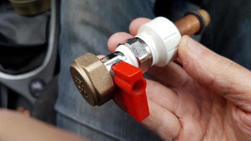

I removed the whole hose, seemed easier undoing the red wheel on the machine end. I think I need 3/4" cap to go on that valve.
Then yes that brass end cap is what you need. Take it to screwfix or wherever you're off to double check thread.
