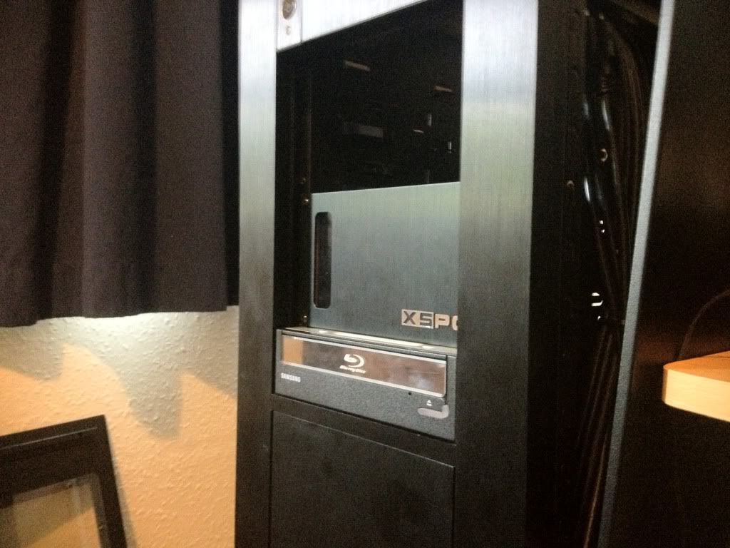

Thanks m8 I'll have a look online for one . I've installed the CPU block, both gpu blocks and slide in the res/pump does yours come up flush with the front panel? Mine is just off.just leaving it now until I've got the 240 and a dremel and spoke to oc's about the bridge issue :(
the pump/res is perfect flush. Only use 2 screws on small orings so I get no vibration and a little movement to bleed it. I tighten them up slightly and then its sturdy.
What is in the bay under the res? I put my dvd drive directly under it as the O ring overhangs the body on the base
Heres the front if i push the res pump forward it would at some point just fall out
what am i doing wrong???
thanks m8 when i do that will it look flush with the front panel as the blu ray drive does?

Yeah cut the hole and got a 240mm radiator grill. The hole I cut is big enough so the fan mount holes are within the cut out. I used some super tacky foam padding about 2mm thick to secure the grill in the bottom and mounted the rad to it with the screws from underneath. If you google it I pretty much followed the vid instruction
