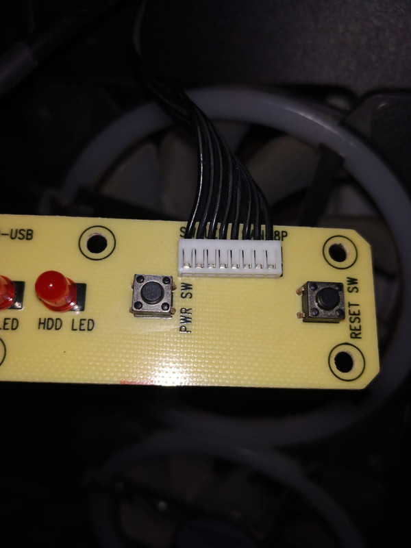

I can't work out how to remove this from the circuit board, it looks like the pins have been removed from the original block connected and then pushed into this?
Looking at images of this PSU all of the plugs are black. Where as this one is white?
(Just trying to add a pic)
See the little plastic clip in the middle of the connector in the image from the video, squeeze the top of it (it releases a lock) and then pull the whole plug up. The connectors can be black or white, don't worry about the colour.
You have to compress the plastic lug thing which is like a lever. In the thumbnail of that youtube video it's at the BOTTOM of it where you would press, but that is orientated upside down. With it in place plugged into your motherboard, you need to be compressing the top part of it (furthest away from the motherboard) and then pulling it quite hard, rocking it back and forward from side to side to get it out. You can grab the handful of wires going into it to help pull it out.

Sorry i meant if I replace this PSU. How do I remove the pins (as in the picture above) from the power switch?
Sorry Amy, not sure I understand you. You aren't removing any pins you are just testing the PSU connector with it disconnected from the motherboard by creating an electrical short with a piece of wire to fool the PSU into thinking that it is connected to a working motherboard.

I've jumped ahead thinking If I do have to replace the PSU how do I even disconnect that? (my picture above)
It's possible you have just water damaged the area you posted a picture of which sends a signal to the main board (motherboard) which in turn, turns the actual PC on. There is a bypass you can do manually using a screwdriver to get it to turn on, but that's difficult to talk you through without showing you pics in detail.
