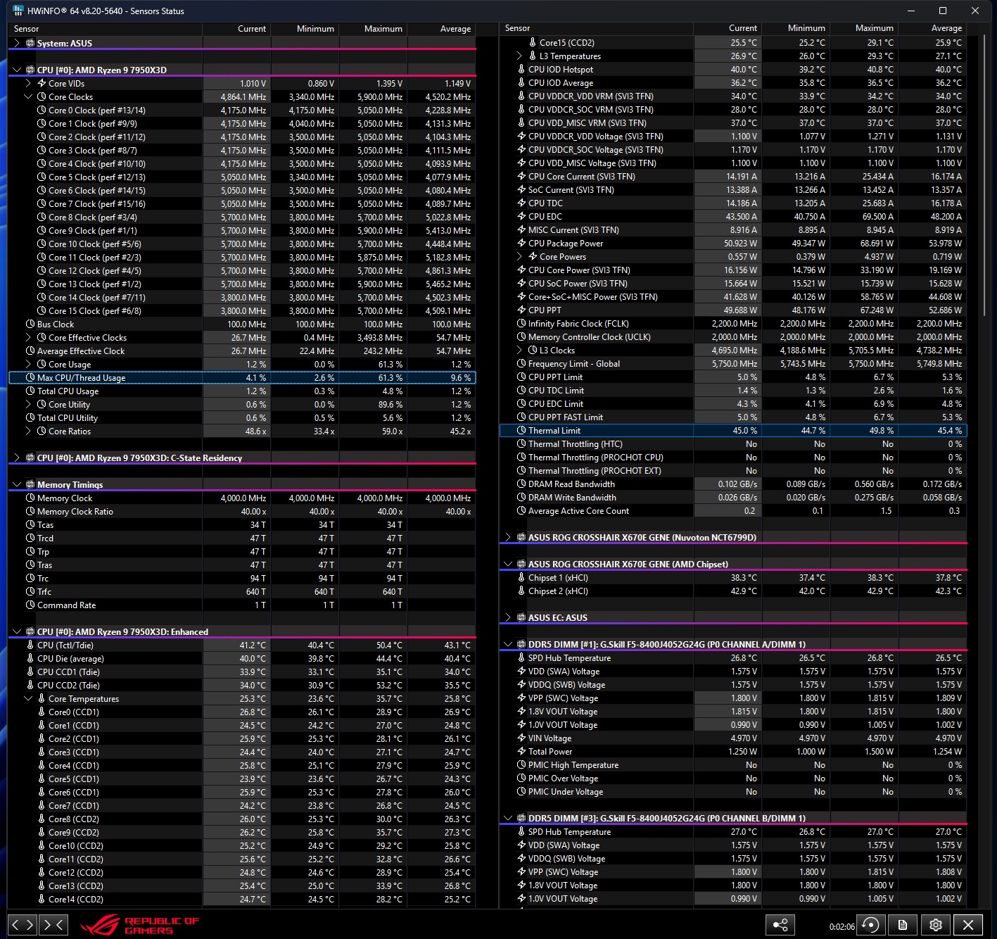

Build and mod is pretty much finished, this Mo-Ra 200 is very impressive, im just waiting on a barrowtech digital flow meter to add into the loop to arrive, the run ended up going front pump/ res to RAM, then out to the Mo-Ra to cool the water, then back into to CPU, finally back to the pump res at the front of the case, PC has been on all night and came down to these temps now all the micro bubbles have gone.
