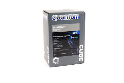

I don't think Quantum meets the 505.01 spec, the PD engines cams are quite sensitive to what oil you use. I doubt it would be noticeable during my ownership, but might as well stick to manufactures recommendations.
The cams can wear away with the wrong oil
tbh haven't tried the quantum as mine seems to like the castrol so i cant say how good it is , its just with vw/ skoda garages stocking it got me interested
i think this is the quantum with your spec
Ceramic coated the 350Z today then went out for a blast with the daughter top down over to Betswy then over to Llangollen and over Horse Shoe... ahhh what a nice day!
Quantum platinum plus meets 505.01 and is recommended for PDs
Leant this the expensive way. After 50k miles of servicing my old PD Jetta with Shell Helix ultra 3 out of 4 intake lobes were round and wore through the lifters
True, double the price I paid for Mannol. :p
