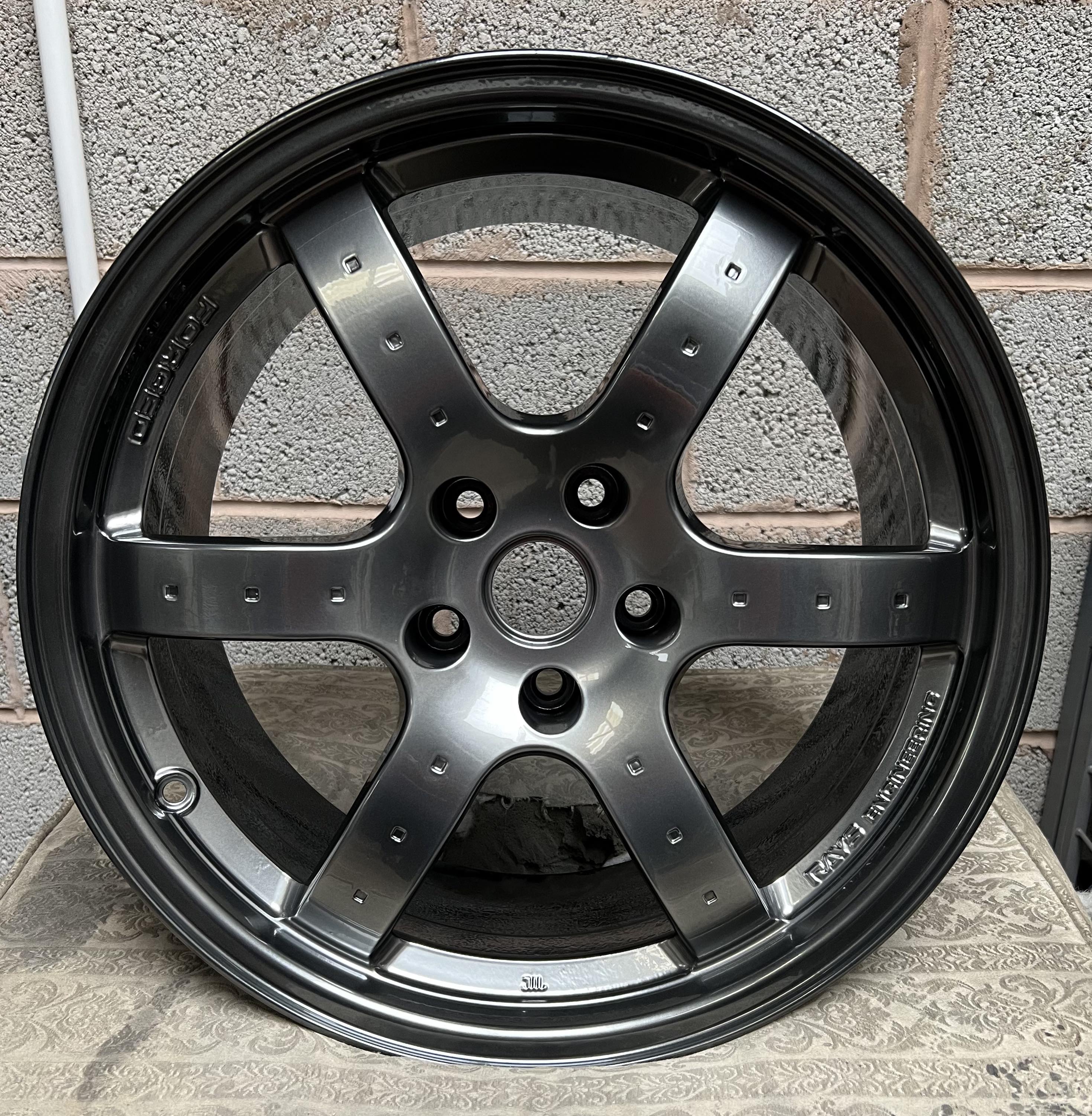

Time for repairs and a "shadow chrome" finish... on the 350Z wheels... stripped and being treated... hopefully complete in the next day or two!

All finished... lovely stuff...
Stripped back to metal using the latest Environmental friendlier Stripping system
Fully steam cleaned
Gently Surface blasted
Fatigue treatment to slow down the corrosion.
Cnc lathed to remove kerb damage
Fully steam cleaned and left to cool down
Heat treatment cycle
De gassing stages
Powder coat primer ( epoxy )
Painted in the factory colour ( water )
Powder coat lacquered ( Acrylic )
Oven baked and left to cool down
Apply ceramic coatings for extra protection and easy maintenance.
Tyres re fitted and re balanced using Hoffmann OE powder coated weights.

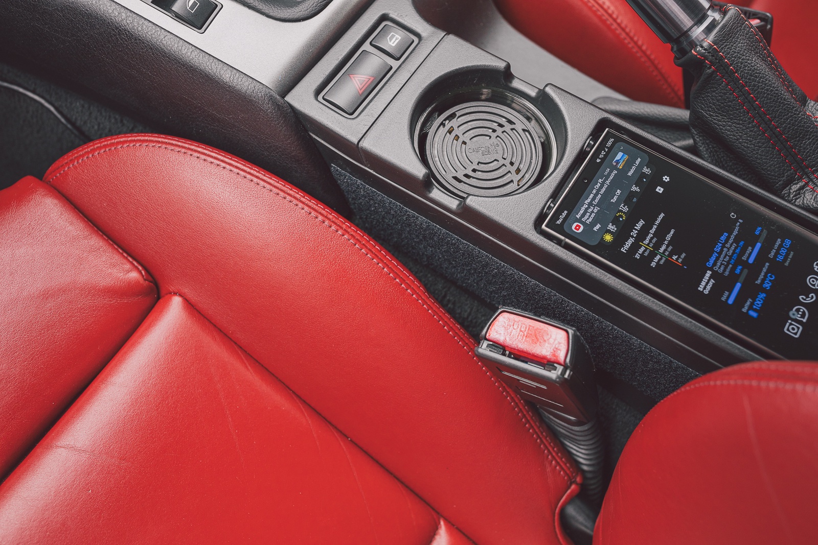

The passenger seatbelt bit rubbing against the centre tunnel trim has scratched it over the years and it got annoying, so applied a sticky back felt strip to cover it up and prevent further escalation.

Next to do, headlight lens restoration? :D
