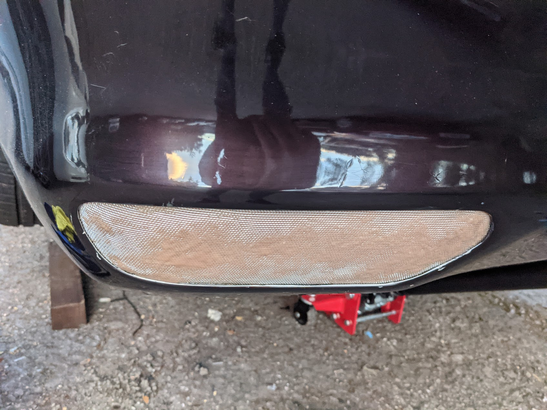

EDIT:
I've used it to fill-up a cut out in my bumper in the past and recently did my mates daily to get it through MOT (I didn't take photos).
Youv've any photos?
You could do a DIY repair yourself saving over £200.
EDIT:
That would pass the MOT but not fix the structural issue they'd be failing me on... It'd buy me time but I need to get it welded either way.
It's not a crucial body structural part, you could literally cover it with anything and it would pass, the tester can't remove e.g. duck tape and can't fail you on what they don't see.

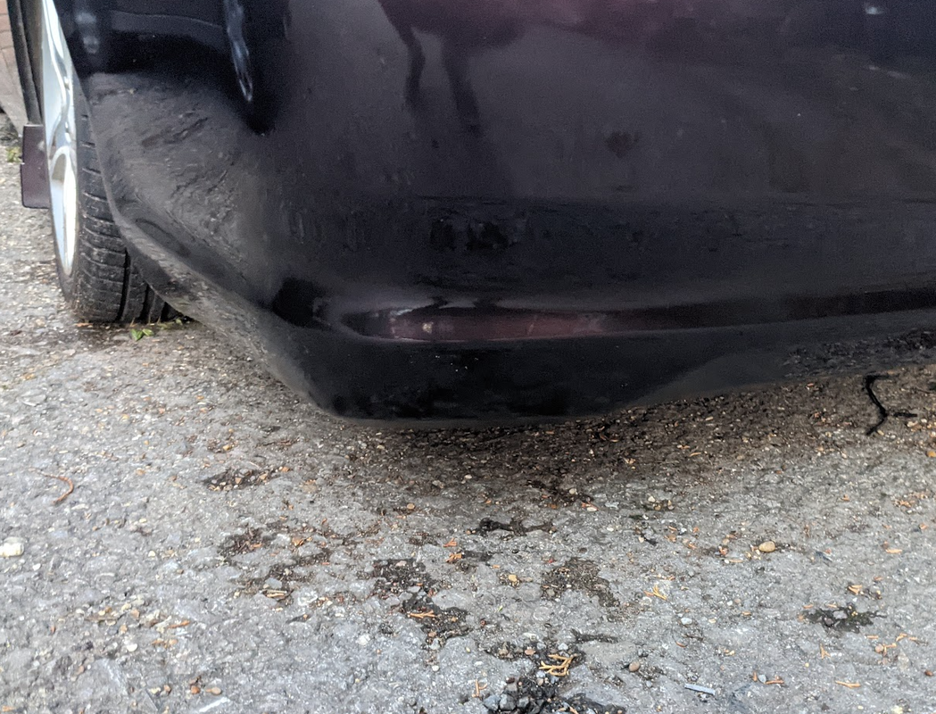

So things got much worse...
Spoke to a welder and agreed to go there 8am tomorrow for a look. After work I decided to take off the body trim there so it's ready to work on.
I started poking at it and... Let's just say it's not just the sill end that's rotten. I felt underneath towards the inner edge and whole pieces were coming off in my hand. This is the end result after I poked and pulled off everything I could by hand:
About 70% of this rubble came off the car, some of it is just loose tarmac bits from my deteriorating driveway.
And as a bonus, I thought it'd be wise to check the other side and poked a hole in that! Not nearly as rotten but definitely needs looking at.
How on earth this wasn't even an advisory last year I don't know. Same story with my MG really. Went from no advisory to fail.
