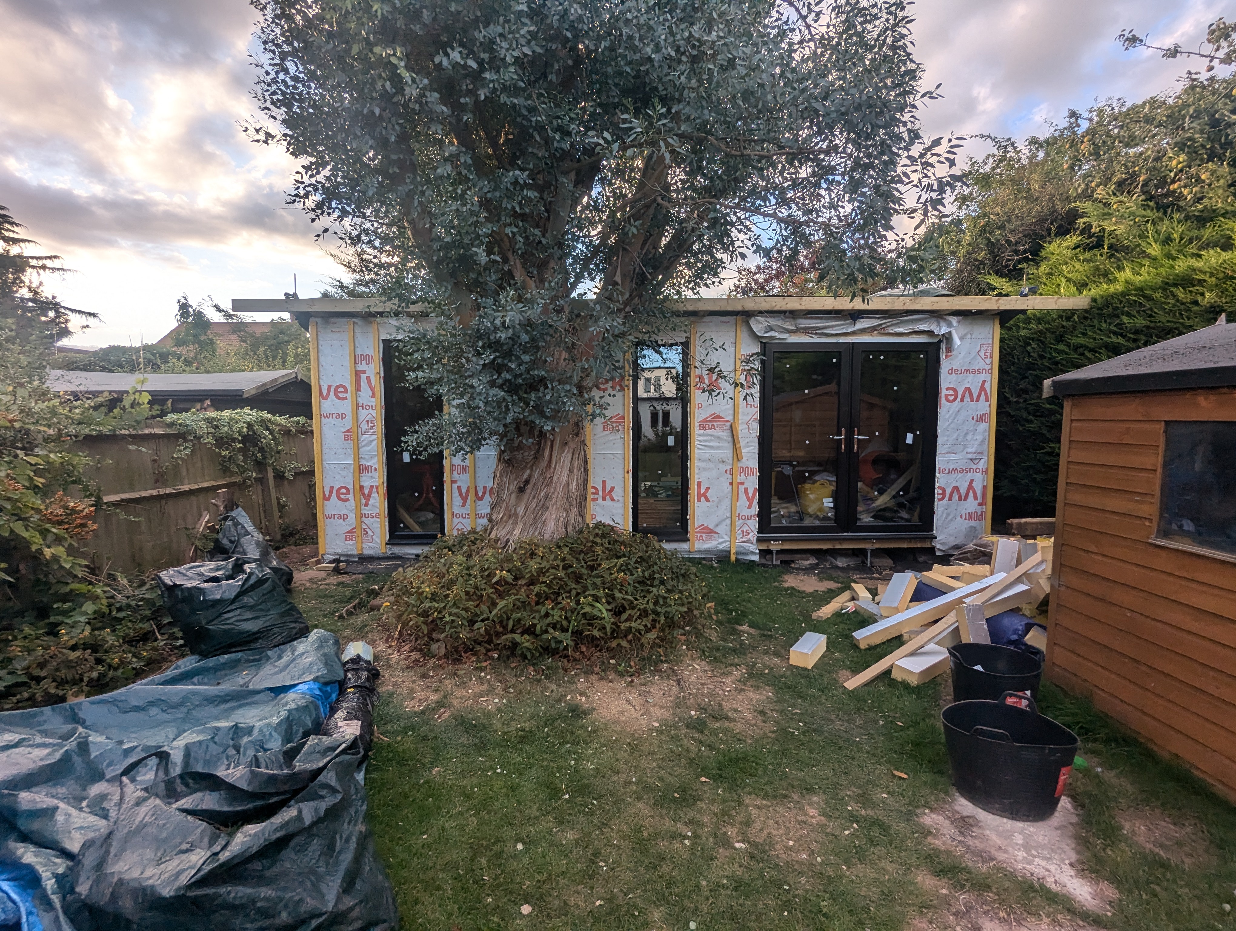

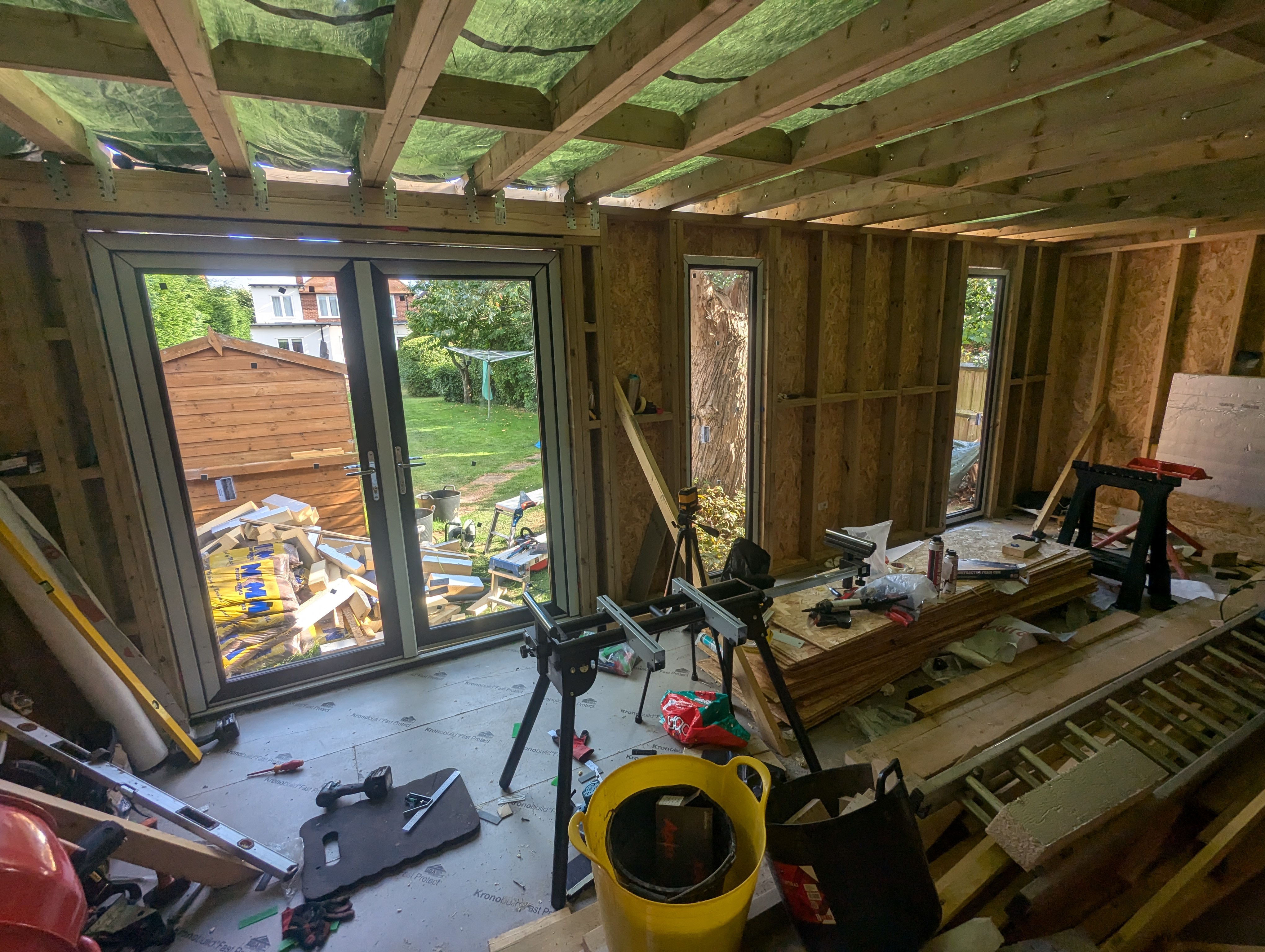

I think you can stop calling it a "shed" now, it is a housePut some doors on my shed
