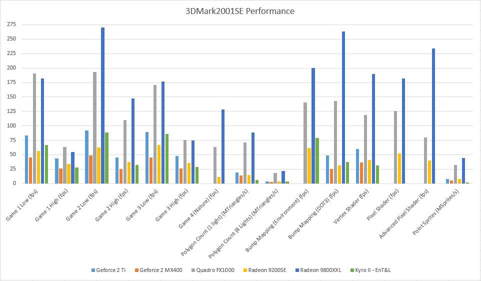

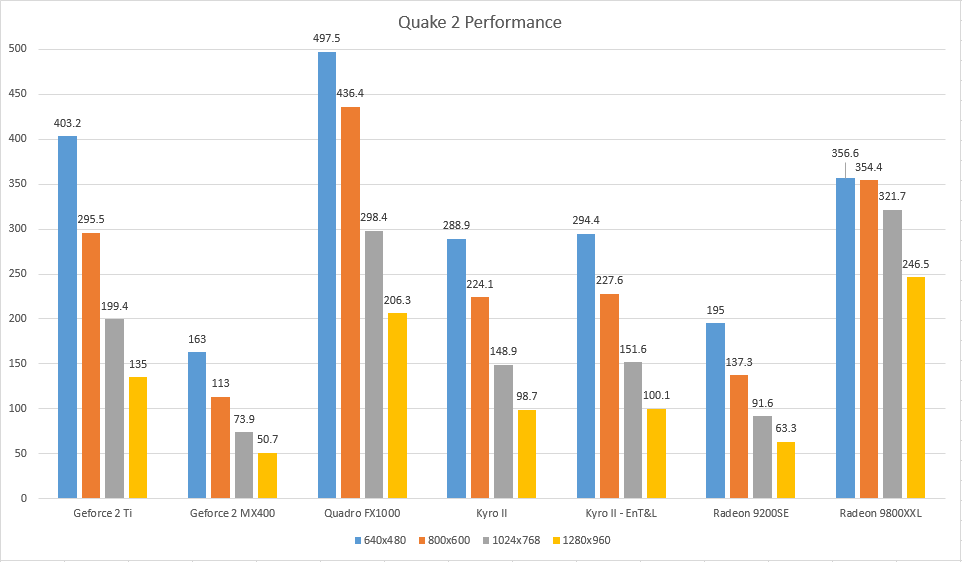

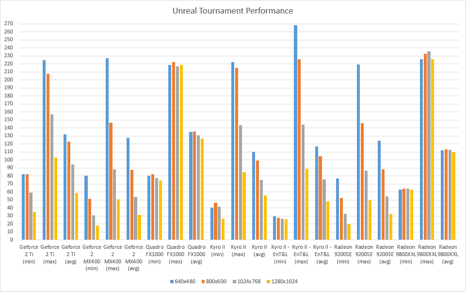

So here are the benches (finally). I added some additional cards into the mix to see a) just how gimped MX GeForce cards and SE Radeon cards were, and to see how much a couple of generations moved things on. I'm rather annoyed that I had to substitute in my Quadro FX1000 (GeForce FX 5800 equivalent) in where I had planned on using the GeForce 4 Ti4200, but the Ti4200 appears to have bad RAM :( Going to source some RAM and do some surgery I think!
Machine spec was:
Shuttle SB51G (Intel 845GE Chipset)
Pentium 4 2.8GHz (533FSB variant) @ 3.15GHz (600FSB)
1.5GB DDR 333
Forceware 61.77 for all nVidia cards
ATi 6.11 for the 9200SE
ATi Catalyst 10.2 for the 9800XXL (9800XT OEM)
PowerVR 1.05.15.0084 For the Kyro II without EnT&L
PowerVR 2.02.22.0033 For the Kyro II with EnT&L (Software TnL presented as hardware TnL)

@paradigm That's quite an extensive set of tests you've done there, didn't expect that! So looking at the Kyro scores, it's somewhere between the GF2MX and Ti for the most part. It does quite well in Q3 by the looks of it. Given the limited horsepower the card has it's quite impressive in how it fares IMO.
Interesting that the Radeon 9800XXL can do 287FPS in Q3 at 1280x1024, yet only 246FPS in Q2 at the same resolution! Guess that's indicative of ATI's OpenGL support at the time though.
Agreed, although for the most part the Kyro II is closer to the performance of the full Geforce 2 than the gimped MX. It does really well in real world gaming though that said I can’t explain why the v2.02 driver has such poor minimum framerates in UT. The older 1.05 drivers were far more playable even if the maximum framerates and average framerates drop ever so slightly. I think overall the difference between the EnT&L capable drivers and the newest V1 drivers isn’t worth the effort unless you are specifically needing to trick a game into believing you have hardware TnL for compatibility reasons.
The Quadro and more obviously the 9800XT(XXL) were massively CPU bound in some instances, especially in UT, but also in Quake 3 for the 9800, the framerate simply didn’t change between resolutions.
As for the Q2 vs Q3 performance on the 9800, ATi were never quite as fast in OpenGL compared to nVidia, and Q2s implementation of OpenGL is quite “rough”.
