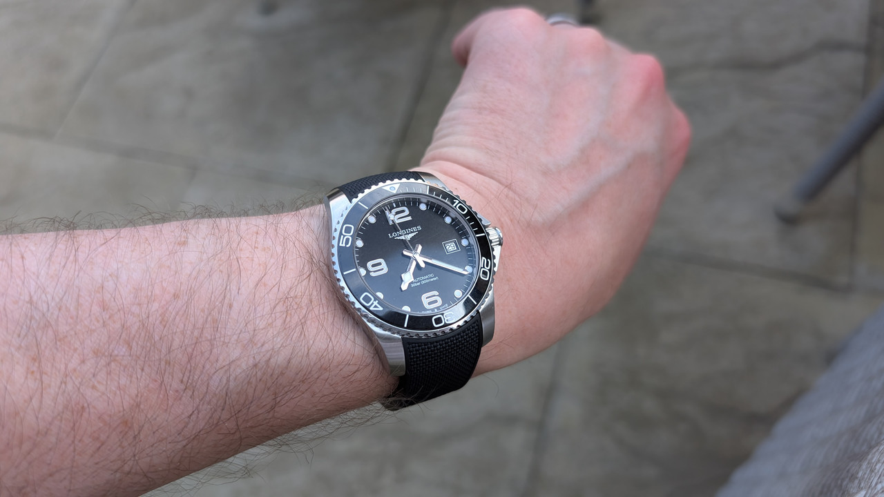

Visited Vacheron boutique on Thursday, tried on a Dual Time Overseas and a 222. Both lovely watches, the 222 in steel is gorgeous.
Looking at a few brands in this price bracket for a significant birthday present to myself in a couple of years.

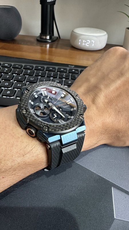

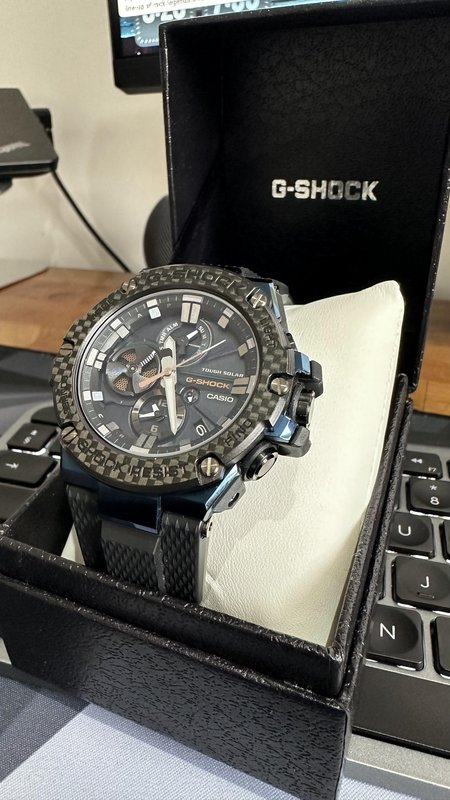

My work Mudmaster has had about as much abuse as I can throw at it (pusher fell off, second hand fell off, and it's a bit bent), which a bit disappointing as my other work watch, a G-Shock GW-A1100FC has had more abuse for longer and is just fine..
So anyway I bought this to replace it, which may have been bit of a mistake (drunk shopping), guess I'll find out soon enough..
Do you still have this?
I fixed one today randomly, and I could likely fix this for you too?
