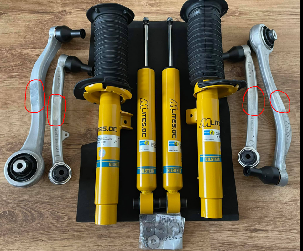

I'm having M4 lower arms and Bird's Bilsteins fitted on the 28th to hopefully fix the dodgy handling

@IC3 have you fitted the LCAs yet?
I have just with some ‘fast road geometry’
Turn in is fantastic but I seem to get some horrible vibration/chatter over rough road surfaces and wondered if this was a consequence of the setup of something wrong ?
Do you've the Tension Struts as well? What's the mileage on the car? Is it lowered or standard suspension (Adaptive?).
I think it might be the stock TS, the bushings could be shot and M4 LCA's stiffer bushings will just make that more apparent.
