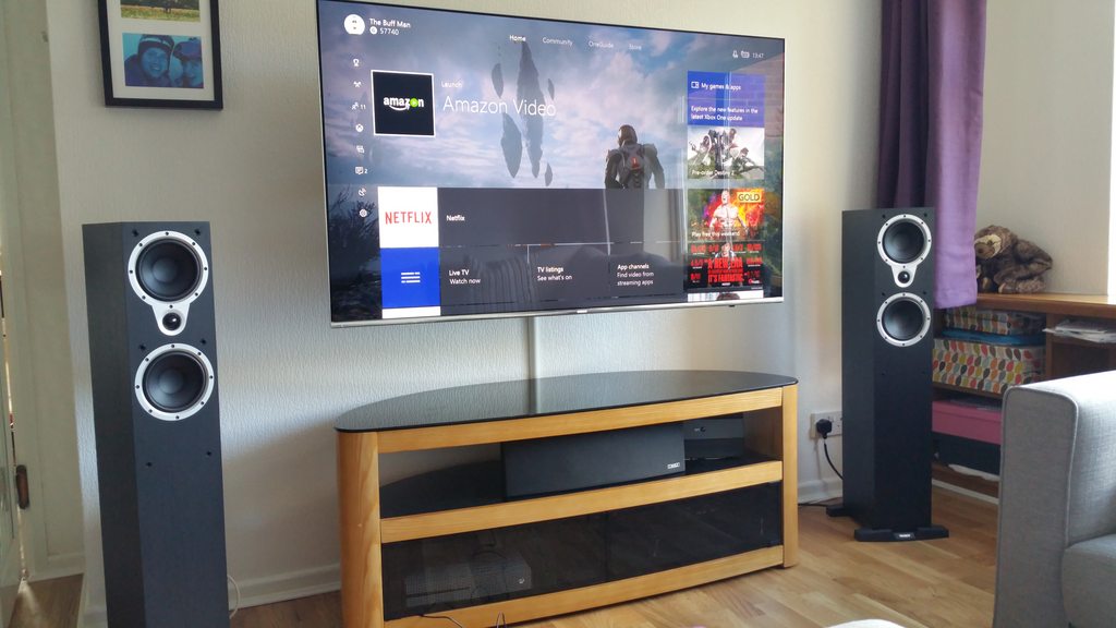

Some pics..

Thanks for the pics. The bracket looks pretty beefy, I prefer the look of the slimline fixed ones I've seen I think to be honest.
How do you find the TV though? Is yours the 55" or 65"? How many cables do you need to fit in the trunking you've fitted to the wall, the TV comes with a junction box I think so perhaps only power and the junction connector?

Yeah could just pull it back to not see it. I'd rather it beefy just so I'm confident in the TV not breaking off the arm! Must be the engineer in me wanting it over designed..
Yes it's just the power and connect box cable (could use thinner trunking if I was bothered.)
If I recall correctly however, the lan network cable is also in the back of the TV rather than the connect box (I just use wifi)
Yeah I'm very impressed with the TV, it's the 55", I wanted the 65" but it was like £600 price increase. Use it for gaming and netflix/amazon. Not even seen a 4k blu ray on it yet, but even 1080p sources look better than my previous 42" 2014 sony (w705)
