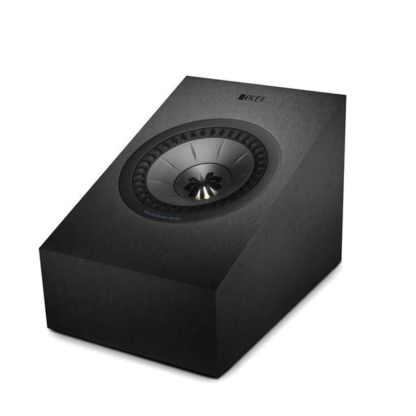

One option could be using atmos speakers since they're angled down already so will be a neater install, you do want the speakers angled to the listener . Again lacking in bass and typically not used as left/right speakers and sort of thing you'd need to dem
