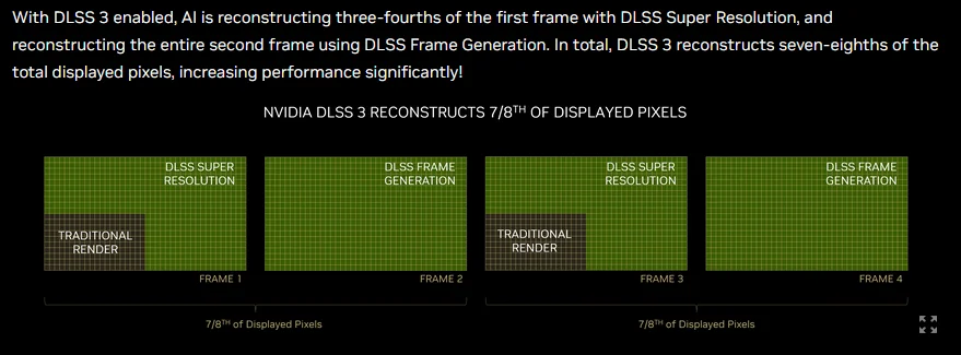

It calculates based on 2 previous frames to predict a new frame, not in between two existing frames, according to their description here.
so if you move your mouse 1 pixel, then 1 pixel more and stop Nvidia will move your mouse 1 pixel again before realising it is in the wrong place.

Suggest you go back and read that again as that's not how it works. It interpolates between the current and previous frame to insert a new frame in-between the two. Therefore the current frame has to be delayed so the newly rendered intermediate can be drawn on screen first. This is why it operates in conjunction with reflex to minimise that latency hit.
Have a look at Nvidia's diagram:
The generated frame comes after the rendered one, not before it.
