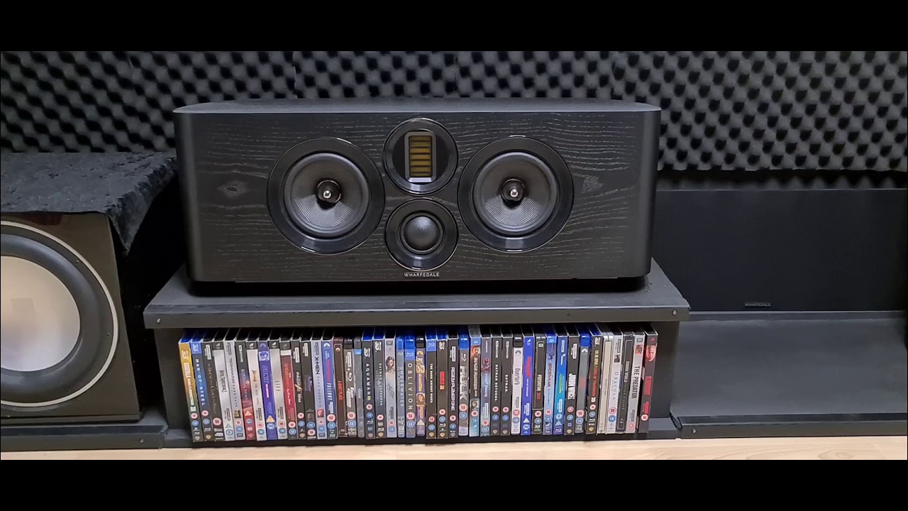

Also consider the large center, as it's most important speaker in HT.
Yep, it looks a beast! I have my eye on this to match with the Evo 4.4. Think I will notice a difference from my Diamond 9.1s lol?

The EVO 4's arrived today :). Got them all setup, and calibrated with Audyssey. Very happy, the quality of the cabinets and speakers is amazing. I was not expecting much sound difference, but these are much better than my Diamond 9.1s, much fuller and more clarity and detail. I feel like I was missing sound before after listening to these lol. I have also noticed running these at -20 from reference is so loud, before I would have to run -10 for similar volume with my 9.1s. Trying to be careful with volume so they do not clip or anything like that. But yeah, super happy! Thanks everyone for the help and advice!
