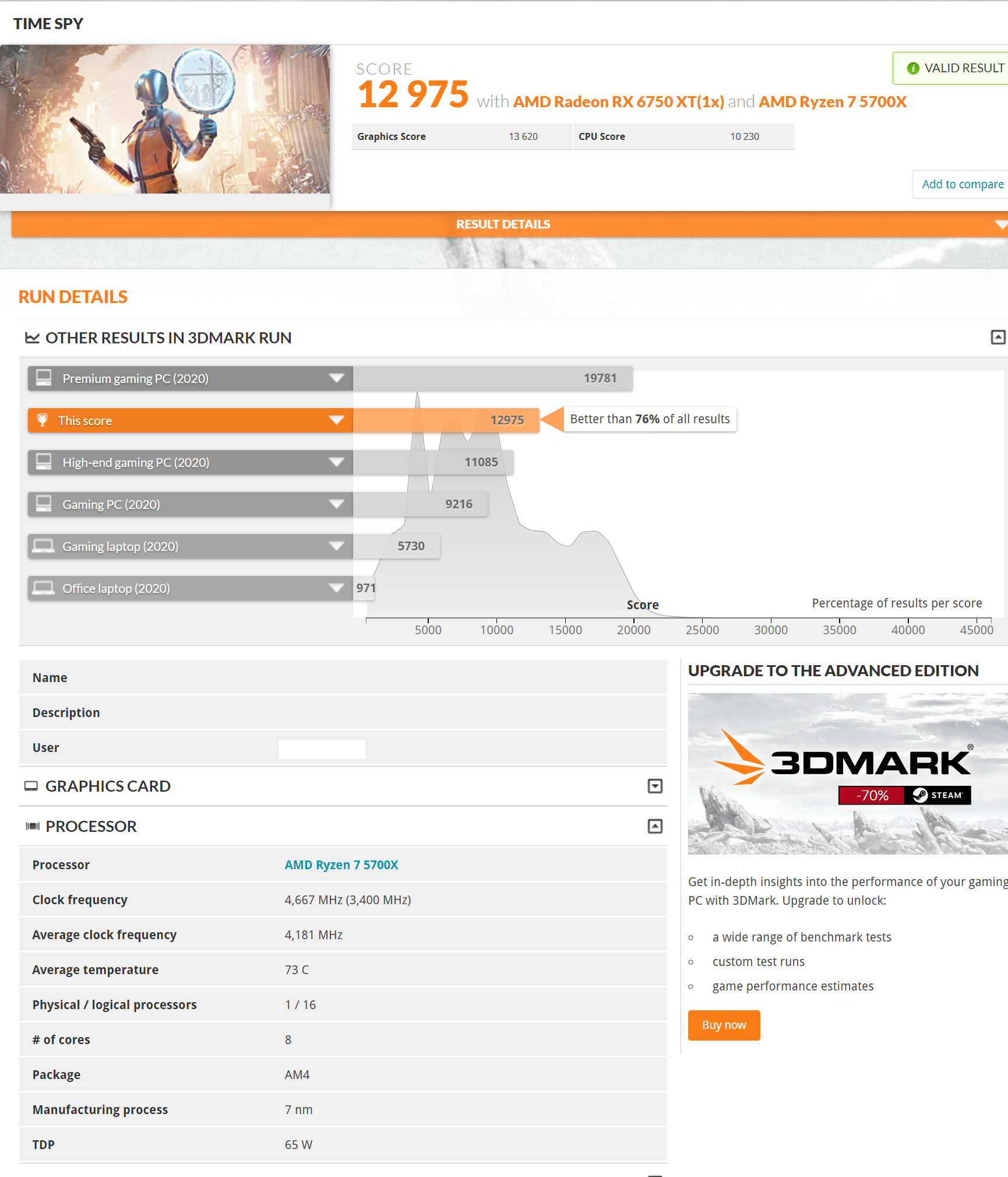

I installed my new 5700x yesterday using the Wraith Stealth Cooler. Looks like it boosted to 4667 MHz when running 3D Mark...
Sounds about right. How noisy is it?
that going over the stated max boost, all be it for a short time but still id be happy depending on the noise and temp. you should test with Cinebench R20 for a few loops run it 4 or so times, that would show if it holds the boost clock or if you have temp problems.

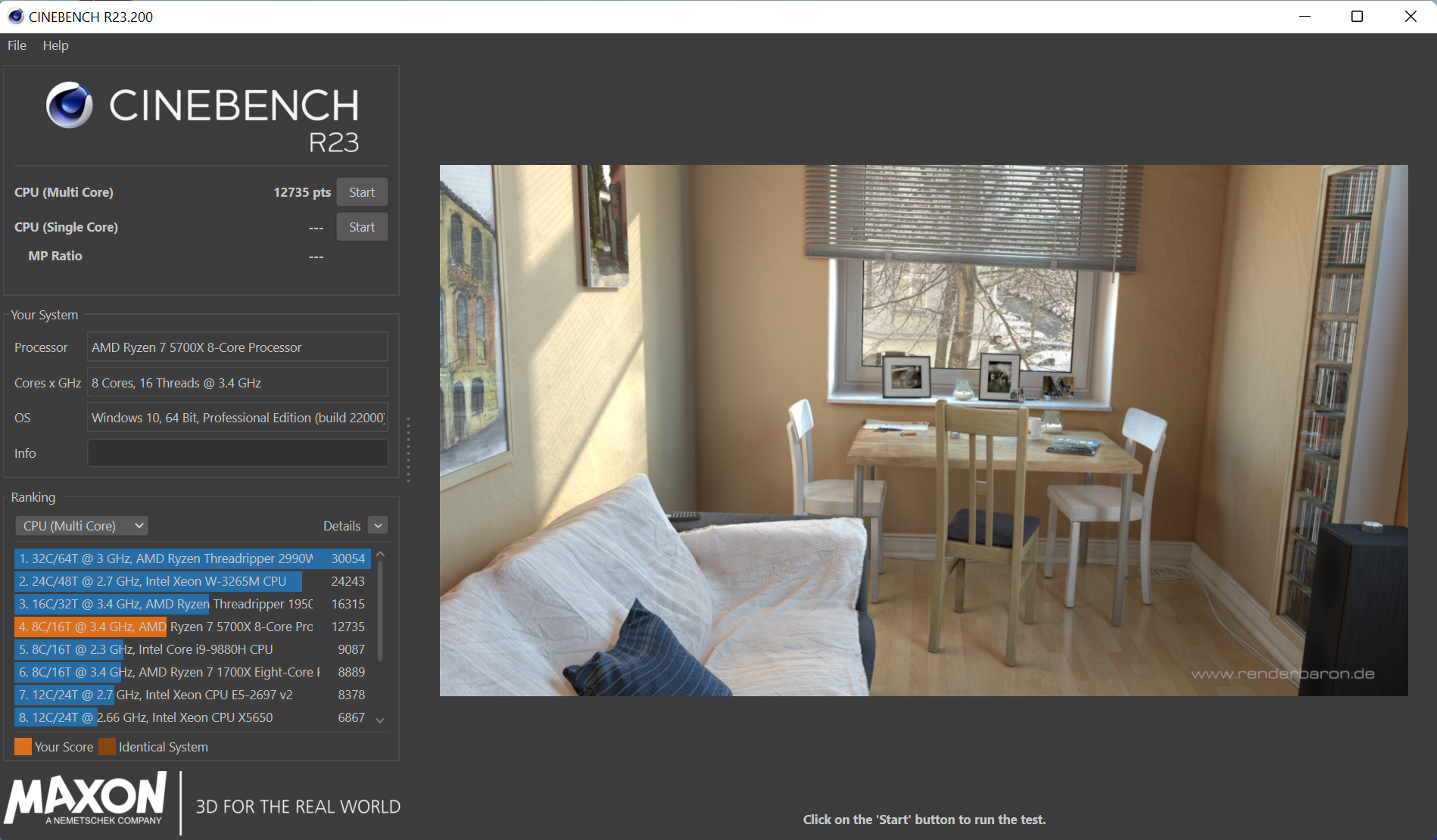

I've run Cinebench R23 and these are my results...
Do they look about right? The Threadripper 1950x 16c 32t scores 16315. I've searched google and results for both the 5700x and 1950x in Cinebench R23 are higher than what it says they are in Cinebench R23 itself.
I've got it sussed, Precision Boost Overdrive was set to AUTO in the BIOS. I enabled it instead and ran Cinebench R23, I got a higher score but the temps were at 95C whereas set to AUTO they get to about 80C which obviously means PBO was disabled. Also it only boosts to 3.8 GHz not 4.6 GHz under Cinebench workload with PBO set to AUTO.
This would explain why the 1950x gets a higher score in google searches than it does in Cinebench R23 itself. PBO was obviously not running when they ran Cinebench R23 on the 1950x that is included in the Cinebench R23 results.
So now I have a choice buy a better cooler which will allow me to boost to 4.6 GHz under Cinebench R23 workload or leave it set to AUTO which will allow it to boost to 4.6 GHz whenever the CPU is not being loaded 100% as per 3D Mark results.
PBO is technically overclocking from the base clock of 3.4 GHz anyway and there is no harm running with the Wraith Stealth Cooler temp wise with PBO set to AUTO. I just lose a bit of the overclocking under 100% CPU load, the temps are fine.
