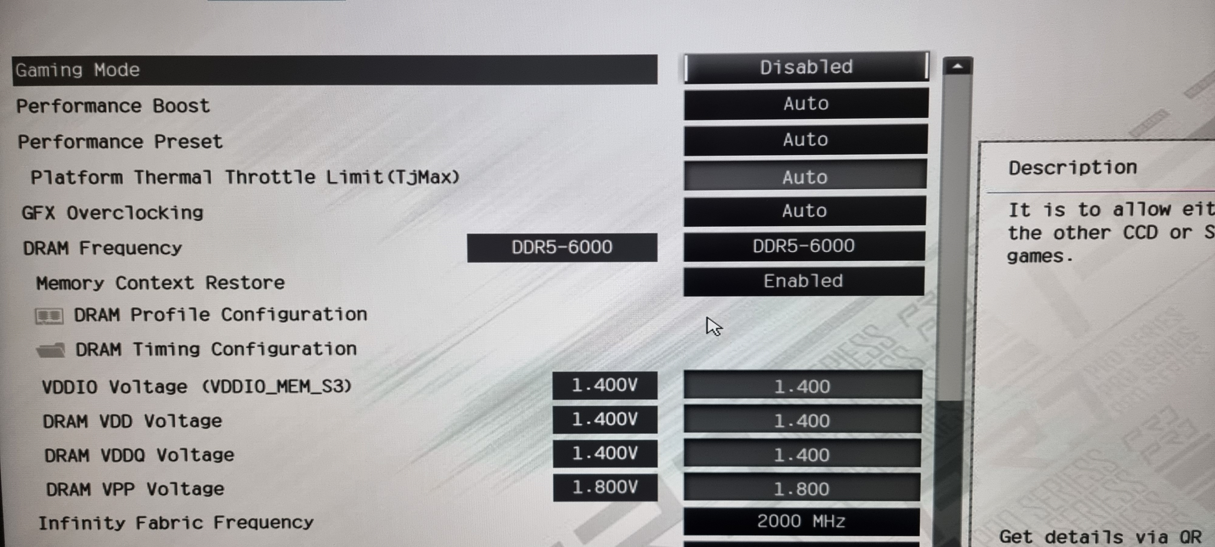

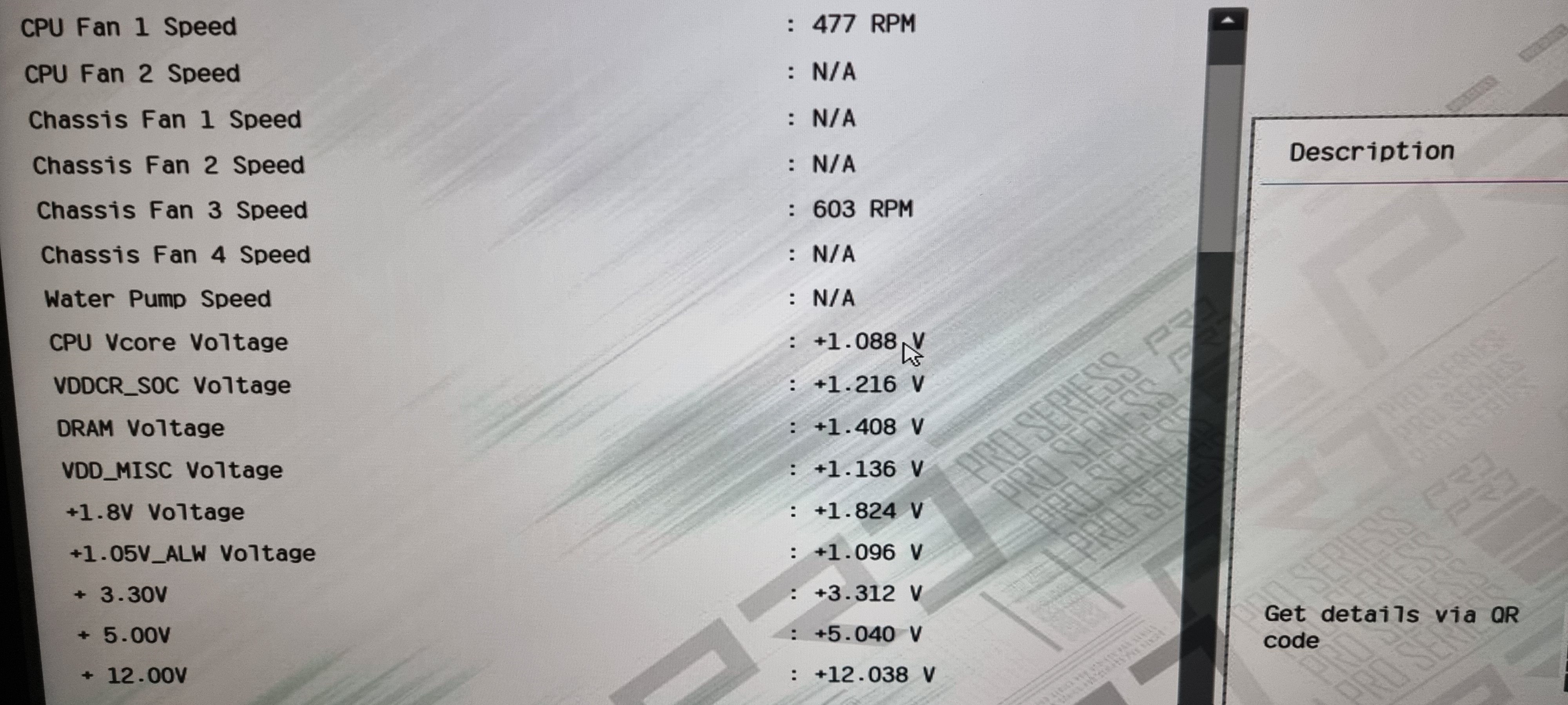

Expo is enabled although I've attached some photos of my bios to highlight the voltages that it's set. If someone more educated than I could provide guidance on if these numbers look correct, that would be amazing. I notice a few of the options are set to Auto and I'm not sure if they should be changed, although any recommendations would be much appreciated.
I do actually quite like this motherboard compared to the one I tested as a replacement back when this occurred the first time (ASUS PRIME X870-P WIFI). If it could be concluded that it's the board and not the CPU then I'd be happy to change it however, probably to another brand (as you suggested MSI or Gigabyte) entirely.
@Jerome thanks for the pics just looking at that it basically the same as mine although I don;t use ASrocks I use Asus predominantly. So I was at work tonight and I was pondering why your board has killed 2 9800x3d but works. Then it dawned on me but it can;t explain the other users getting dead CPu's Please bear with me it a bit long winded.
