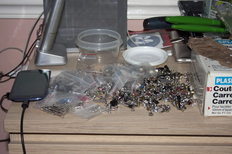

Although I can't get anything done, I have managed to sort this...
...into this.
Two of the most tedious hours I've ever spent but worth it as I'll now be able to find what I need a lot quicker than before. I've also discovered that my family will be self sufficient in PC component screws for several generations :D

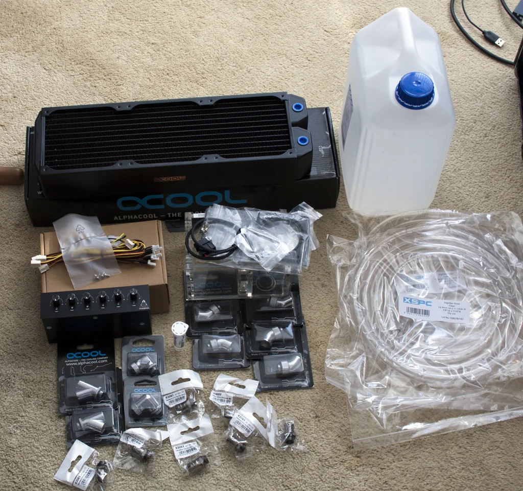

Not really an update as such but I got back from holiday today and the watercooling stuff has arrived while I was away (nice having a neighbour who'll take stuff in - thanks Mrs H).
Pretty much all I need to finish the build but, since I can't do anything now until I get back from work in a month, I'll order some new fans while I'm away. I've measured it up and I can just squeeze the radiator in with fans either side. Is there any real benefit in a push pull setup? Are the temps much different? I believe the 1450rpm Gentle Typhoons are the flavour of the month for radiator fans at the moment.
Push-pull does help, but not by a huge amount. It is all in %s and degrees. If you have room for it do it, if you don't it will be fine.

As I said, there should be just about enough room. I may as well do it. My limited research suggested what you say, that it makes a few degrees difference, but not essential.
