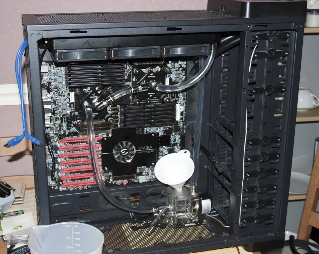

So, today I was expecting the new bits to come so I put it all together again and when the stuff came this afternoon, I got the loop set up just the way I wanted it. Plugged in the power and set about filling the loop. That was where I encountered the next problem. The loop wasn't filling properly. It was getting as far as the main motherboard block and not getting any further. "great", I thought, "a blockage". I switched off and took the whole thing apart again and dismantled the block but there was no sign of any obstruction :confused: I tried the block on it's own but nothing. It would pump as far as the first port and stop. I tried switching the inlet and outlet but got the same result. It refuses to pump through, even though there appears to be no reason why it shouldn't. I decided at that point to abandon the motherboard block and I've re-fitted the original.
I'll have to leave it for now since, not only can I feel the rage coming on but, when I switched the pump off originally, the back pressure caused water to shoot out of the open fill port of the res, splashing all over the motherboard. I'll have to let that dry out.

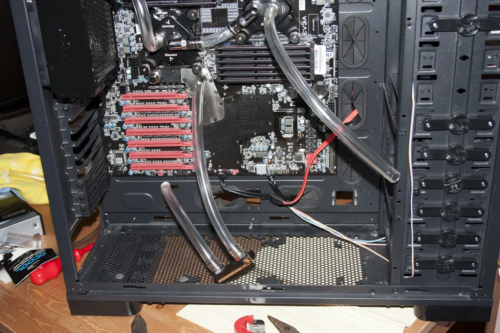

This is the rascally mosfet block - "it came off in me hand, honest guv" :o

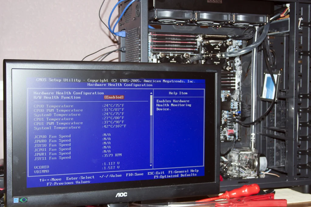

Then came the moment of truth. I was dreading switching it on after all the trials I've been through getting the damn thing built. I had visions of switching it on and nothing happening or loads of beeping. Anyway, I took the plunge and on she went. After what seemed an eternity of flashing and churning - SHE LIVES!!! :D

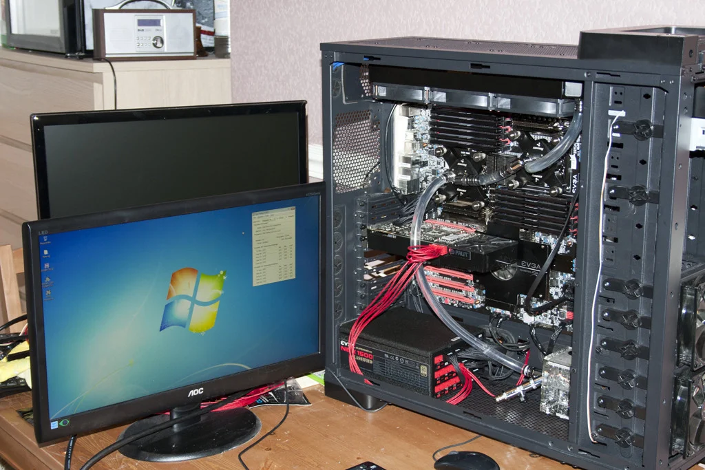

Had a bit of an issue installing Windows. The SSD showed up fine in the BIOS but, when I tried to install Windows, it couldn't find it. Did a bit of Googling and came across something that said Windows installation sometimes doesn't recognise a drive if it has a dodgy MBR so I followed the directions and opened a command prompt, started diskpart and did a clean of the drive. Hey presto, when I tried the installation again, there it was :cool:
Temps are pretty good. The lowest core at idle is 17C and the highest is 24C. Running prime it's between 34C and 40C should give me a bit of headroom for overclocking.
Now Windows is installed and monitoring programs and updates installed, it's time to start overclocking the CPUs and RAM. I'm just about to have dinner then I'll get cracking with that. I'll find the max OC and run Prime 95 overnight to test thoroughly and tomorrow, I'll install the GPUs, OC them and benchmark. After that I'll tackle the cabling. maybe then I can get my dining table back.

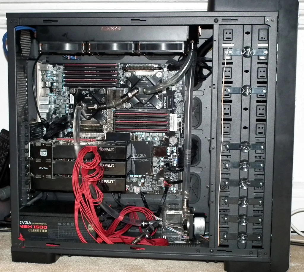

Anyway, here's a photo as she stands just now.
Plan for the future is to hopefully get it to run with 4 GPUs and to watercool them. I'm not sure if I'm going to upgrade anything now as I'm a bit fed up with it and really don't want to spend any more cash on it. I might just finish up the watercooling and call it a day. Thinking about re-doing the gaming rig. I quite fancy the Corsair Carbide 540 cube case. I might get a better motherboard and move everything over to that and get another 690 with block and make a watercooled quad sli gaming rig.

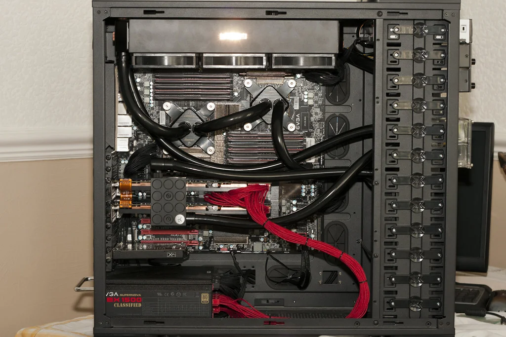

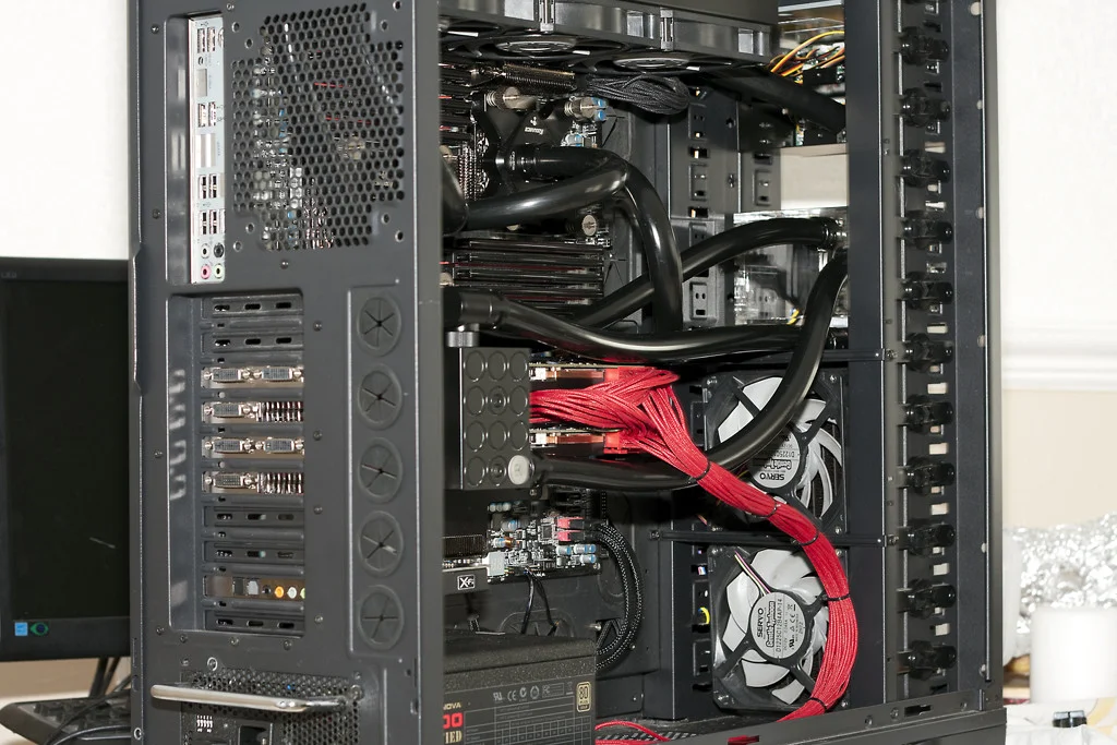

Side on - check out the neat GPU cabling :cool: Tubing is XSPC 13/19mm and fittings are all monsoon. The monsoon fittings look really good but are a bit of a pain; you need to tighten as many as you can before installing as it's really difficult getting into tight spots with the tightening tool.

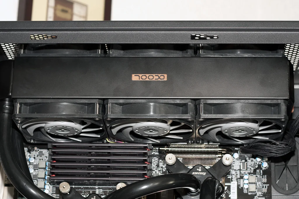

Top rad - Alphacool NexXxoS UT60 Full Copper 360mm with 1450 rpm Gentle Typhoons in push pull configuration. You can just about get a fag paper between the bottom fans and the RAM - I've tried it :p

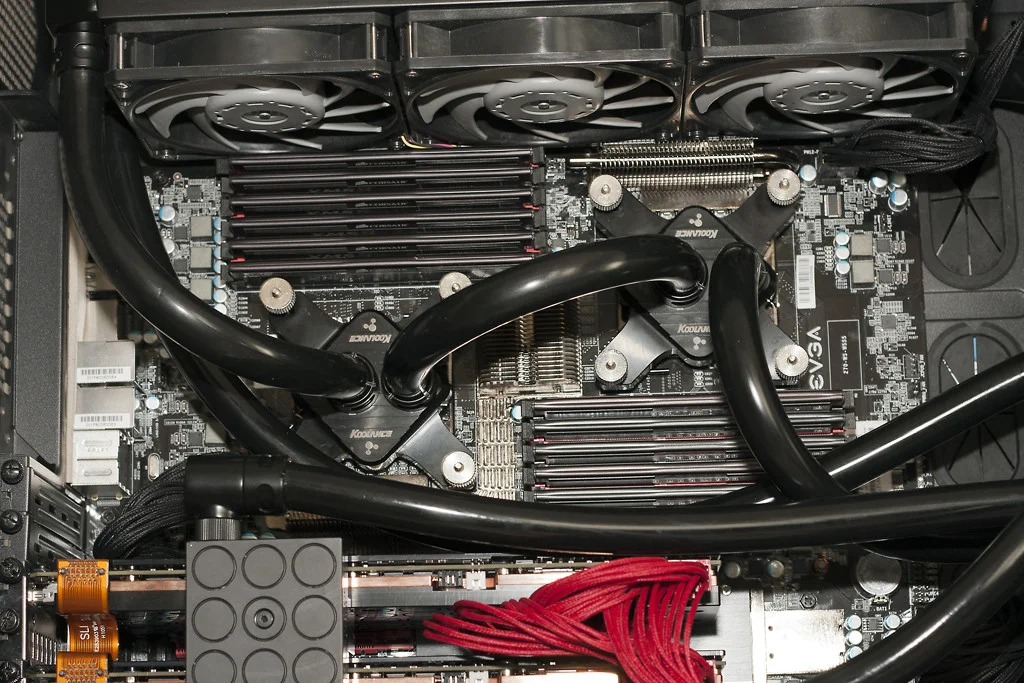

CPUs - 2X X5650 Xeons with Koolance waterblocks. Oc'd to 4.0GHz

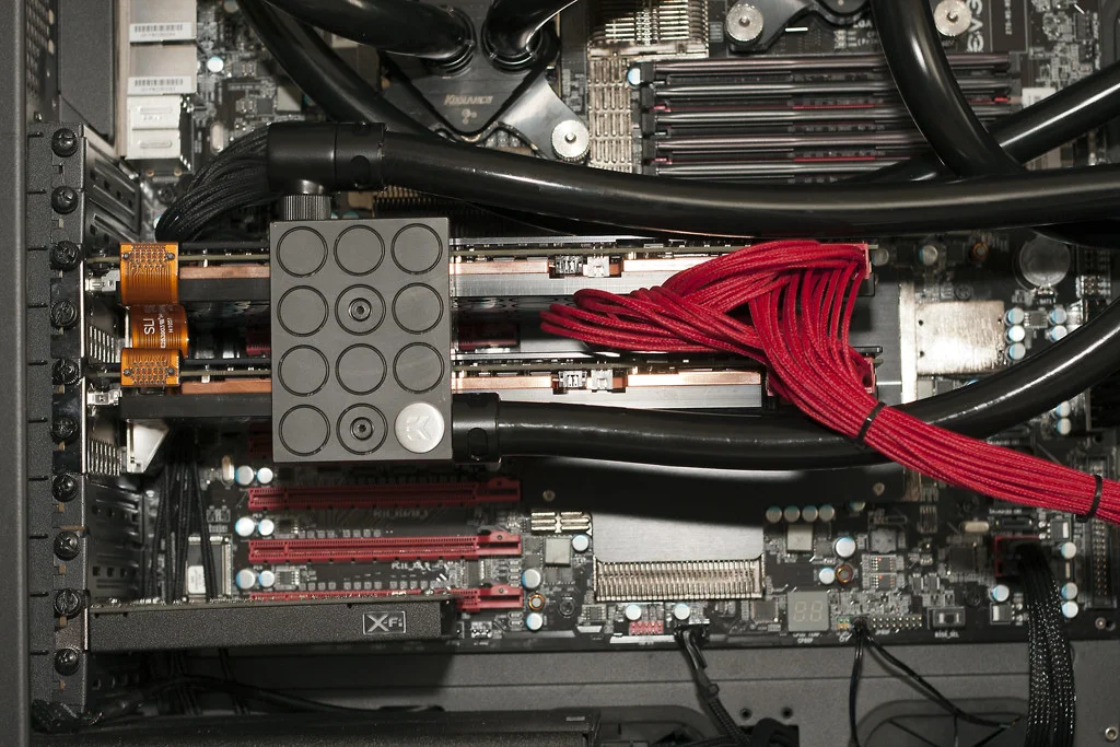

GPUs - 2X GTX 690s in quad SLI with EK waterblocks. Paltry OC of 957 (1084) gpu and 6480 mem.

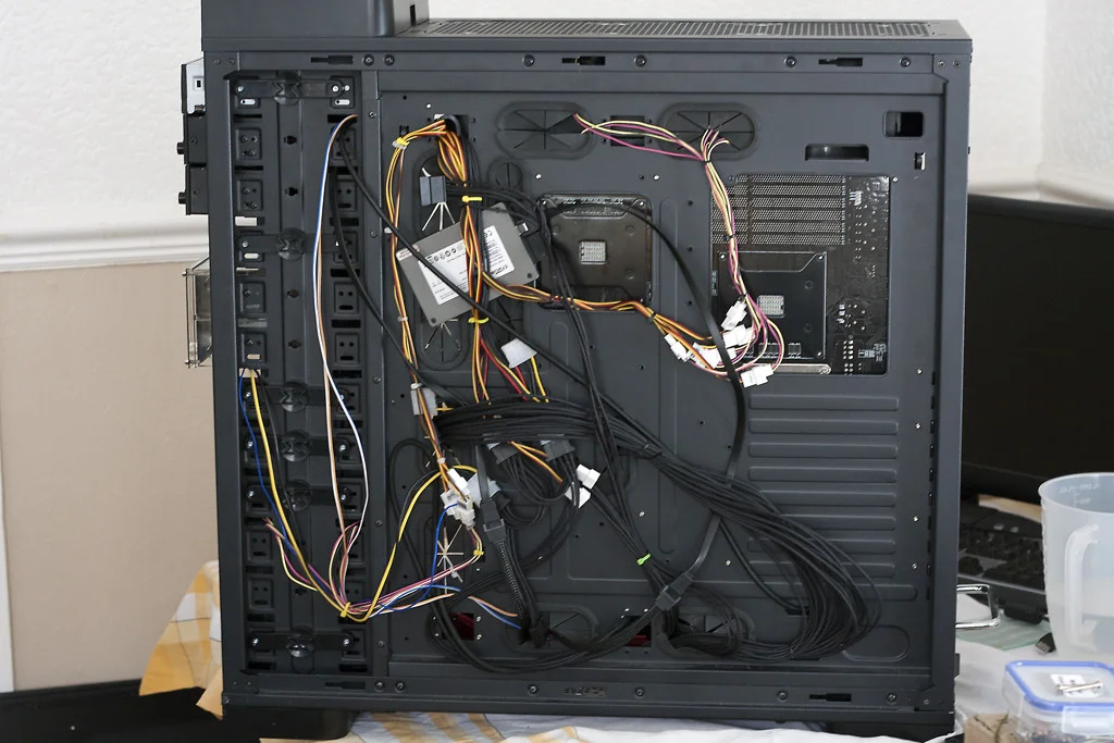

Cabling at the back - about as neat as I can make it.
Front on. 2X Akasa fan controllers, cheapo DVD-RW and XSPC bay-res/pump combo with a D5 pump. Also showing front view of 240 rad. Leaving the front cover off for now so I can top up the res. Experience has shown me that the water level takes a few days to drop to its final level and the front panel is a pig to get off.

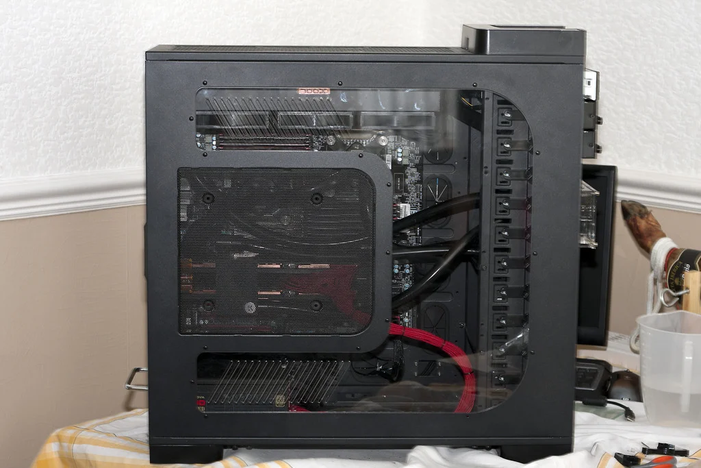

With the side panel on. I hate the side panel, it's fugly. Might consider modding it in the future.
