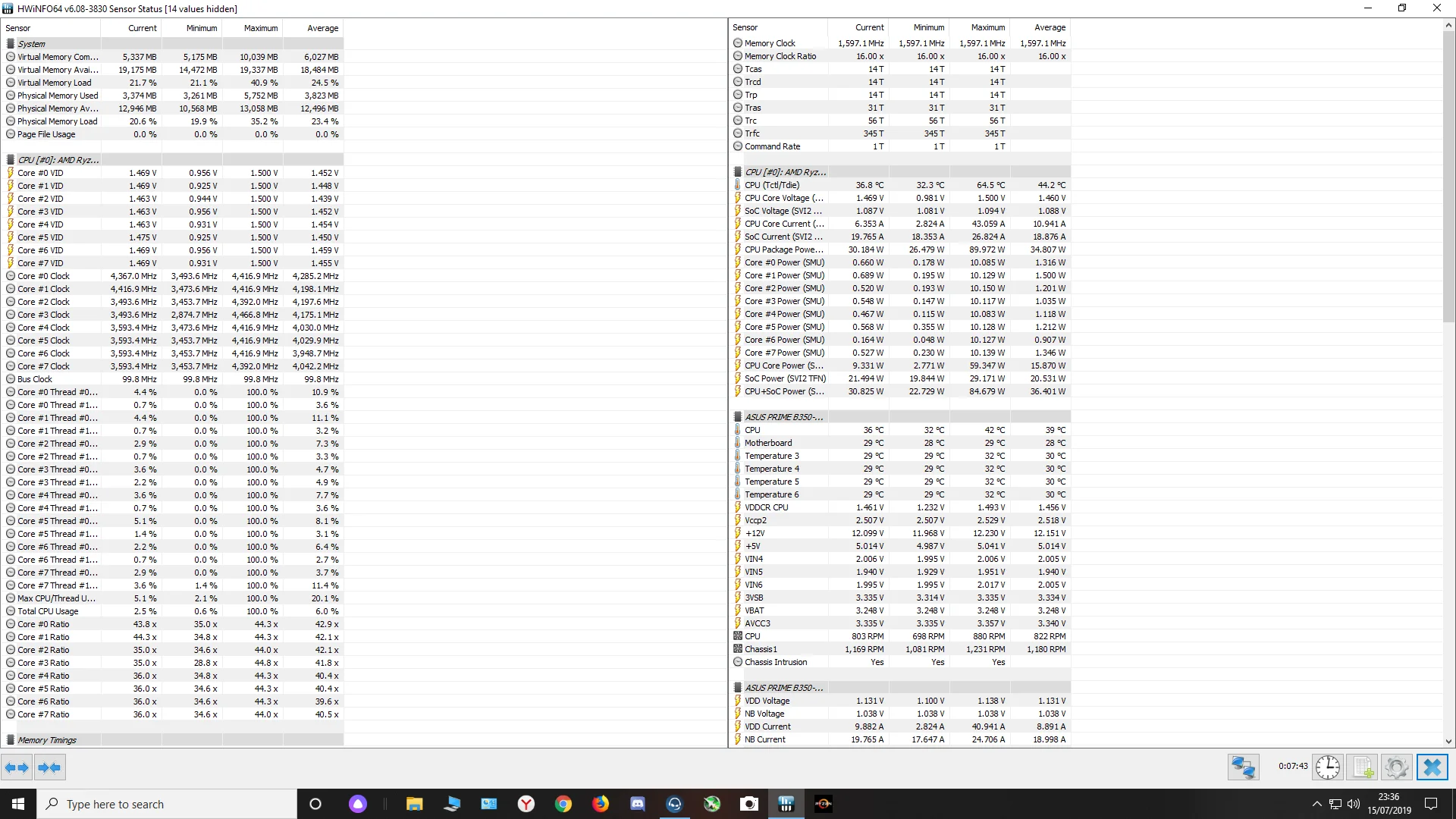

4150mhz - 4200mhz @ 3466... if I change to 3600 or higher it boosts to 4050 on cinebench. I need to reseat my cooler and get some better paste as my temps get a little toasty for my liking.
Have you manually set your voltages or are they on auto / normal?
What are you using to test / monitor max core clock? HW monitor seems to mess with core frequency's and watching in ryzen master is hit and miss. Will experiment with CPU settings more tonight.
On my x570 IF seems to be happy running at 1800 so ram speeds and latency are good:
Just HWMonitor, so I check min/max/avg, I can't think in another software to do this readings. Well, you are on x570, its a completely different scenario in terms of fclk/mclk :P
Is it? I just went straight in at 1.4v after seeing PBO running it at 1.45+, I even tried my luck with 4.4Ghz at 1.475v.
Been working the voltage down to see how low it keeps stable, next stop 1.35.
Will be interesting to see if 3200 vs 3600 ram helps with the boost and how the benchmarks compare.
