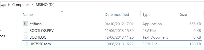

8. If you've done everything correctly your usb stick folder contents should look like this. (except the bios should say Matt.rom instead of HIS7950.rom) Do not worry if you have more or less files than what appears in the screenshot. As long as you have the bios file and atiflash thats all that matters. Windows 8 users might have extra files like in my screenshot.
If you look to have a file or two missing it could be because you don't have show hidden files ticked in control panel, folders.

I am trying to get the usb stick set up.
I have tried it twice so car and the only files on the stick are
atiflash
old rom
new rom
there is nothing about the BOOTLOG? I have it set to show hidden files.
where am i going wrong?
