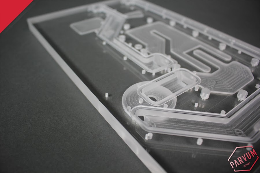

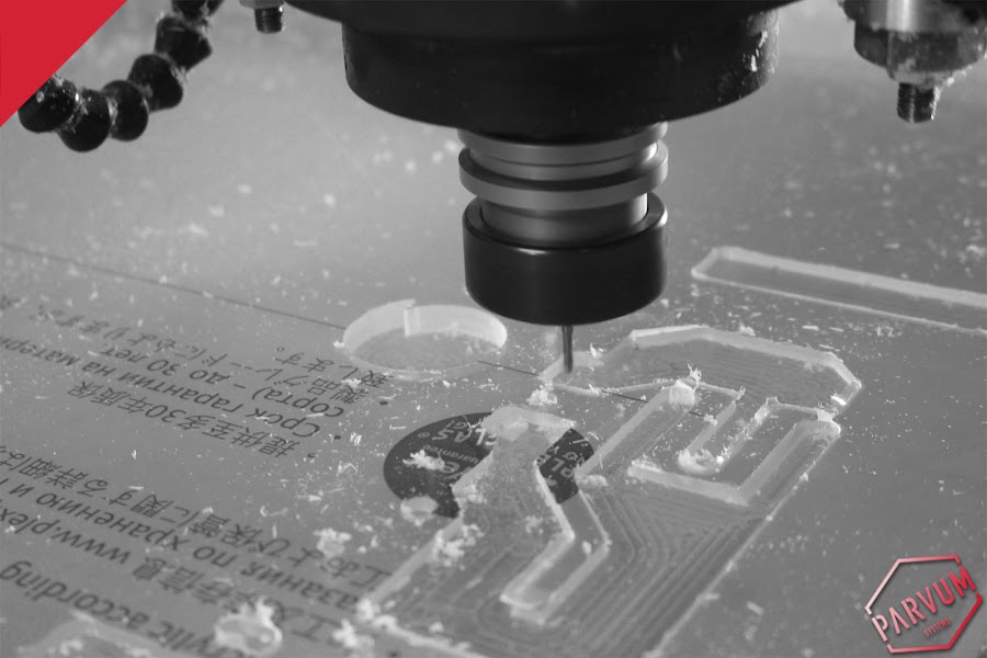

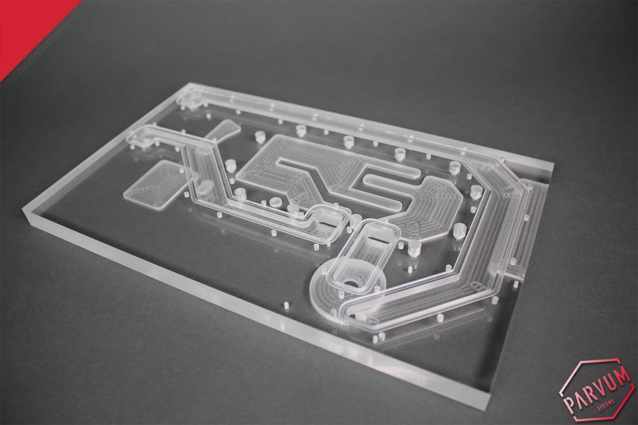

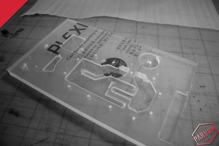

Now I should say at this point my natural tendency to be restrained and conservative pretty much ends as me and imersa spiraled into full outrageous acrylic pr0n. To turn that into a reality much delicate measuring and CAD were needed...
I'll just leave that here. Me and Imersa are insanely hyped to see some acrylic meet its fate.

In order to make our mono-block design as clean as possible and to actually fit it neatly inside the case, while at the same time making room for the 240mm radiator a little modification was in order.

Apologies the update got delayed, I rather hastily left for Parvum HQ and didn't upload the pictures, but on the plus side we got all of the drawings finalized for cutting the test block AND we haz pizza.
